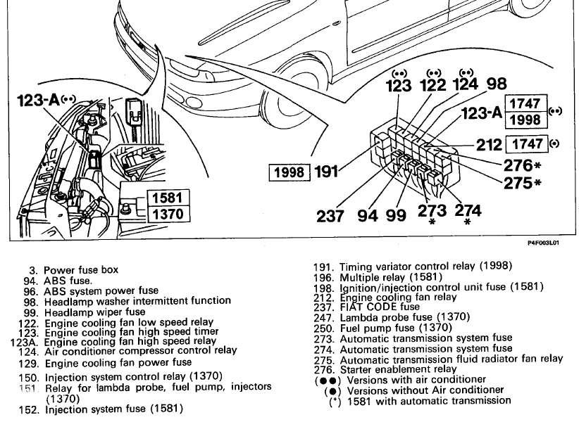

Just before this happened I had a funny clicking noise coming from the fuse box in front of the battery, but looking over the Manuel there don't seem to be anything in there that would affect this. Just stuff like cooling fan relay etc.

Tried taking off the wires that go to the idle speed controller and the revs hit the roof. So I went back to what was ticking before the problem started ( The little black box in front of the battery ).
I took out all the relays and fuses one by one and cleaned each spade with maintenance, a cloth and a screwdriver. After doing so, I started her up and hey presto the revs are sitting at 850 on idle. The next test will be when she is cold.
Which is really weird as I cannot see anything to do with idling in the manual

technically, that isnt possible :confused:
