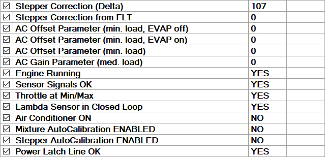

I took pics of the readings in case anyone can see anything obvious. please see attached. still no error codes
The obvious difference is that in my Spi Seicento sporting, IAWscan2 shows both Mixture AutoCalibration ENABLED and Stepper AutoCalibration ENABLED are YES. If I remember correctly, you can toggle both On or Off in the IAWscan parameter tab. To give further information, I have also an 899 cc Cinquecento that I can't toggle Stepper AutoCalibration ENABLED to YES and that Cinquecento has a problem with the rpm dropping when it is up to temperature (but in my case it doesn't happen when idling and the Lambda reading drops also)
Interesting. I will try and toggle these on whilst running and see if that helps.
I did try setting these to on before, but didn't check to see if it actually did anything on those parameter screens I posted up, I will take a look.

You can toggle them to showing YES in the Adjustments tab (at least that is the case in my Seicento 16F Spi ECU) Do it one by one without starting the engine. Connect to IAWScan but don't start the engine. Check in the Parameters tab that Mixture AutoCalibration and Stepper AutoCalibration are indeed showing NO. If so go to the Adjustments tab and choose Toggle fuel trim autocalibration and then hit execute. It should show Passed (if i remember correctly) as result. Go to the Parameters tab and check if anything changed. If it has changed to YES, Disconnect and repeat the procedure for the idle stepper autocalibration. Both adjustments also reset the values so prepare for the ECU to relearn. Drive it normally for some time.

Reset the mixture and idle and this bought on the 'yes' enabled messages on the parameter screen.
