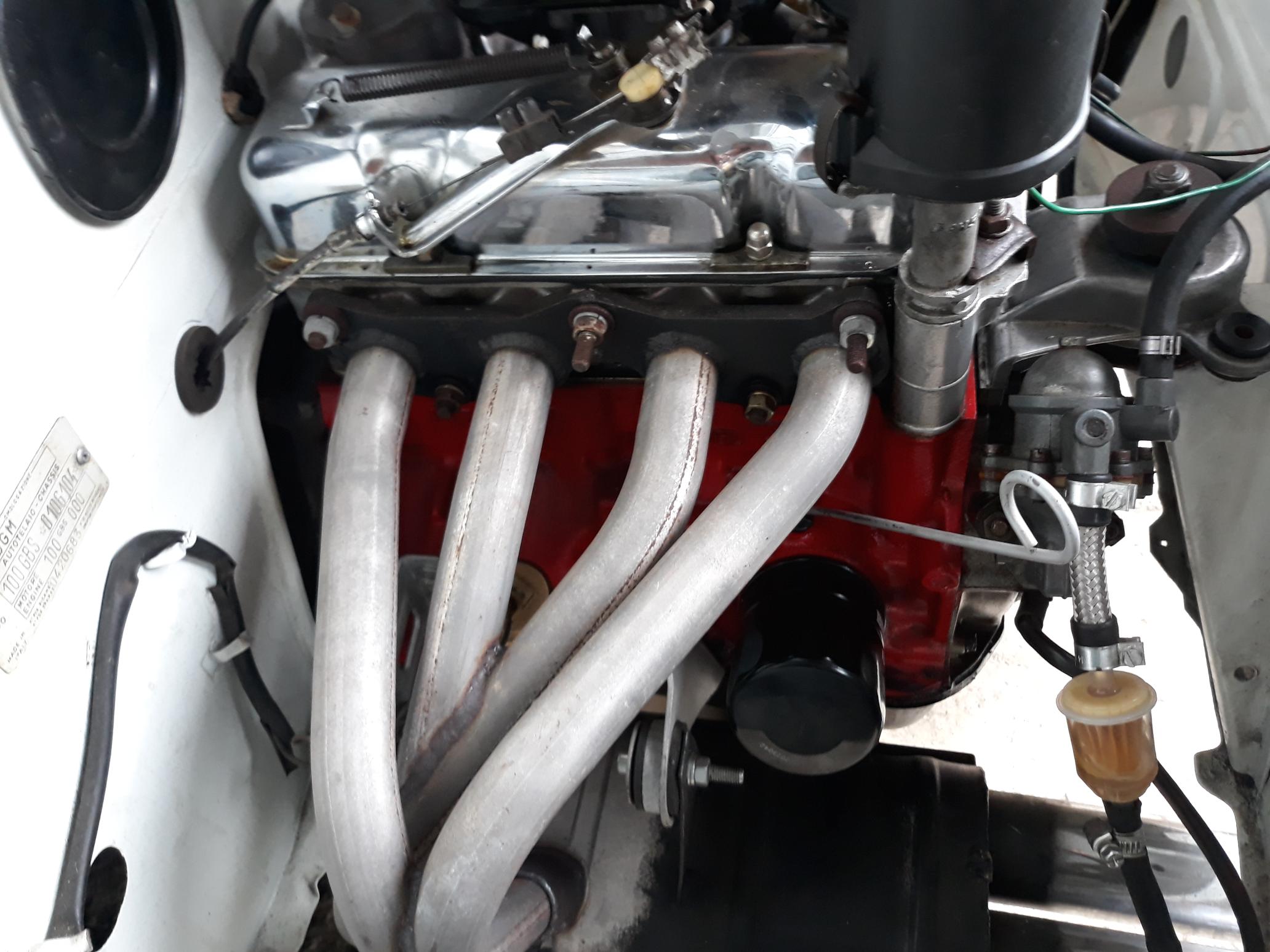

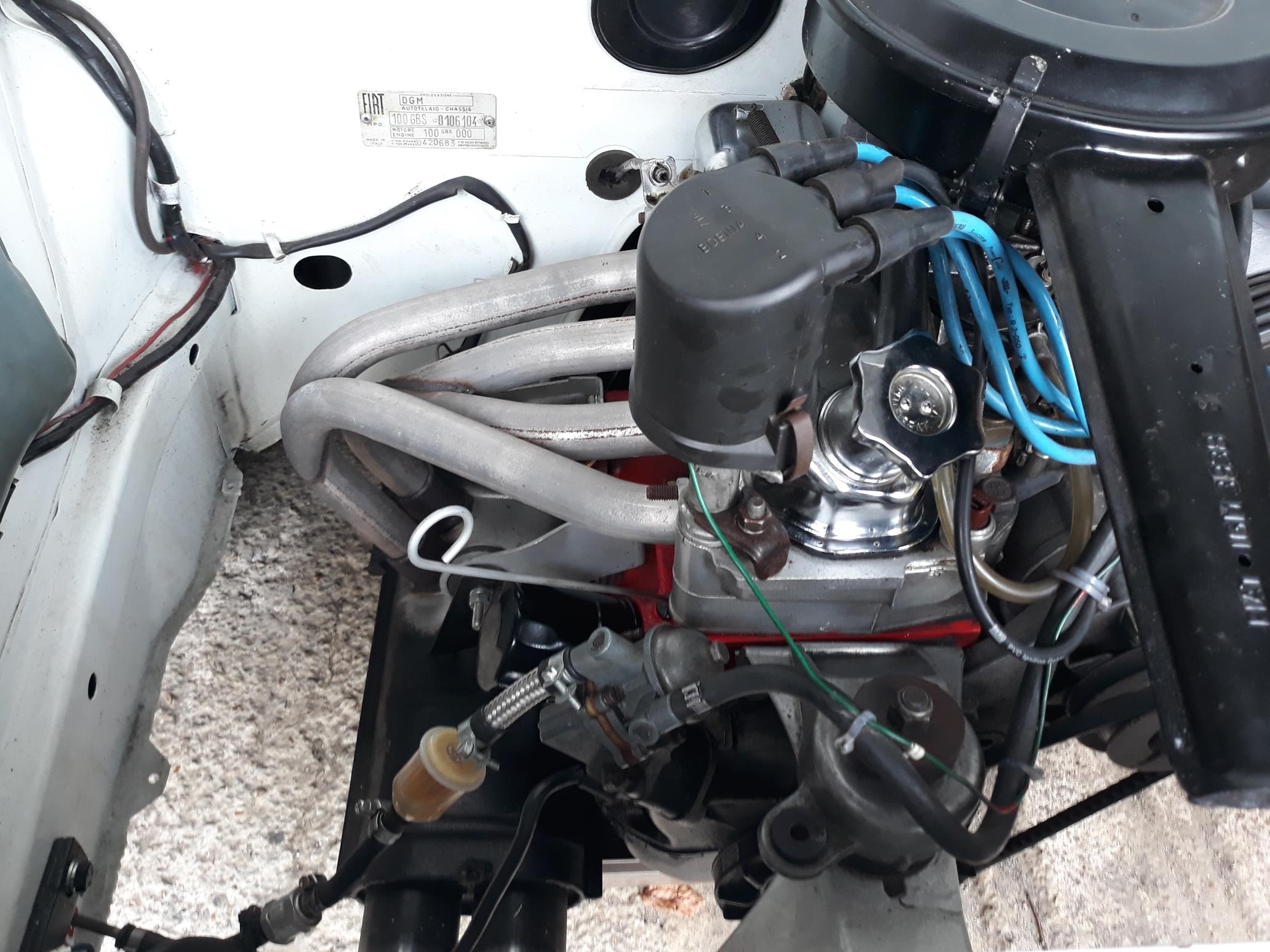

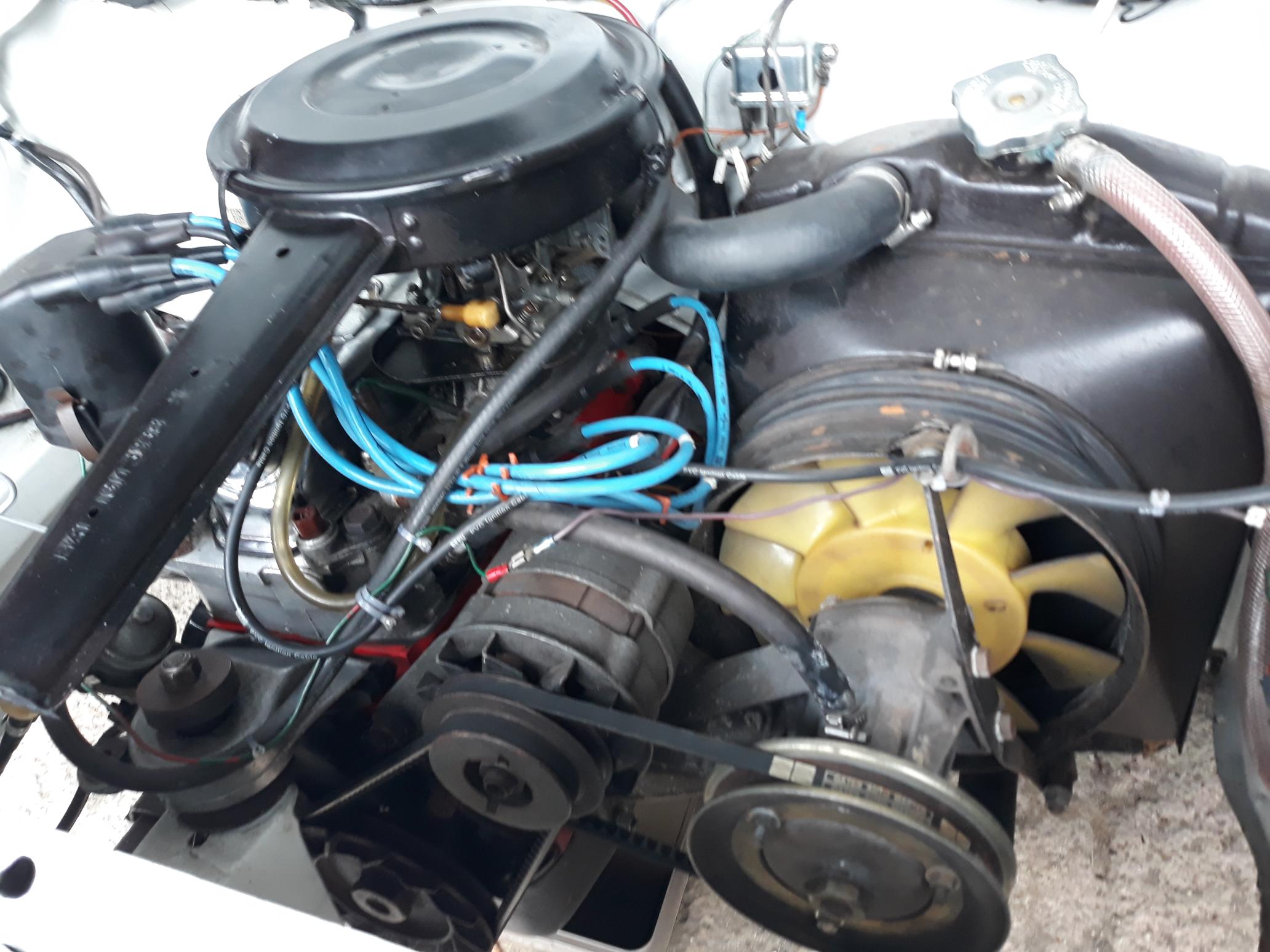

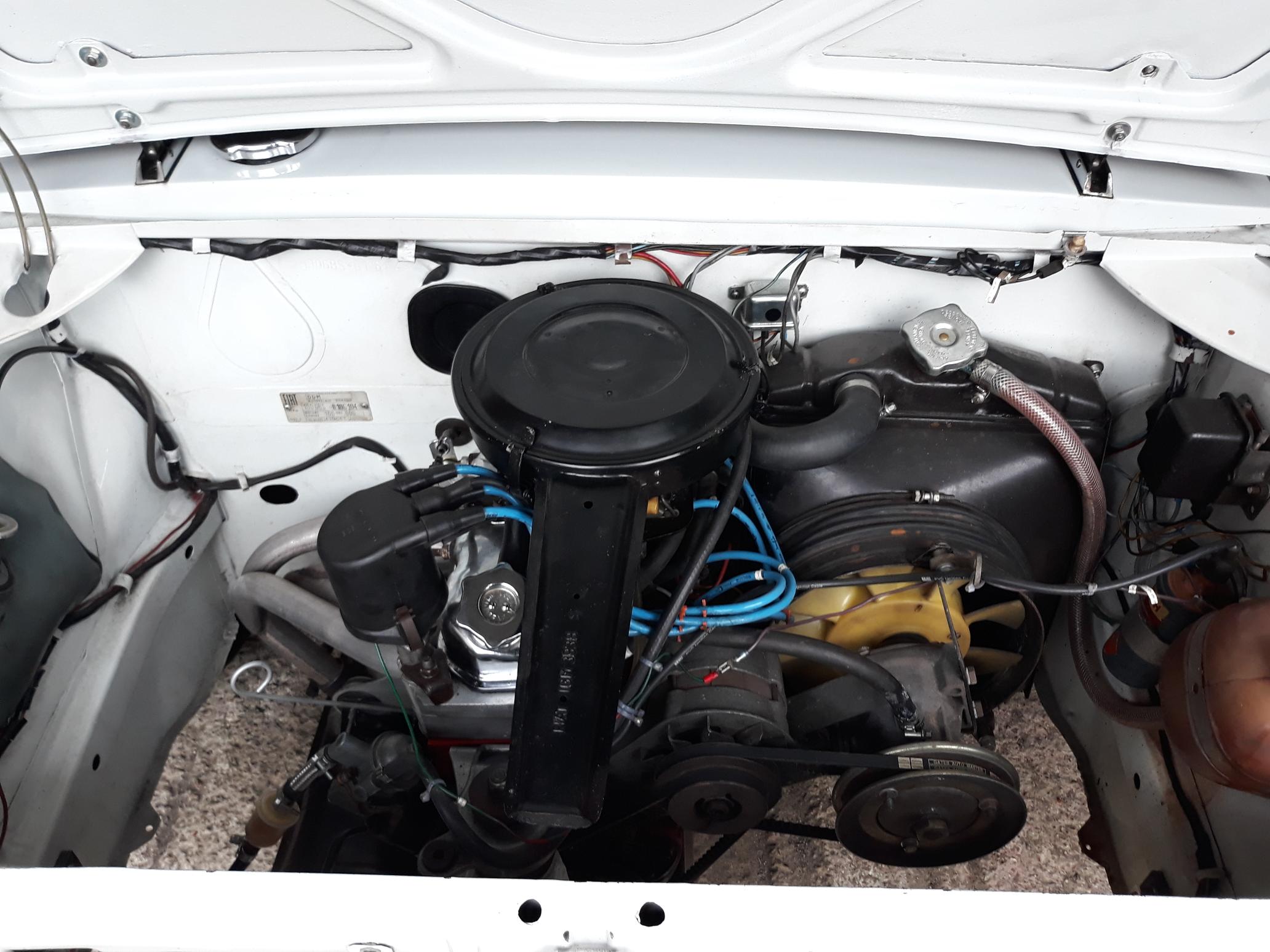

Hello Tim,
It’s a 1971 Fiat 850 Sport Spider. Imported from Belgium in 2019 and then restored.Some pictures attached in case that helps. I guess lots has changed over 50 years… Thanks for looking, Warren.

Yes I spotted this spider for sale a while back.
The engine is likely 903cc but to reverse the rotation for this application would need a camshaft from an 850 and the oil pump drive gear to be changed. The oil system is stronger this way. Difficult to tell whats inside due to it being rebuilt but should be somewhere between 45 and 52hp.
