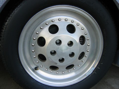

very nice rims.....look a little like the ones I fitted on my Cal-look beetle back in the day - Speedlines I think they were called.....:)
Nahh - centrelines.......the old brainbox is showing its age....
The Alloys are nice, just would have to get the adapter plate to use with that bolt pattern.
