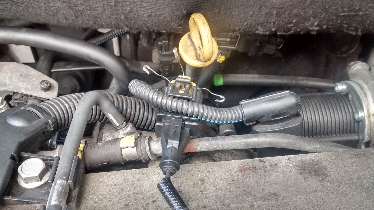

Before you go about changing your cam sensor, here is a guide to testing the sensor. Only figured this out after I had changed mine. The sensor is behind the cam pulley. Follow the wire from the front of the cam cover, over the top, along to the back and you will find the connector in a plastic clamp at the back of the engine.
There are three connections:- 1)Left-5V supply to the sensor. 2)Middle - 5V pulse returning from the sensor. 3)Right-ground or 0V.
I found that putting pins into the back to connect to the wires worked best. You can also use paper clips but some are plastic coated. Make sure you don't short any of these to ground or it could lead to more trouble!!!!
With the ignition on, first make sure that you are getting 5V between the left connector and ground. If not, then you could have a different issue.
