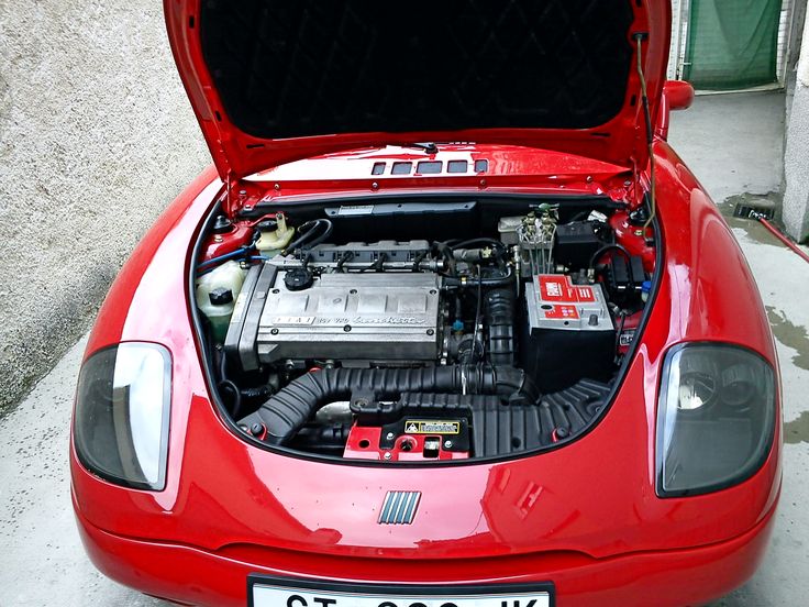

You should be able to tell by looking in the engine bay if there is an ABS control unit (back right of the engine bay as you look from the front of the car, sorry I don't have a picture to hand.

Red B, back left with ABS piping coming out
Silver B, with out. brake flued container directly above/in front of master cylinder.
