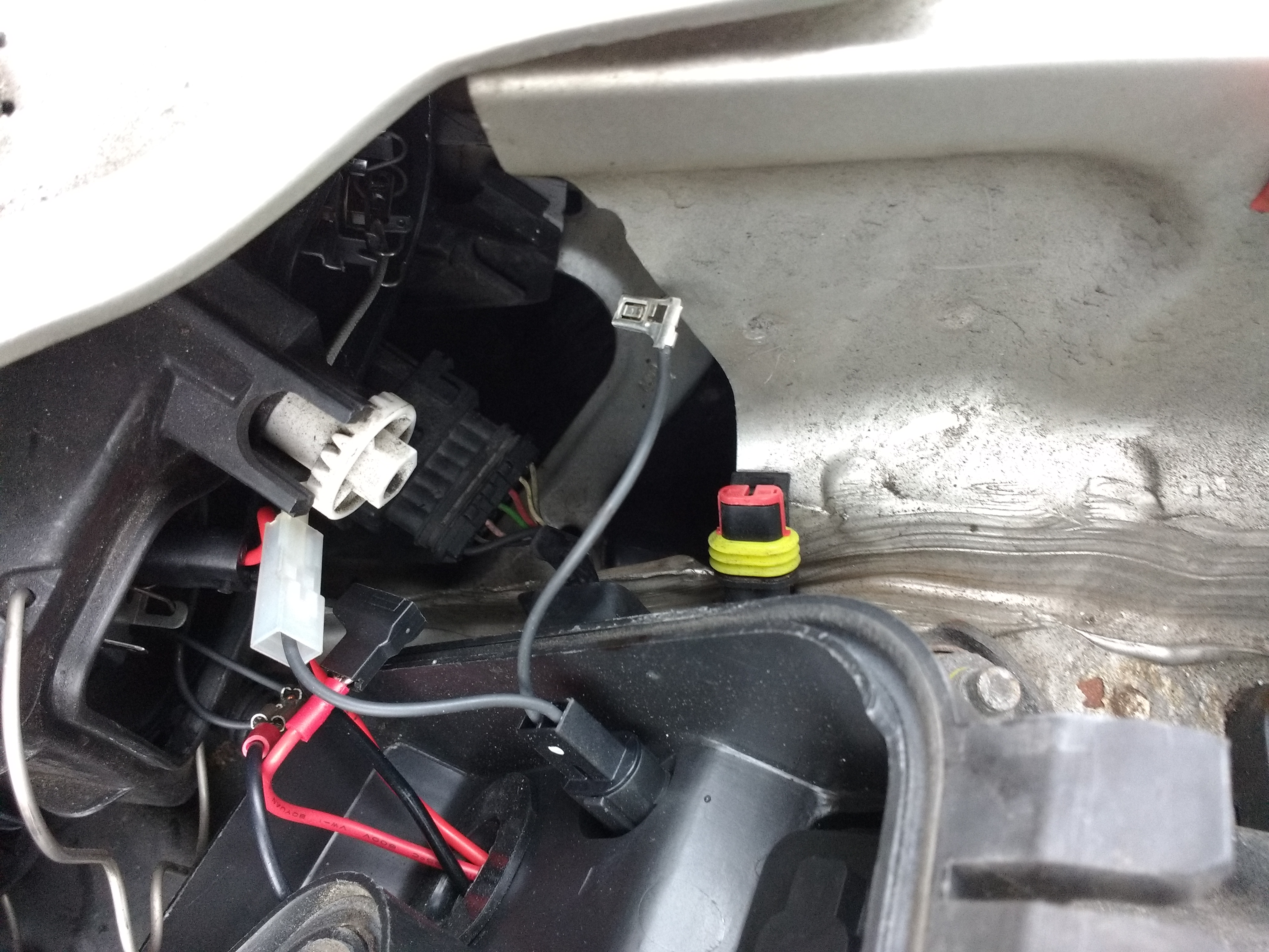

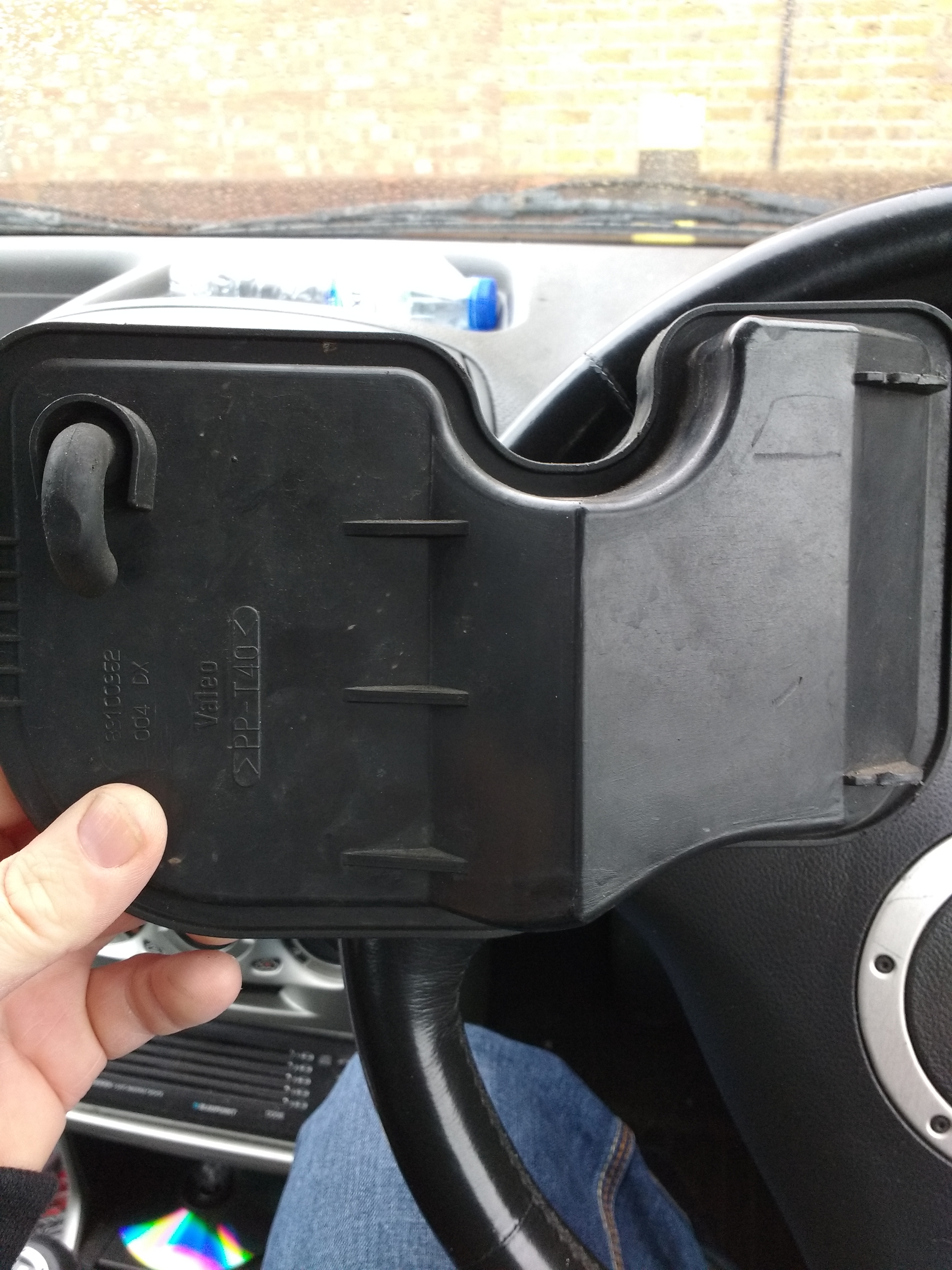

My drivers side cover is the same shape, but only has the rubber bit hanging out. No plug?
Hopefully this shows a photo?

I've got hids fitted and drivers side light now doesn't work this I think connects to the bulb too
