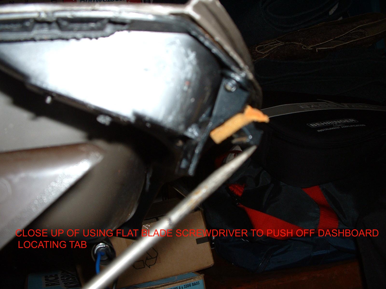

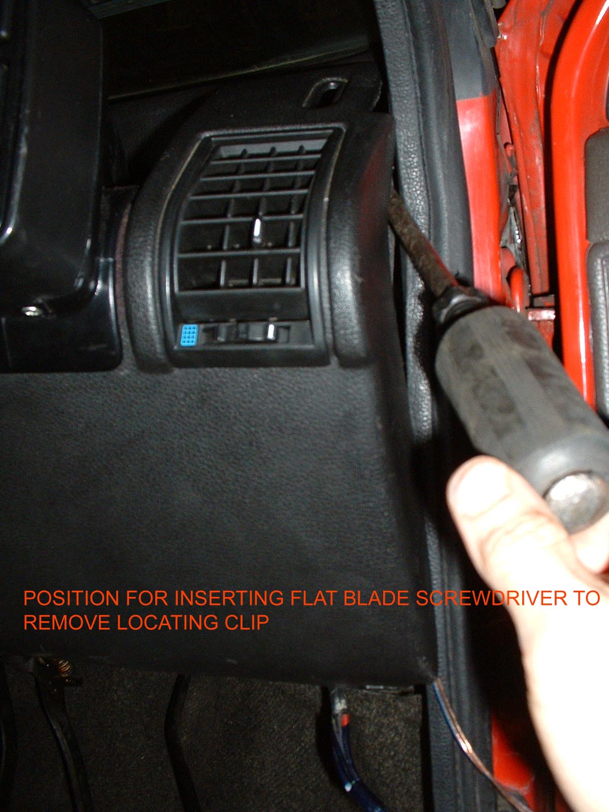

The way I found was to do the following. You will need a LONG flat blade screwdriver and a torch. Pull up the corner of the dashboard and look towards the back/ top using a torch. You will see the plastic dashboard lug pushed into a metal clip connected to windscreen scuttle panel. It's quite hard to see, so make sure you can confirm the location before going any further.
You then have to try and get the screwdriver blade past the side of the dashboard and under the locating lug, but also in the metal clip that holds it to the scuttle panel. It takes a few goes to get it right as it is very fiddly, but when you do get it simply twist the screwdriver and it should pop the lug out. Do the same for the other side, and you should then be able to lift the dashboard out of the car. The choke cable will pull through the bulkhead/ firewall as you do this as it's easier to refit it that way.
Attached are a few pictures to show roughly what to look for.
I think I've covered everything, but if doing this please check the manual first to make sure all screws and parts have been removed.

Alex, the two dashboard hooks/ lugs should just push into place. They go into a kind of 'v' shaped metal clip that fits into the hole of the locating bracket on the windscreen scuttle. The idea is that they are easy to assemble (just push down and they should 'click' into place), but they are not so easy to remove as you and I both know!
If yours won't go in, then it sounds like the 'v' shaped clip might have become distorted. They do have a habit of bending when you force the hooks/ lugs out of them to remove the dashboard.
