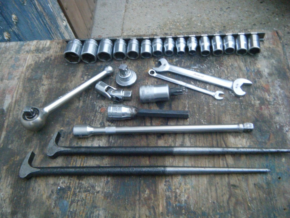

Tools required
All nut and bolt sizes are given in inches, the EC contributes nothing but they copy everything the Anglo-Saxons do, hence their metric nuts and bolts fit our imperial tools. The best tools to work with are 3/8" square drive sockets with single hexagon flank drive, I own few metric tools and work mainly with AF and BSW sizes most of which are a good fit. A few nuts and bolts will be tight enough to justify 1/2" square drive sockets or long ring keys. No extractors are needed although a few specialised items will help, such as my short toothless ratchet, SnapOn taper heelbars and ratcheting open end 1/2" flat key.
The tools shown below are NOT necessary!
You will need a few open end spanners, ring keys and socket sizes 1/4" 5/16" 7/16" 1/2" 5/8" 11/16" 3/4" 7/8" 15/16" AF. 1/2" AF is a bit tight on some 13mm nuts but with old worn tools I get by, torx plug socket T55, hex plug 3/8" AF welded into an old socket, taper heelbars, philips screwdriver, flat screwdriver, heavy lump hammer, long tyre lever, 2 axle stands, heavy trolley jack, light trolley jack, small ratchet block, 9" of light chain. Your jack and axle stands need to be in the 2-ton range to be safe. My heavy jack is a 50 year old Epco 4-ton and the 2 tall stands are 30cwt each.
If a compressor is available blow the entire unit clean before you start, and dislodge accumulated muck as you work. It will help to keep the floor and your overalls clean as you lay underneath. My cheap 2hp Chinese compressor has done this duty for over 10 years now and is the best 60 euros I ever spent.

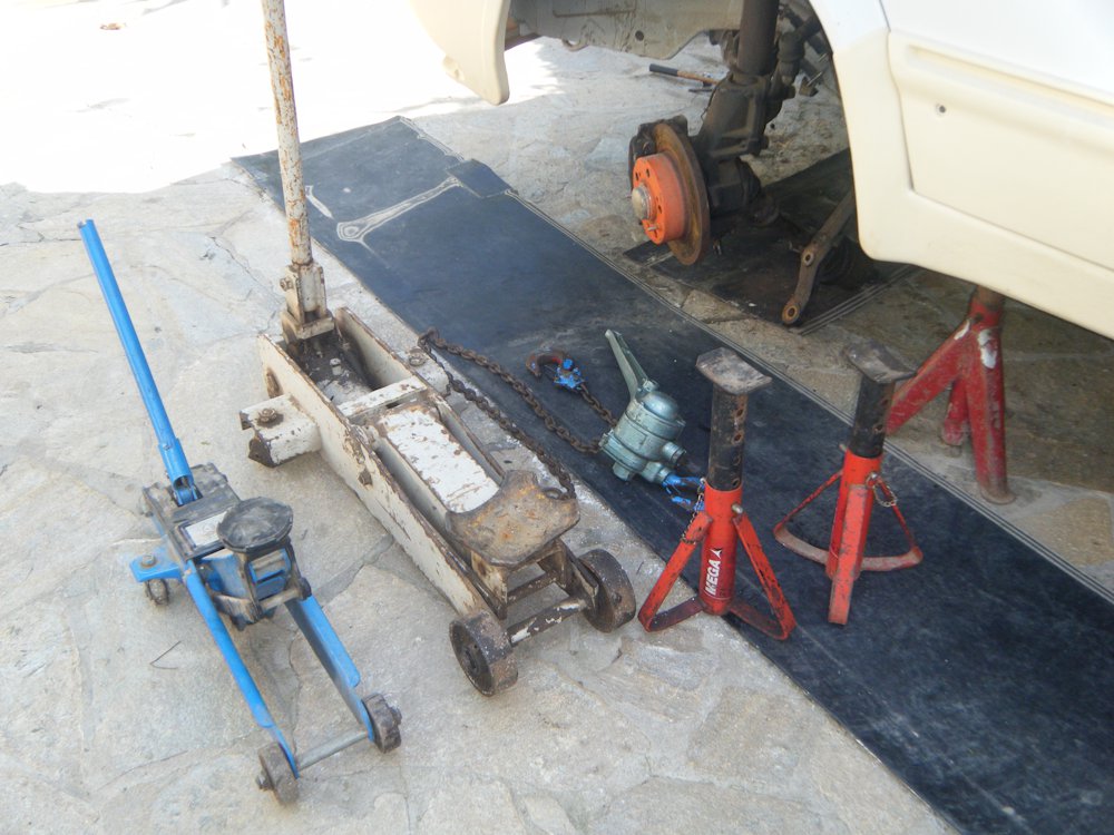

Place the vehicle on a level smooth hard surface, with plenty of working room to the front and left hand side. Working outside will give much more light. Access to the right hand side is not needed. Slacken the left hand road wheel bolts. Chock the back wheels and pull the handbrake firmly on.
Disconnect the red battery positive terminal [5/16" AF nut] and move it to one side. Jack up the front underneath the forward track control arm anchor plates, high enough to place good axle stands under the official jacking points part way down the chassis legs. These points are far enough to the rear to give working room where you need it. You cannot easily do this job if you are surrounded by axle stands in the working area beneath and behind the power unit. The vehicle MUST be very firmly supported with no possibility of rocking off the stands when you are working underneath. A very large trolley jack under the middle chassis cross-member would be a good insurance policy.
It's an advantage if the hard floor under the power unit can be covered with some material that will keep you clean of grit and dirt, and to help the heavy gearbox to be freely slid around. I used some old smooth sheet rubber belt from concrete plant conveyors. This can be swept, mopped or wiped clean whenever contaminated with oil, grease or road muck. Sliding yourself underneath and back out again is much easier with this rubber.

Using a small trolley jack with a protective rubber pad in the crutch, gently take the weight of the engine under the oil pan at the flywheel end to avoid bulging the sheet metal upwards. Using a larger trolley jack take the weight of the gearbox under the clutch release lever and crown wheel casing area, avoid bending the clutch release lever.
Working underneath remove the 2 bolts [11/16" AF] securing the crown wheel casing to the rear gearbox mounting. Slacken the large rubber mount bolt [7/8" AF] and swing the mount downwards and back out of the way.
Attach a short loop of thin chain to one of the three gear selector unit mounting holes, using a long enough 8mm setscrew and a flat washer. Place a length of rebar across the gap between the spare wheel recess and the front panel, resting on wood pads to protect the paint. Hook a small chain block or ratchet block over the rebar beside the brake master cylinder, and hook the chain through the loop, taking up the slack, and lay the spare chain out of the way.
It will be possible to do this job without the chain block, but for somebody working alone it has the advantage that the gearbox unit can hang from above and swing freely without support beneath, which would not be possible with all its weight resting on a trolley jack. This enables you to work alone, eases parting it from the engine, and facilitates correct alignment and during refitting.
Working underneath at the left hand, slacken the 4 right-hand gearbox mount long bolts and nuts [11/16" AF] but do not remove them yet. 2 of these bolts will not slide out due to proximity to the inner wing. Working from above, remove the 4 short gearbox rubber mount to gearbox mount bolts [11/16" AF]. Watch out for a surprise engine/gearbox unit movement as the weight comes onto the trolley jacks and the chain block.
Lower both jacks a bit so you can control height with the chain block. Lower down the entire unit until the 4 gearbox mount long bolts can be removed, and lift off the mount unit exposing the gearbox casing flange. Lower the unit down until there is clearance between the lower edge of the inner wing and the gearbox end flange. Now you have room to part the gearbox from the engine.
