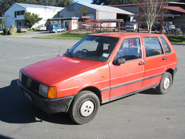

The back two doors I've fitted to my Uno are actually a different red in the first place - they are 140 Rosso Corsa whereas my car is 854 Rosso (described as Rosso Chiera in paint book: cherry red?) The strange thing is that the match is close enough to look like a poor respray match, even though they are actually deliberately a different colour! And the other ironic thing is that the original rear doors didn't match the front doors anyway, as you can see in the attached pic.
When I got the Uno it was brown-orange, so the original paint polished up to a totally different colour. I had some new paint matched to this colour - and it really does match. The bottom of the front door, the bottom of the rear door, and the rear wheelarch have been sprayed with this new paint... can you tell? :)
My problem now is the brown-orange bonnet that somebody painted with a colour they had matched to the non-polished paint! So, I wanted no-one here to make that mistake :)
-Alex

EZ Alex,
Jobs a good’en. I can’t tell from your picture – Is the re-spray on the passenger - er right hand side (UK driver’s)?
Thanks for straightening up the colour match thingy lol.
Regards all – Louie Bee.
Re: dent (small) on bonnet how to remove?
Louie (we meet again, I reckon we run this place ;))
The shot of the left side of the car (the left pic) is the passenger's side (we drive from the right just like in the UK). Bottom-left corner of the left-front door is resprayed. There's a paint blend at the top of left rear pillar.
Left-rear door is different shade of red, kinda stands out once you know what you're looking for! In fact I'm sure if I polish it a bit more it won't stand out as much as in that (wet) photo...
I'm going to sell this Uno in the weekend. In the flesh, the colour difference isn't really a problem! Or so I hope... heck, it's better than having RUST... and this IS a 1987 car...
-Alex
