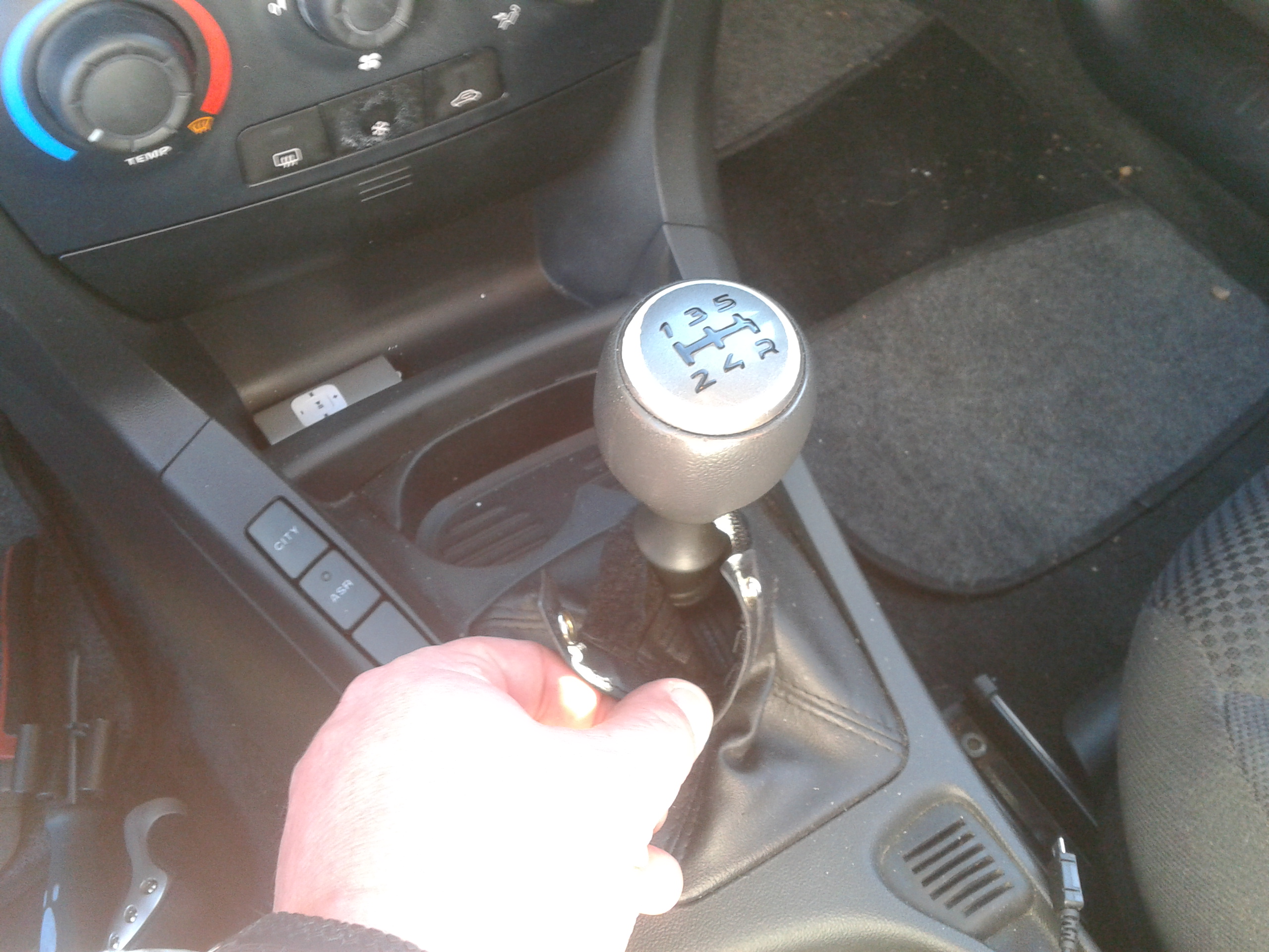

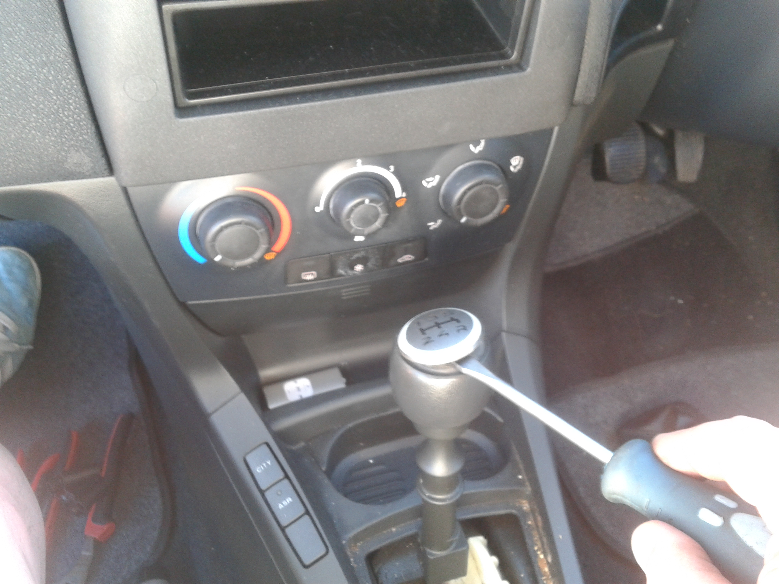

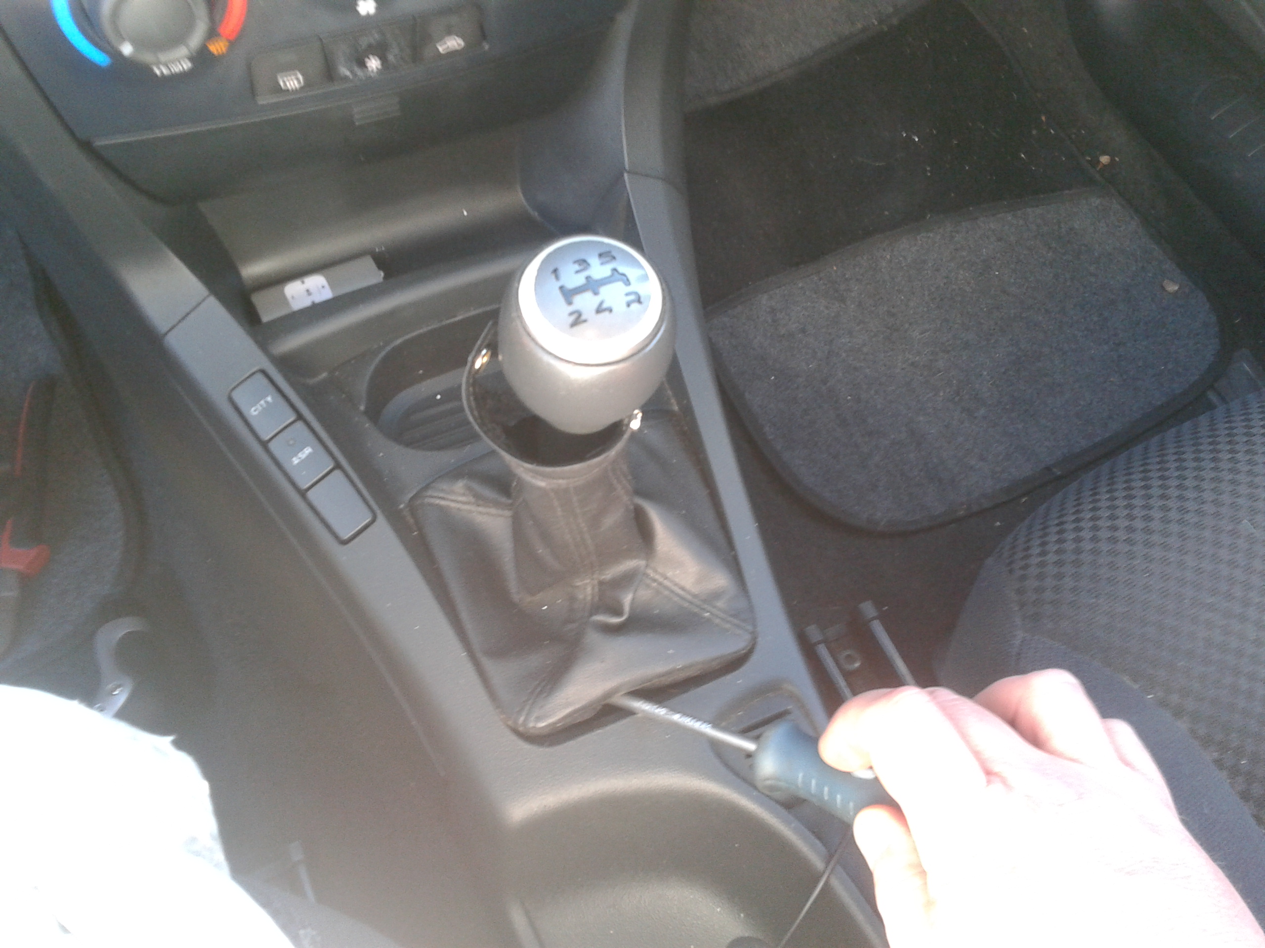

step 2. remove the plastic top of the original knob and cut through the rubber with a sharp knife or cutters, then put grips aruond the plastic and wiggle the knob free (sounds kinky eh?)

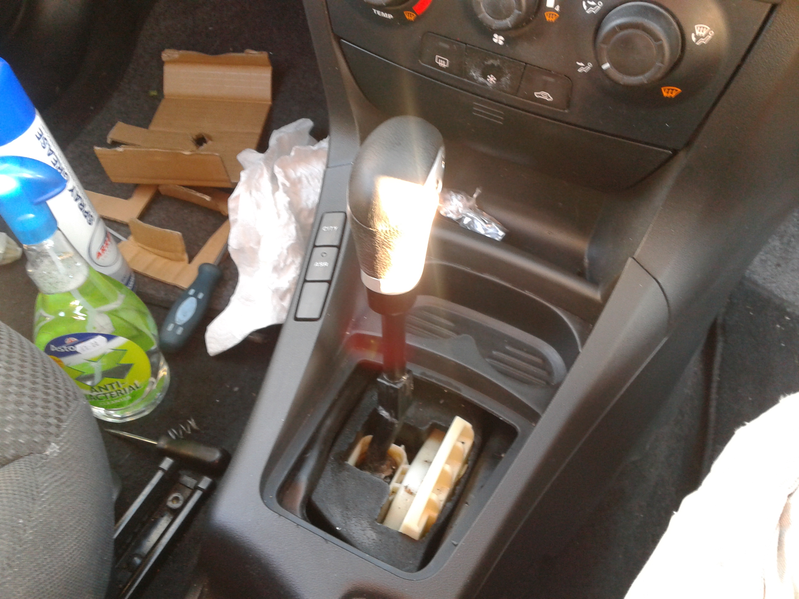

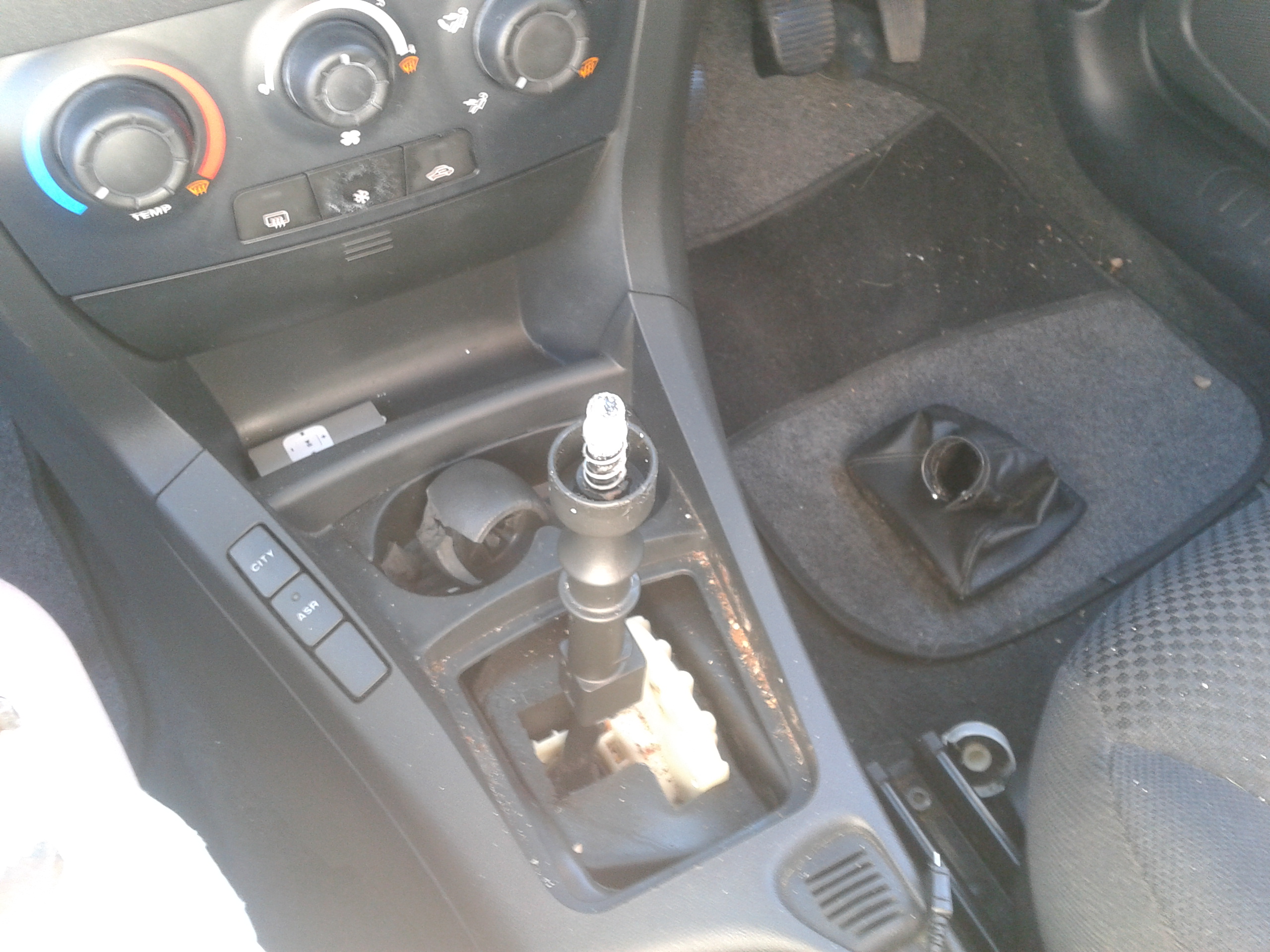

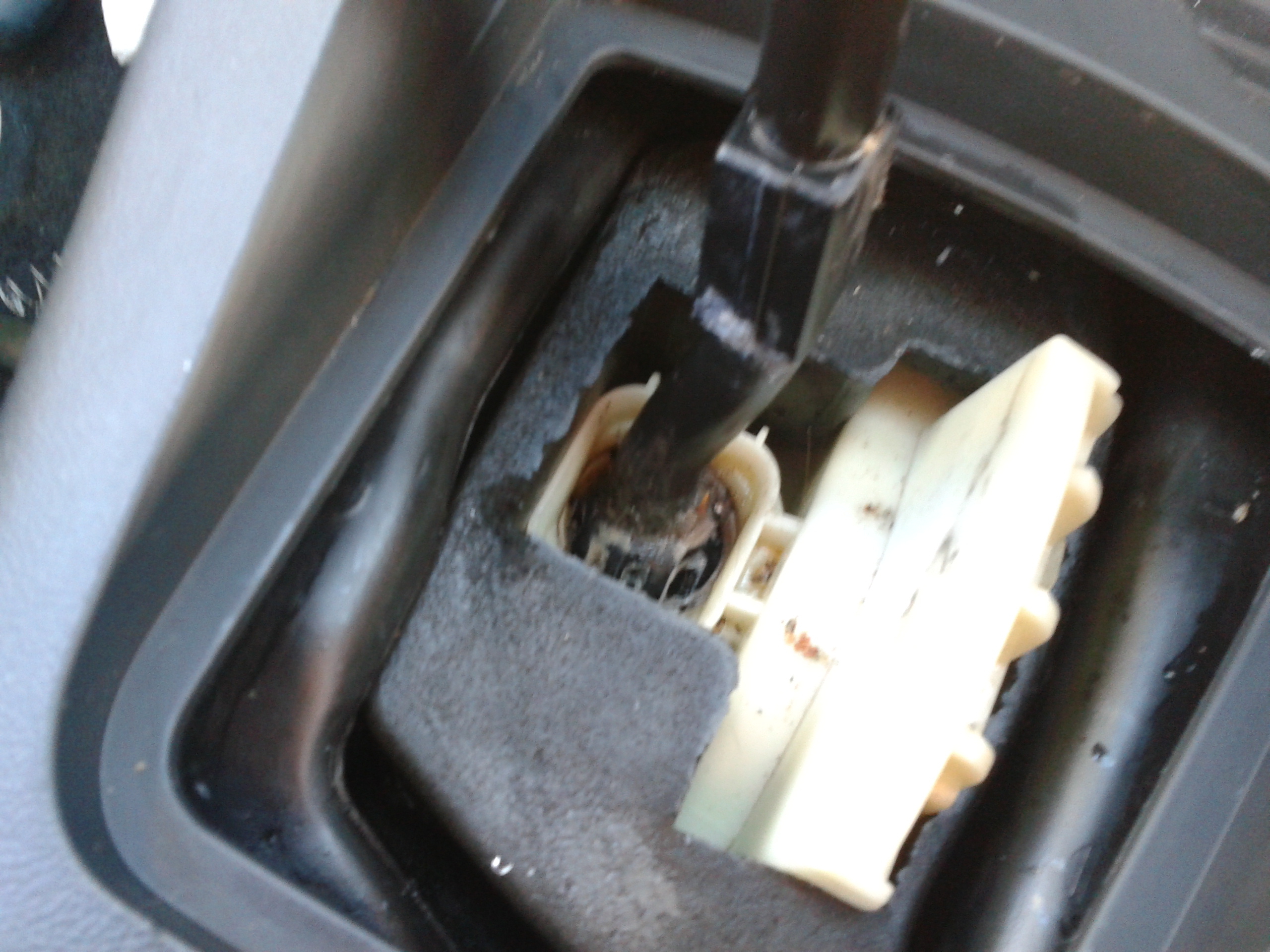

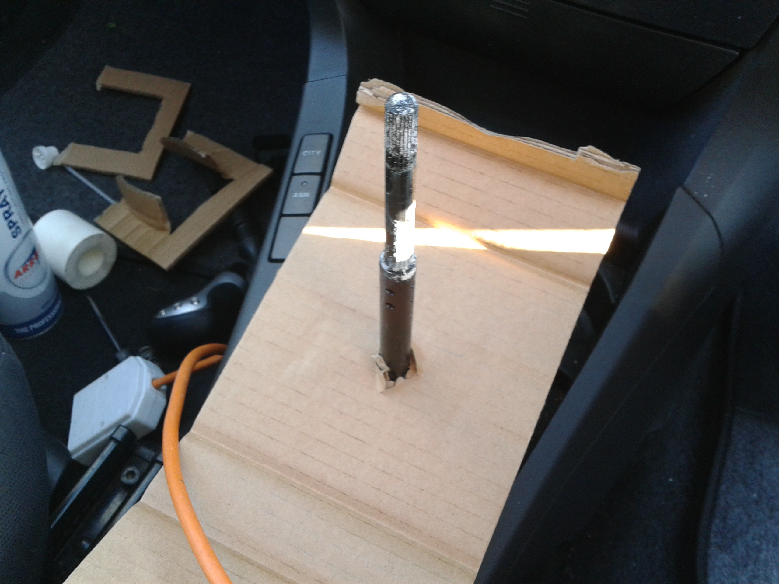

step 3. remove reverse lift part of plastic and cover hole with cardboard to stop the swarf from cutting going into the gearchange mechanism.
step 4. cut the lever to your required length(unless you are very brave or very stupid please don't use an angle grinder as seats burn.) i used a jigsaw but a hacksaw will do the job.

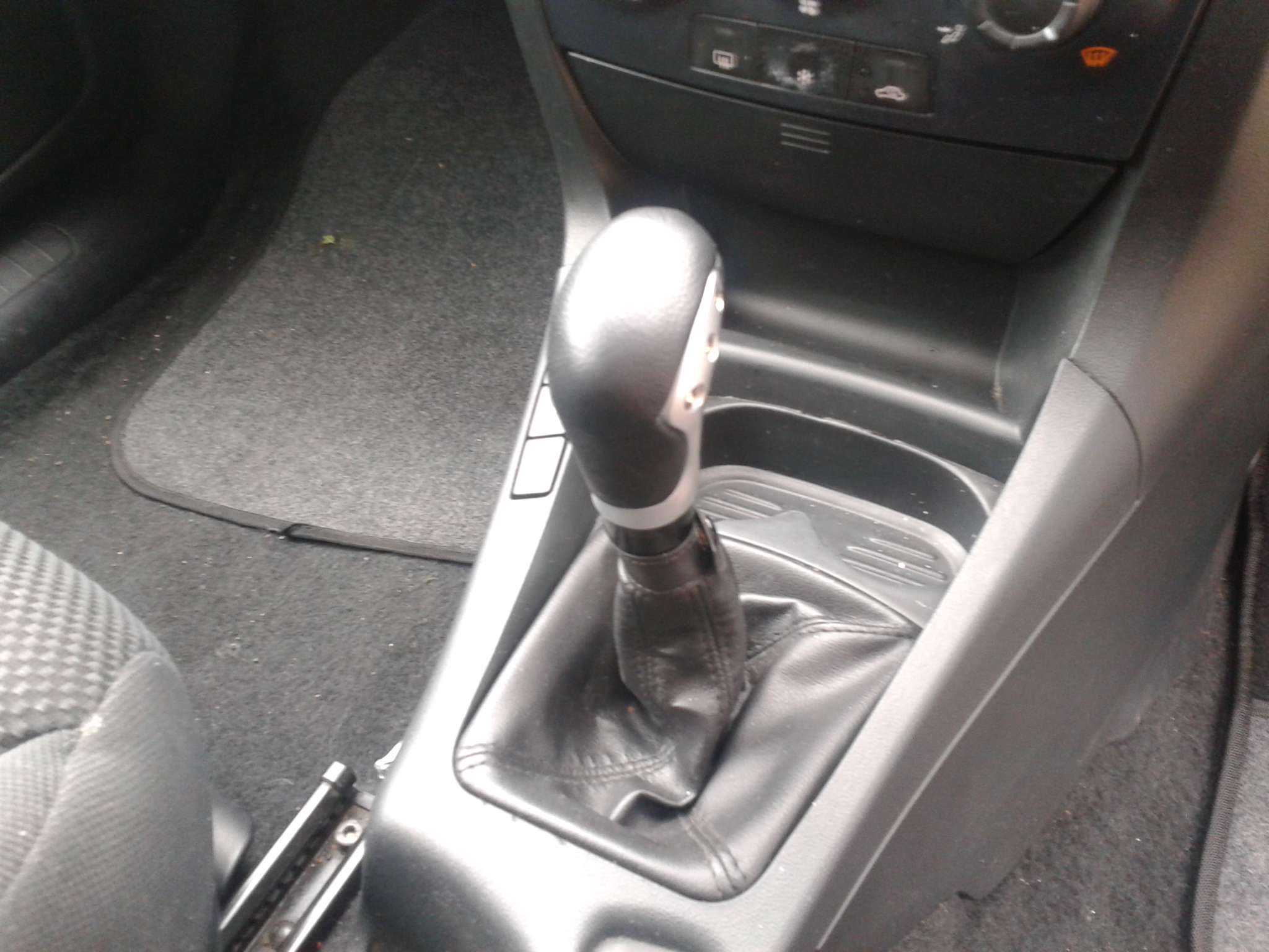

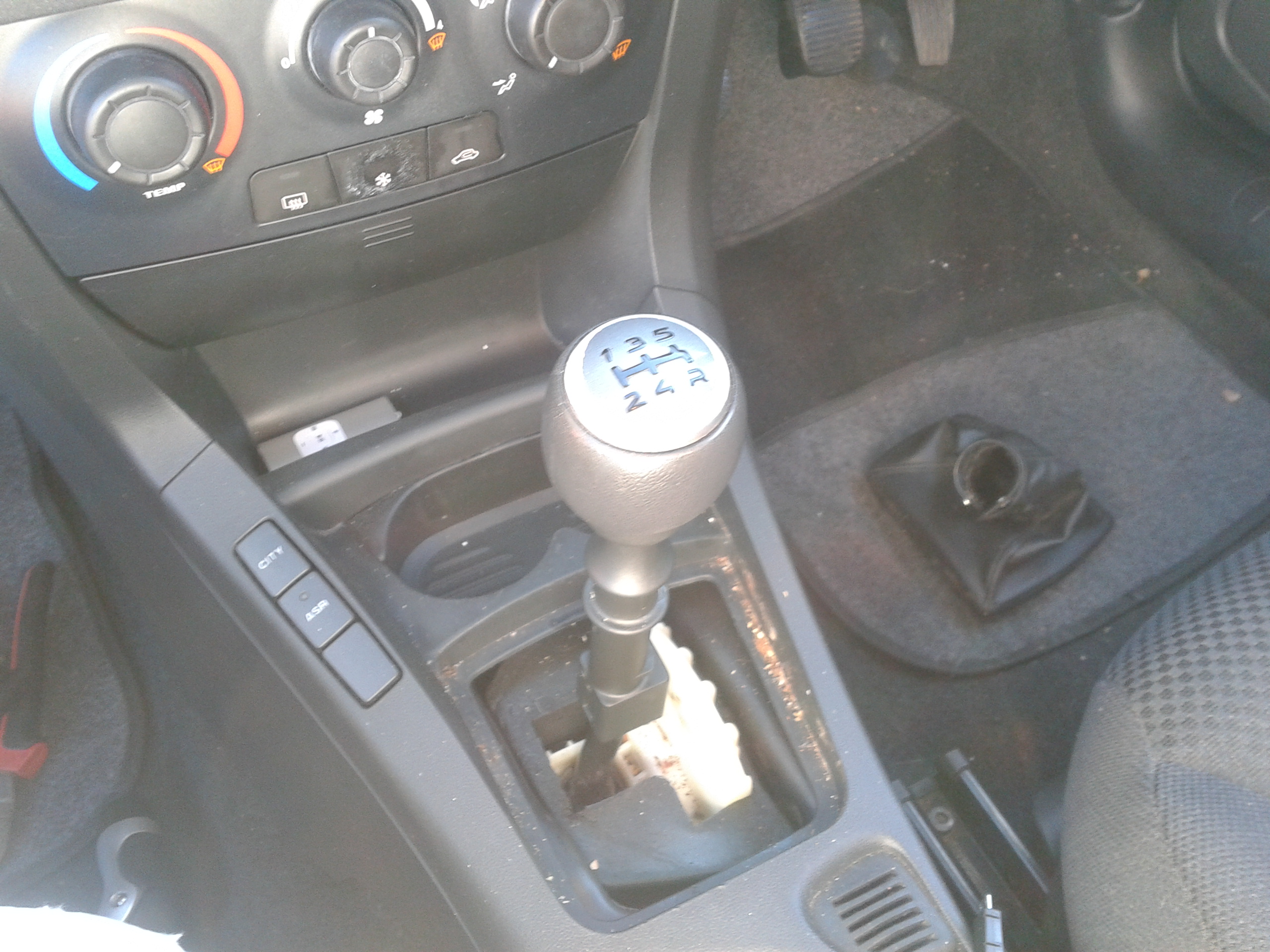

final step. fit the new lever of your choice and put grease into the gearchange mech for a smoother shift, slip the gear gaiter back over and attach in place by gently pushing it into the clips.
and finally. go into your kitchen and get a shot of brandy, pour into glass and ad coke and ice (slice of lime optional.) take drink outside to car and toast yourself to a job well done.
total job time for me was 15 mins, 20 if you use a hacksaw.
