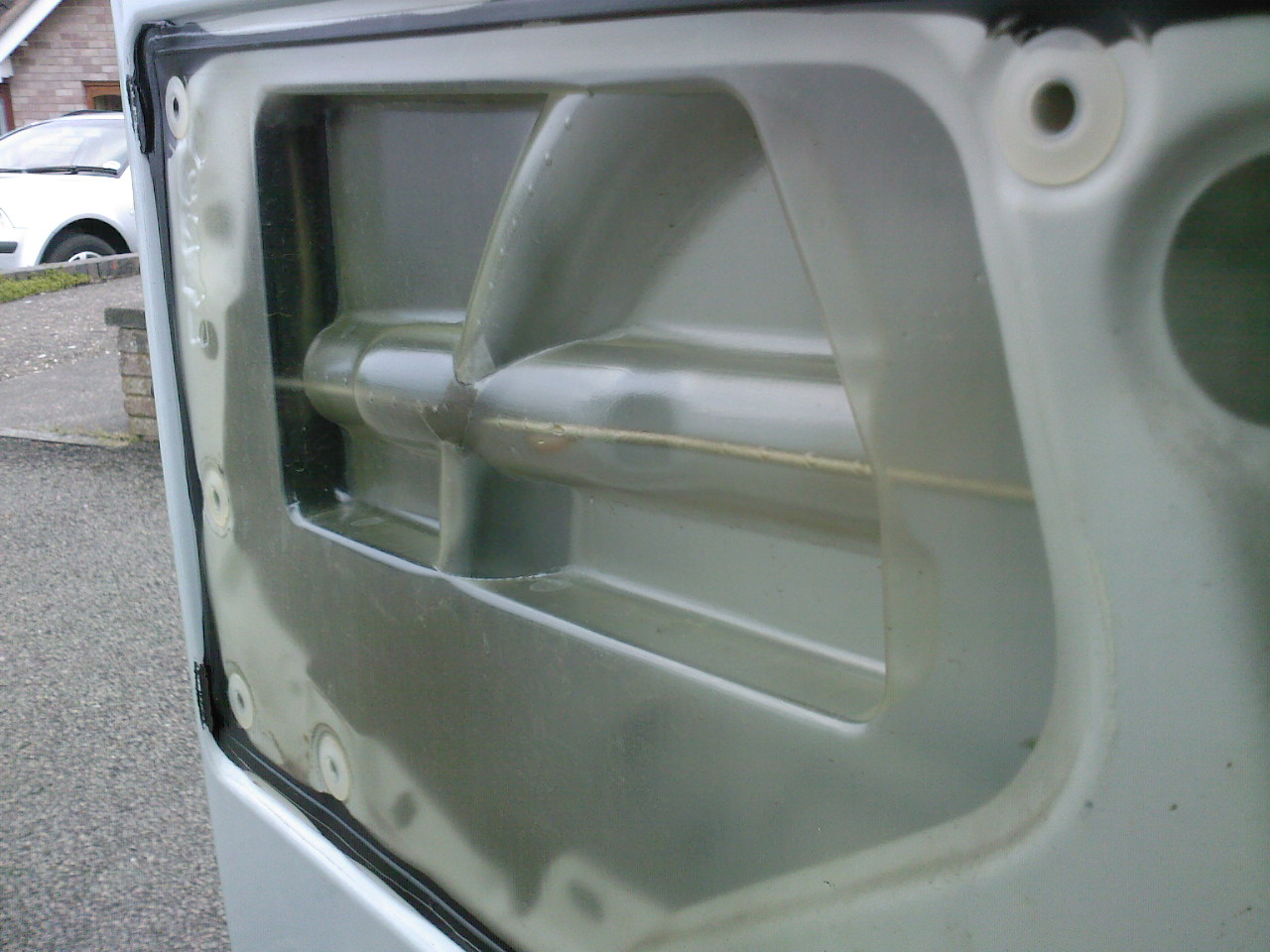

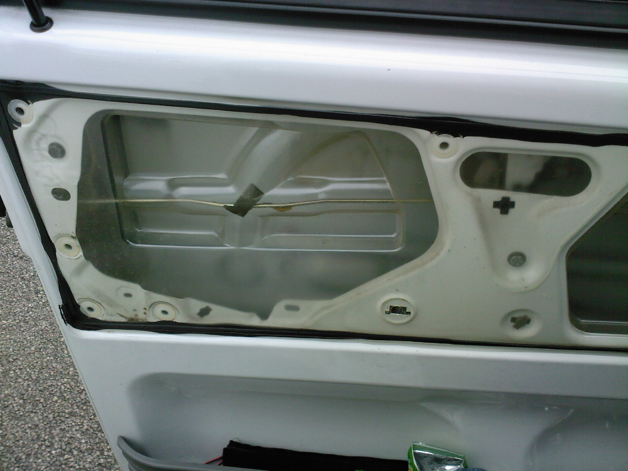

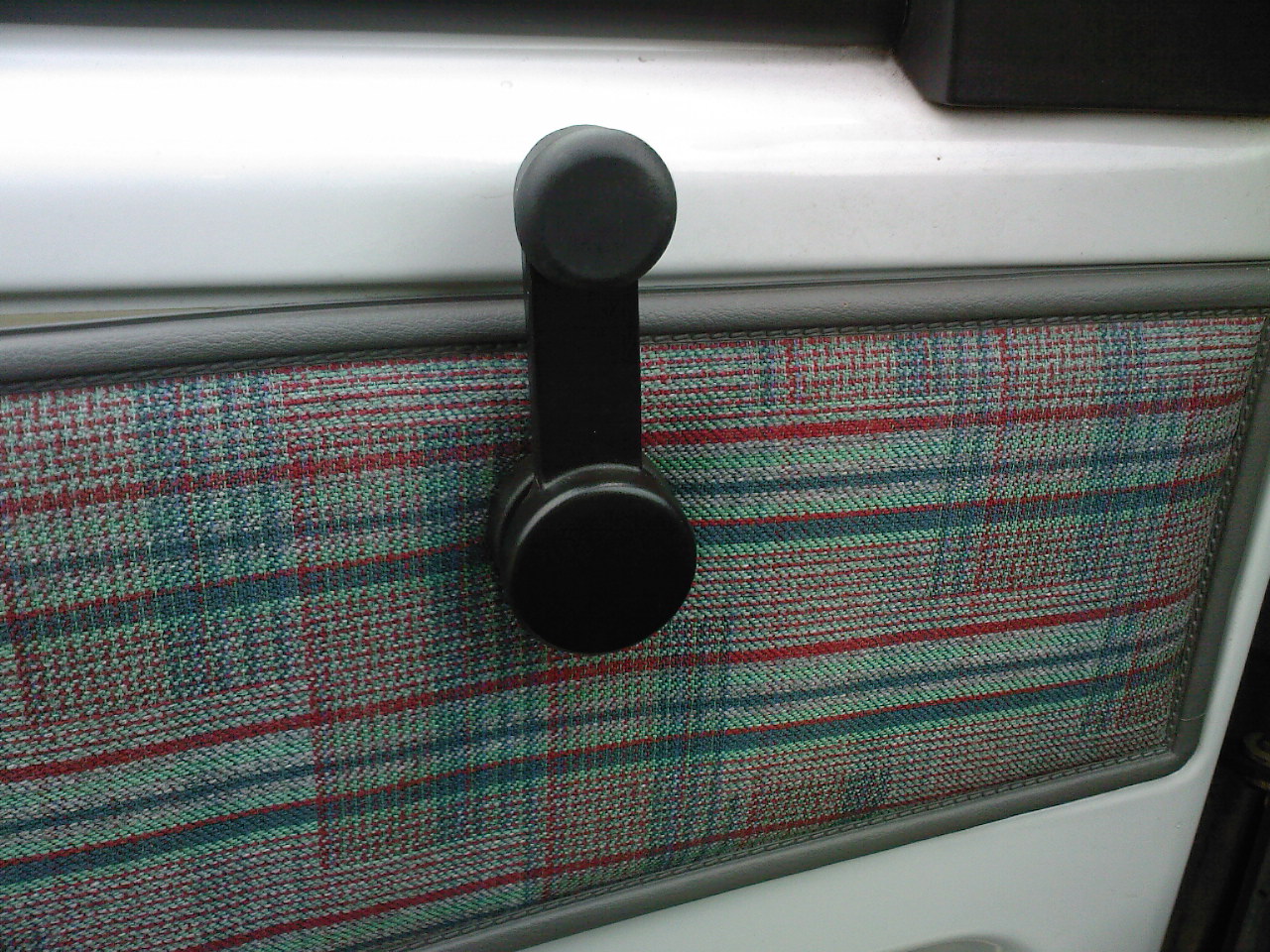

I attempted to remove the door cards for some new blue pimpage, but came across some problems:
1. How do you get the manual window thing off.
2. And how do you remove this plastic cover from the inside of the door. Seems to blue glued on by some strong weird shi*.

Oh boy, this is going to be difficult to explain.
Winder handles are held on with with wire clips at the back. Push the door card in towards the door and look down the back of the winder handle. You should see a piece of wire staring back at you. Depending on which way its been fitted, and it will be apparent when you look, either put a crochet hook or similar into the clip, if the loop end is looking at you, or using a thin screwdriver push it away from you if the feet end are facing you.
Fitting is easier, you put the clip on the handle before you put the handle back on.
Vapour barrier, for that is what the plastic is, heat the goop with hairdryer to loosen it.

Yer they should come off at them if you proper pull at them, or cut into the plastic and lift it all off, depends if you want to put them back on?
