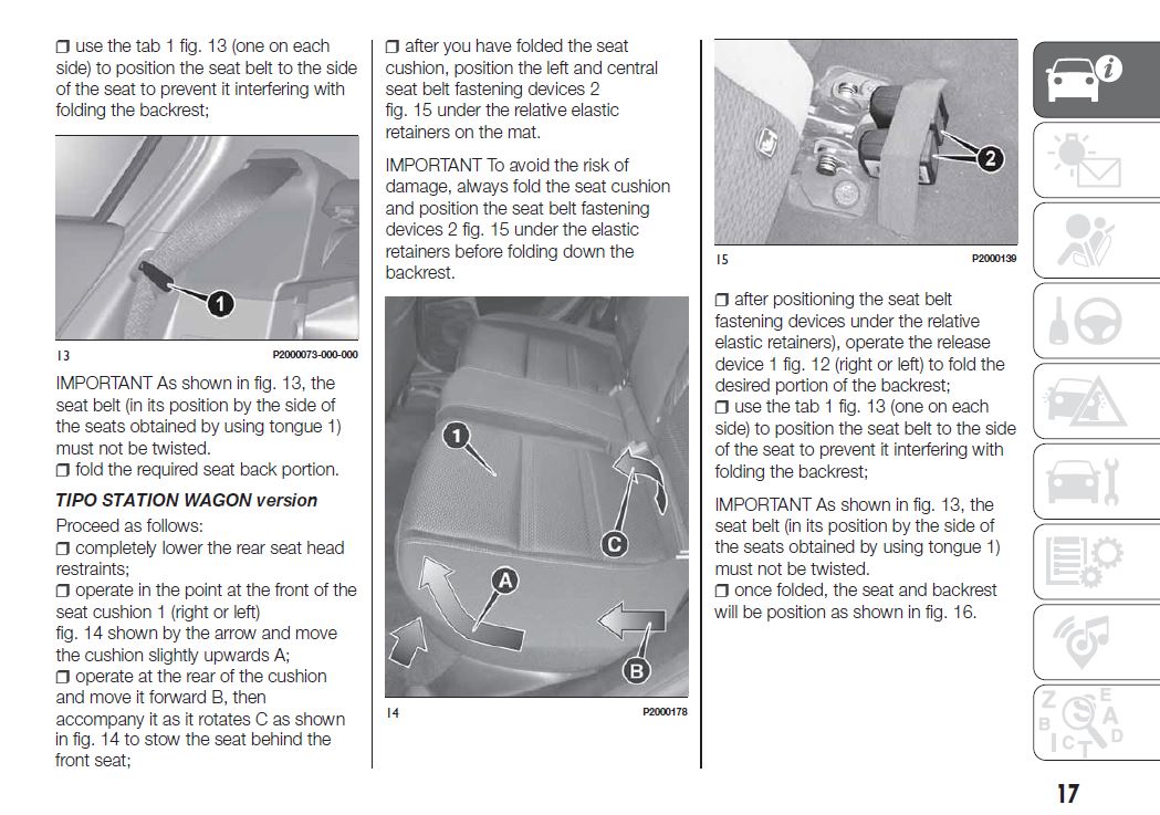

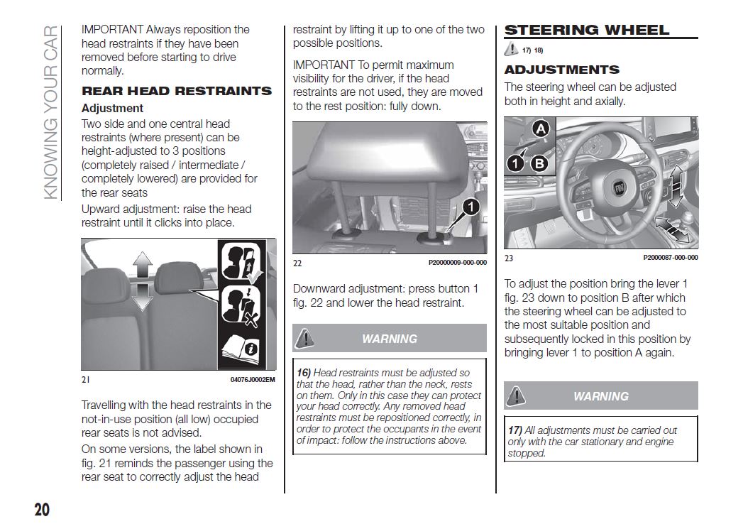

If it's of any help, here are the relevant pages from the latest Tipo handbook that I could find (04/2018) ...

They do fold perfectly flat in the station wagon.
1) Pull the bench seats up using the little strap in the middle of each section of seat and fold them against the front seats.
2) Tuck the seat belt buckles under the straps at the bottom of the back rest.
3) Pull the clip on the top of the back rests and fold them down flat.
4) Tuck the seat belts into the clips on the B pillar.
