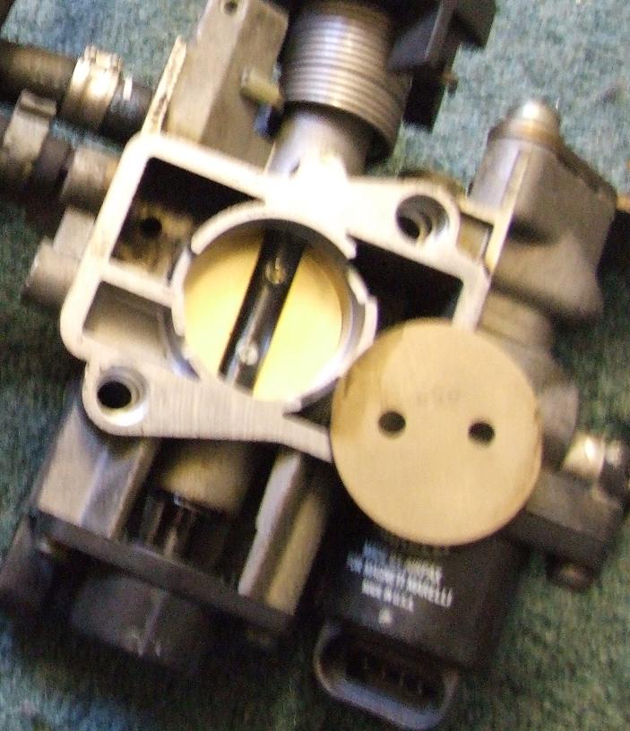

thanks guys! I own the engine now (£100 and got a P60 throttle body/manifold) ive did the mod that includes the original top from the SPI and p75 bottom. 2 hours work on my lathe and its fitted to my 1.1.
and i say.... f***ing wow! the car is not the same! and the induction noise is amazing.
The car took about 2mins to settle. it reved its ****** off for a couple of seconds (thought i had a air leak)
I cant wait to get the 1.2 with the uber cam in my car. (no time soon as im going to get the block decked and do some porting.)
first photo is of the p75 disk sitting onto of the p60 TB. the cinq (p55) disk is even smaller (looks silly when there side by side)

As you have probably change dthe TPS sensor on the throttle body, there is a procedure to recalibrate it.
I THINK it's start teh car, and full throttle 3 times in quick sucession...turn off, then restart.
That AFAIR recalibrated the TPS.
If the TPS was out, the idle valve prob went mental and let loads of air past, hence the high reving.
If its runnign fine now though, don't worry :)
