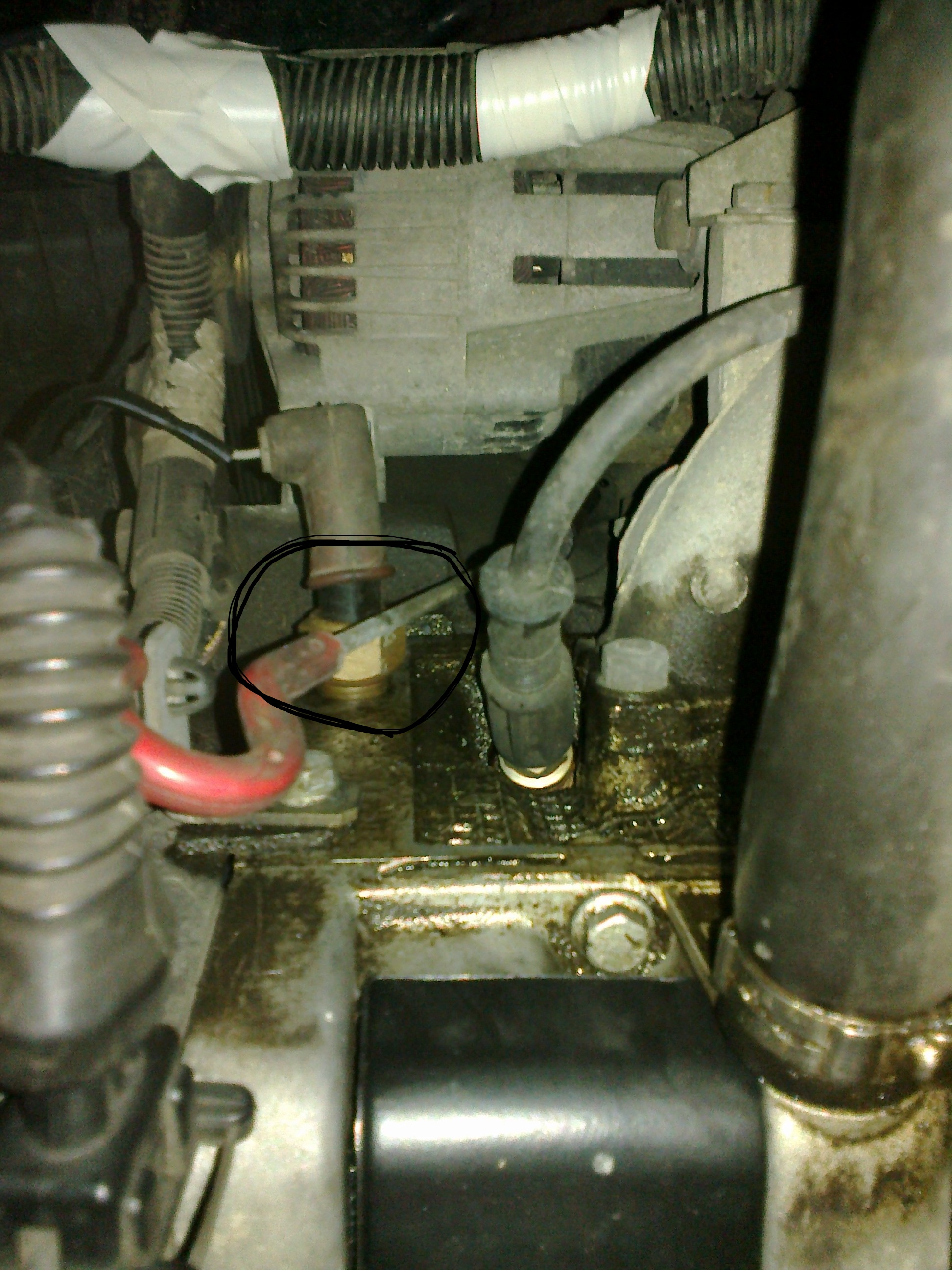

this is the farthest my temp gauge has come so far since i have put a new dashboard and temp sensor in my 1.1 55s mk1
second pic shows temperature sensor location
