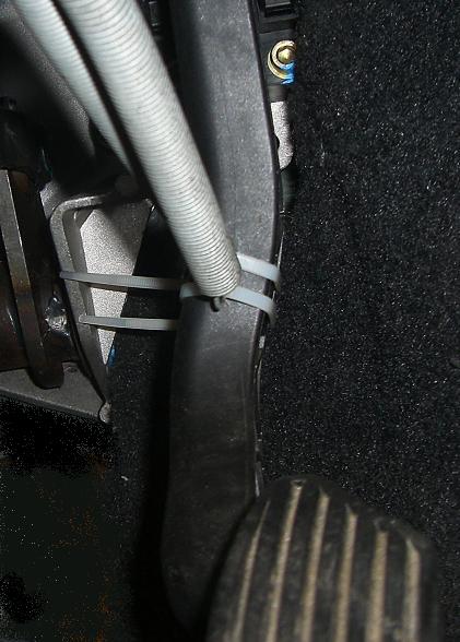

Simply a couple of tie wraps and attaching a spring or two to the pedal and the other end to a part of the under dash gives the pedal much more "feel" and feedback. Besides the embarassment factor, you are not going to get good economy if you are constantly putting on excess gas.
I modded mine the first week I had it
If it's any help, this is what I did to mine. I have two fairly strong springs and two tie wraps so there is a back up if one tie wrap fails. You can't see it as it is under the dash and is so effective I'd forgotten it was there and has been there for 5 years or more

Those were just a few springs I had lying around but they're around 125mm long and 12mm dia. They need to be pretty strong as our feet aren't the most sensitive and I'm no ballet dancer:)

Well i just want to say a big thanks for all the suggestions... I went to homebase today and bought a spring pipe bender and cut it down to size, Got to say the feel of the car is greatly improved and no more over reving!!! Cant believe that such a simple modification could make such a huge difference..
It's an enormous and simple improvement isn't it :)
I'm all for fly by wire as it's got to be done that way but it needs to have some better feedback and feel and should have had some means of adjustment for personal preference. You'll most likely find your mpg will be better too now
