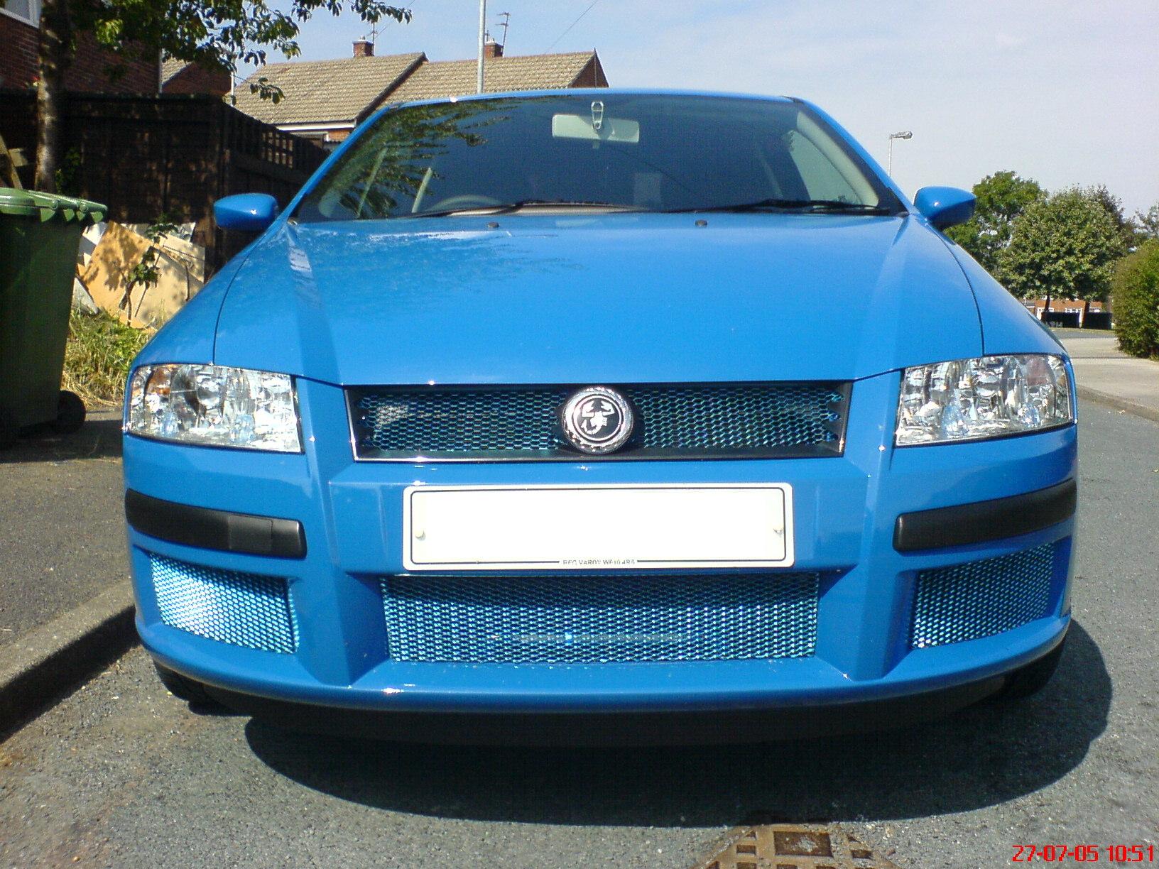

Does anyone know how difficult it is to mesh the bumpers on an arbarth?
That is if mine does'nt come with it already?
Not sure as im having the GP Kit.
The schuey one has meshed grills not sure if thats because its ltd or part of GP Kit? Any help??!!
It's very easy to do just cut the mesh to size & use self tappers to hold it in place!(y) Although you have to remove the bumper.
Here's mine!;)

heres a pic of mine. used no self tappers and didnt remove the bumper :D although think i might change them to silver :chin:

Stilosporting,
How did you attach the mesh on your bumber. I know the old bits just pop out easy but how do get the mesh to stay in place?

minimad99 said:
Stilosporting,
Cheers
i took the black sections out, wrapped the side of the mesh round the black sections and then put them back. sounds easier than it was, took me 2 days to do it all!
