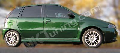

Hi now i have the paint code i would like to colour code my fron t and rear bumper to make it look better but im not sure where to start.
the bumper is not smooth so would i have to smooth clean then prime and paint if this is correct what products should i use:confused: and what step should i do them in. i would like them to look like this
does anyone know a good thread or a vid on youpube thanks luke
