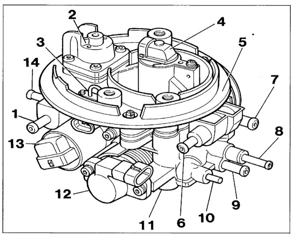

Got the part today. Unfortunately it only contains the throttle body and not the injection part. However, I can see how the two parts (the throttle body and the injector holder part) are hold together. it seems that the two long bolts that are holding the air box on top of the throttle body also bolt the throttle body in place so it should be safe to remove the injector part only and see if I can service the gasket. Hopefully this is my problem.
OK, I had some more thoughts, and come across to a doubt about the gasket between the throttle body and injector body. If that fails I cannot see that that causes high idle, as the gasket is before the butterfly of the throttle and that should not cause excess air to go into the engine.
The assembly below the the throttle body may leak though, but there is no gasket?
Yes, the image is not clear but that part contains two parts. Nr 5 is the part that holds the injector and is connected to the bottom part the actual throttle body by gasket. The guy from the scrap yard only send me the bottom part.
yep, i was more talking about the leaking from the base really, but while you have it off it makes sense to redo the middle gasket too being that the two halves are only held together with 2 plastic clips even if you just apply a smear of instant gasket to the join. Leak from the middle is less likely to cause an issue but can do still if its not a steady leak if that makes sense.
