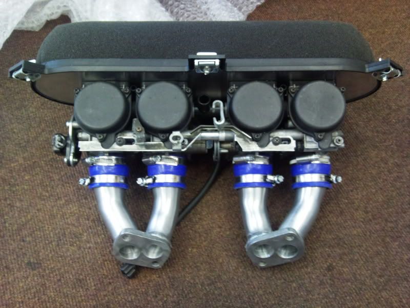

The bike carbs are away having a manifold made and my new cam should arrive from Cat Cams this week.
Are you running bike carbs or ITBs? would love to have a go in that after its finished!

Honda CBR400RR carbs, shown here on a different (Reliant) manifold.

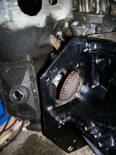

The 750 formula racers use the 1108cc FIRE engine attatched to a Reliant 850 box so they supply an adaptor plate which I have, the front mounts are one-off.
Ok where did you get the adapter plate? i must have a go myself thanks for the inspiration BTW...:slayer::worship:
