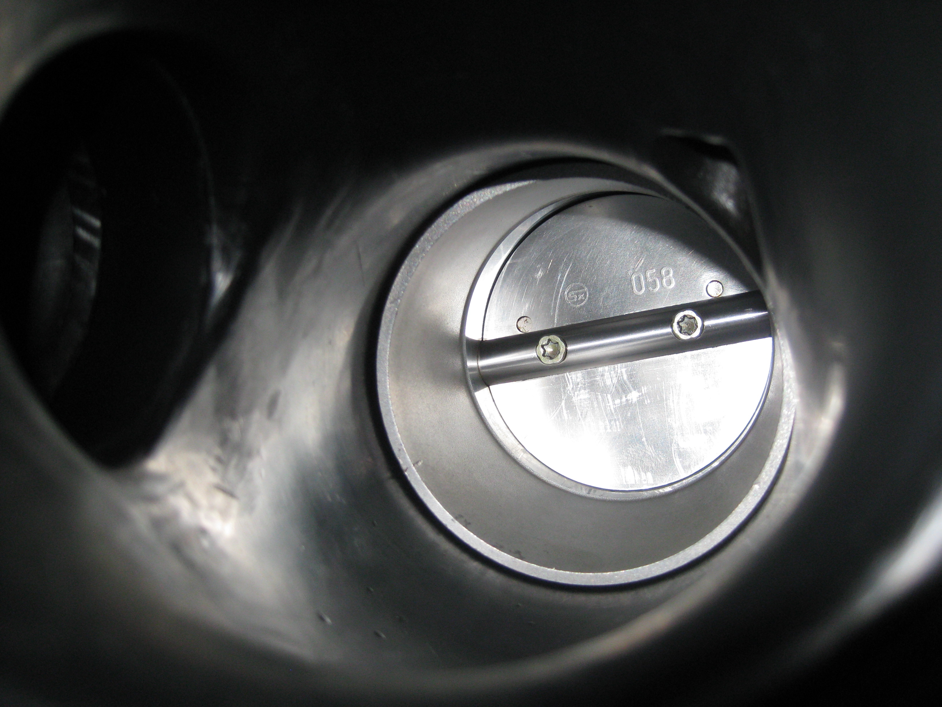

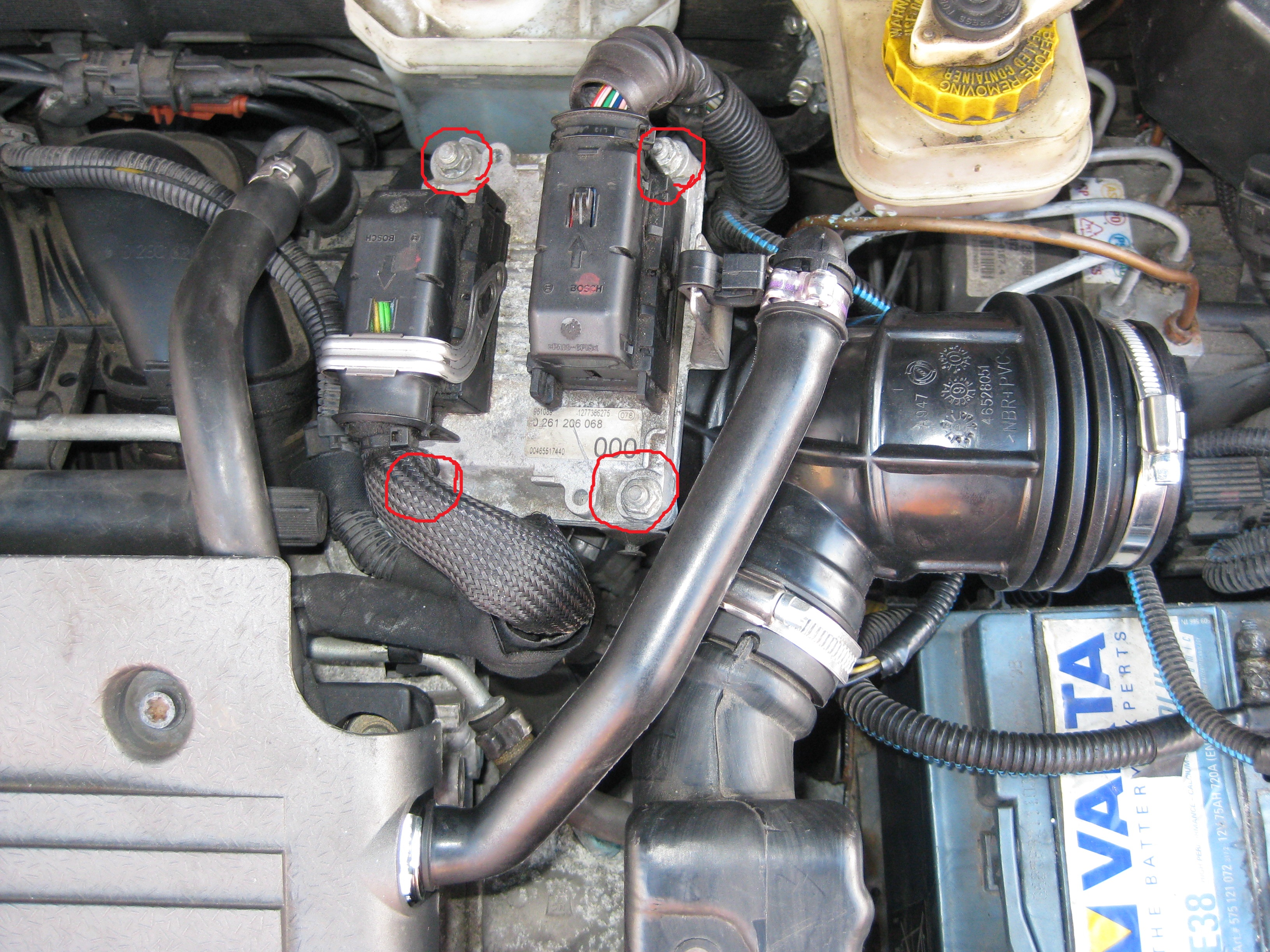

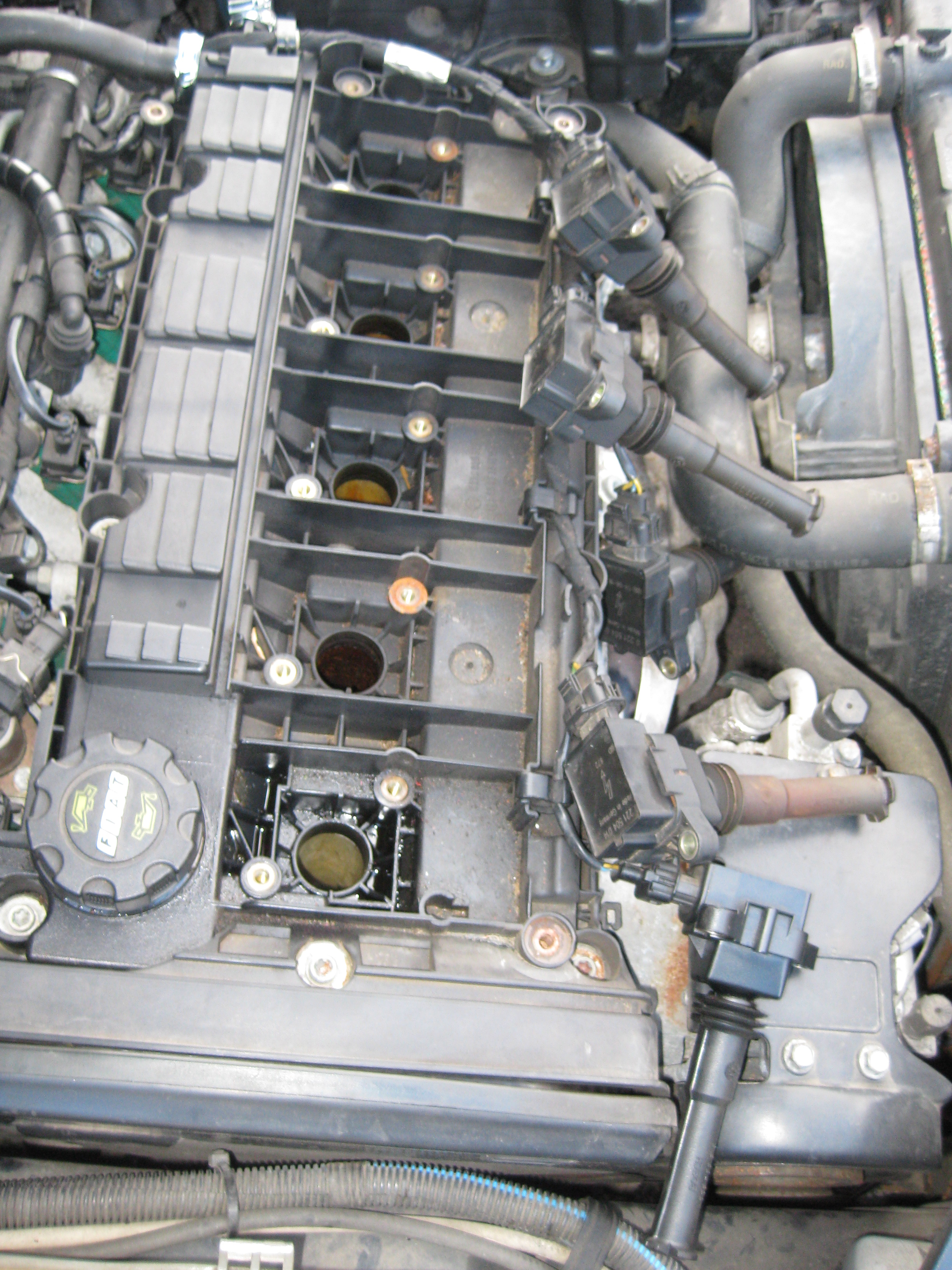

just thought id put these photos up to help newbies recognise and find these bits if they ever need to know wat they are.....
undo the 4 10mm nuts ontop of the throttle body,, unclip those 2 cables on top unscrew hose clamp underneath then theres 4 x 5 or 6 mm hex bolts going through the throttle body into the inlet manifold.. take these out and the body comes off ps if you decide to take the butterfly valve out make sure you note which way it goes back in other wise it wont seat properly and everything will need to come out again... battery and whole air intake needs to come out,, and the resonator tank aswell,,
