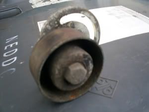

Pic of the old one
http://i23.photobucket.com/albums/b360/sroys/old_1.jpg

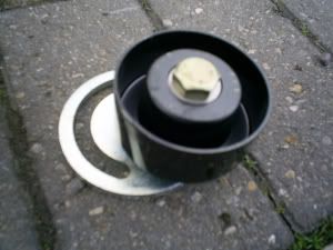

The new one that is going now which was replaced
http://i23.photobucket.com/albums/b360/sroys/new_1.jpg
This replacment is now going. Its about 10-11 months old.
Once the new pully is on the car is fine, runs great. I do get a bit of belt noise but told this can be normal for a HGT.
When the tensioner gets to about 9 months old, its starts to make a slight greating noise. This does get louder and louder over time till you can move the wheel from side to side like the bearings (or bush) have gone completely.
