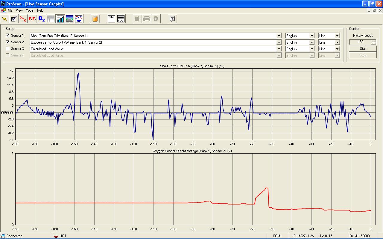

Ive attached a screen shot of the Lambda voltage graph for one front sensor and the rear one(lambda.jpg) from everything ive managed to find on google i would have expected a more uniform pattern to the voltage curve, can anyone coment on the graph and if this is about right or not?
Thebottom graph on the second attachment(lambda2.jpg) is the data im getting from the second front lambda sensor, the voltage is hardly changing and just sitting arounf .35 V! There is also a test option on the software I have that gives all sorts of data and readings from the sensor, works fine for the other two sensors but just gives an error when i try to test this sensor. Assuming my car has three lambda sensors does this mean this one is broken? And should i be looking to replace the other two sensors? (based on the data from the graph and my guess that they are 50k old)
