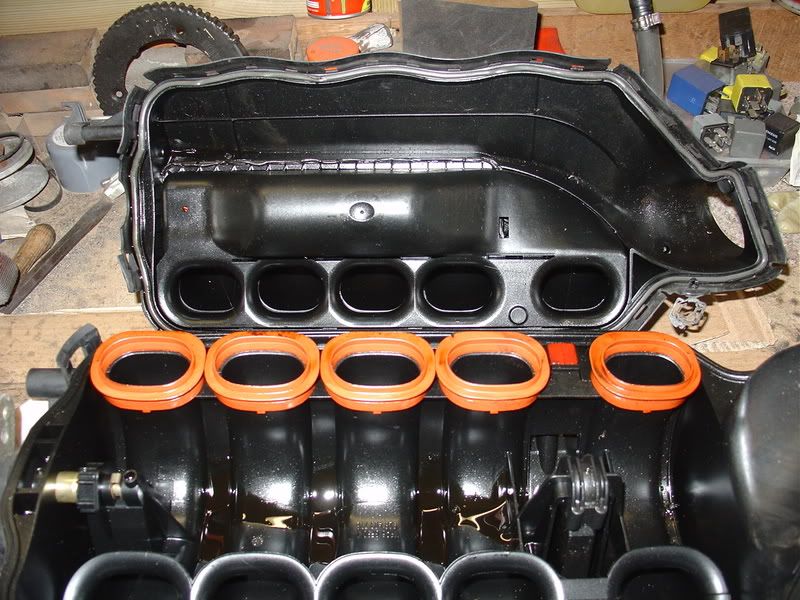

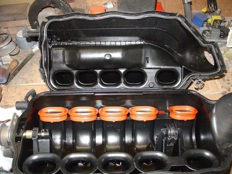

for any one that wants to know what the inside of the vis looks like
it has a lever controlled via a diaphragm that's driven off a vacume feed
