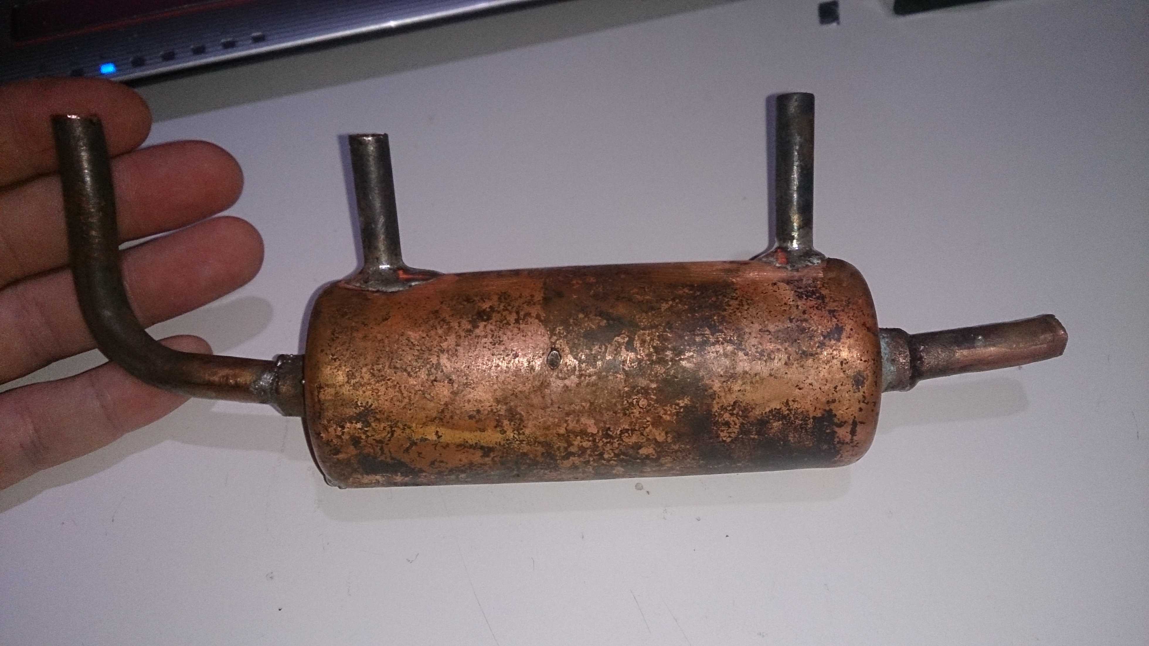

why you no make a header tank? just a small tank with 3 pipes leading into it. the top pipe returns to the main tank, the middle pipe comes from the fuel pump and the bottom pipe goes to the carbs.
you effectively have a small tiny tank that is constantly filled with fuel from the main tank, but holds no pressure because the fuel can easy flow back to the main tank giving you the same results as having a gravity fed tank on a motorbike.
use an aircon dryer like this but with only one pipe in the side: (rotate 90 degrees)

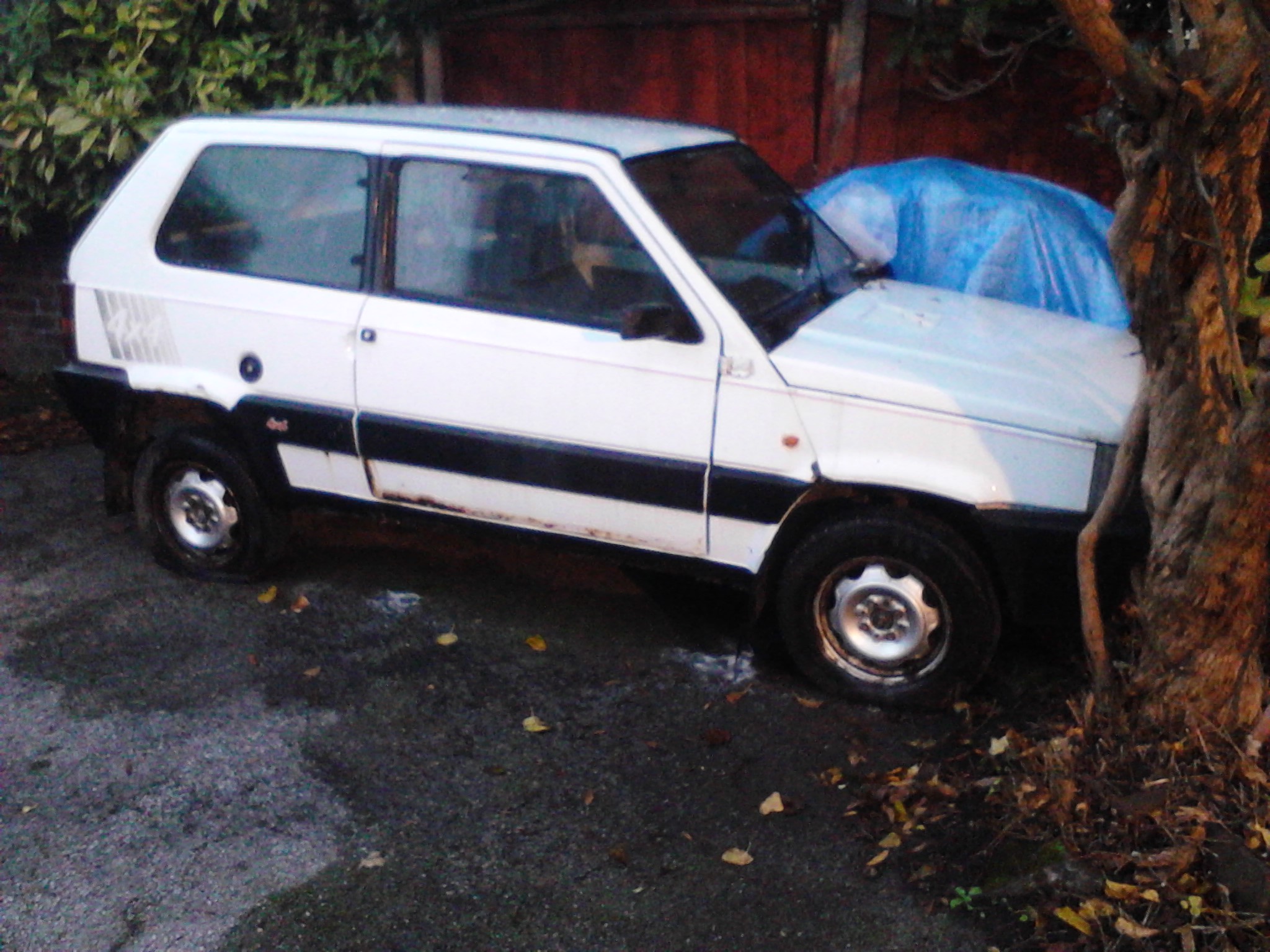

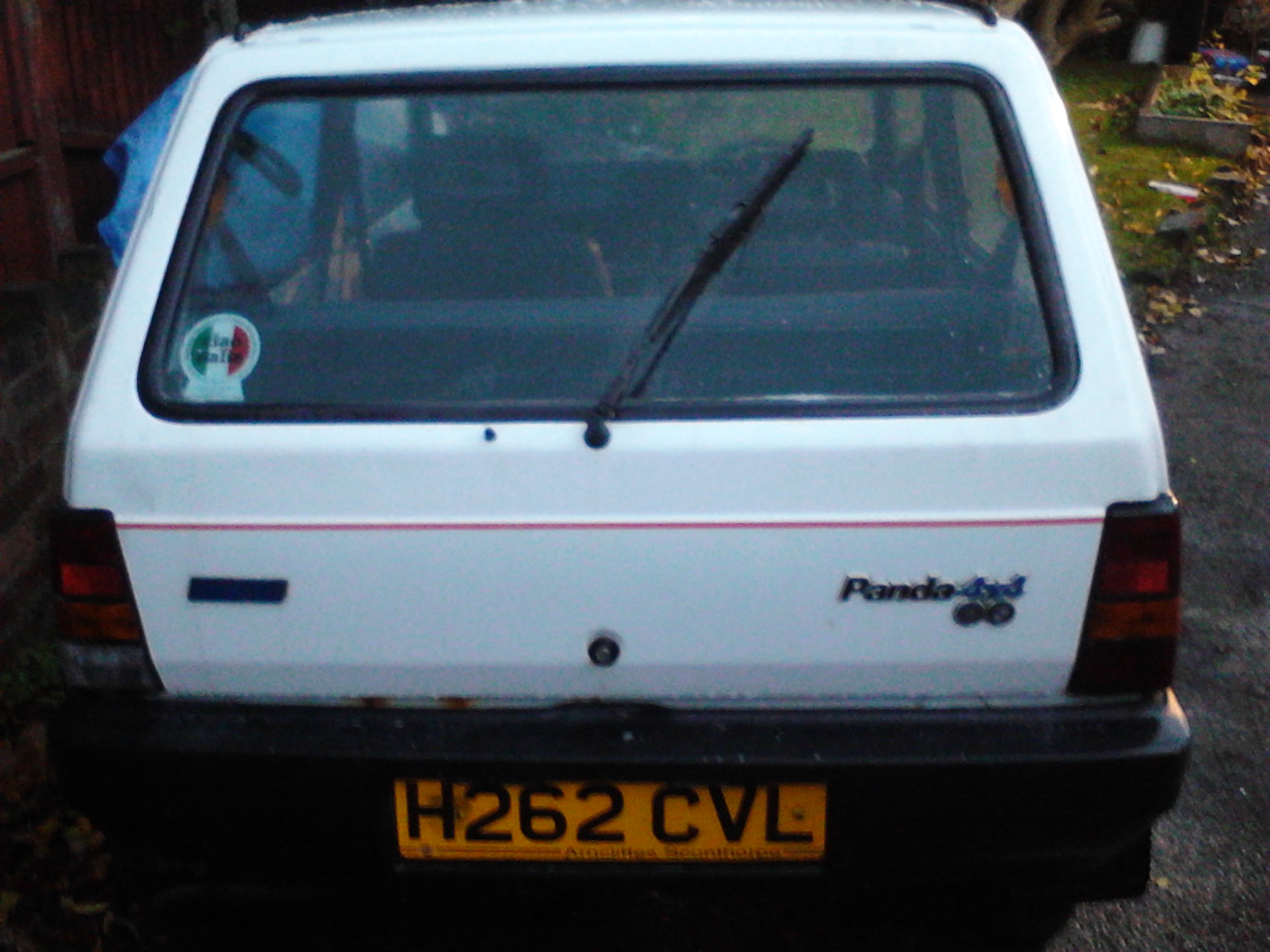

Found this while looking for something else. PandaPanda - Henry as a pale shadow of his current self...

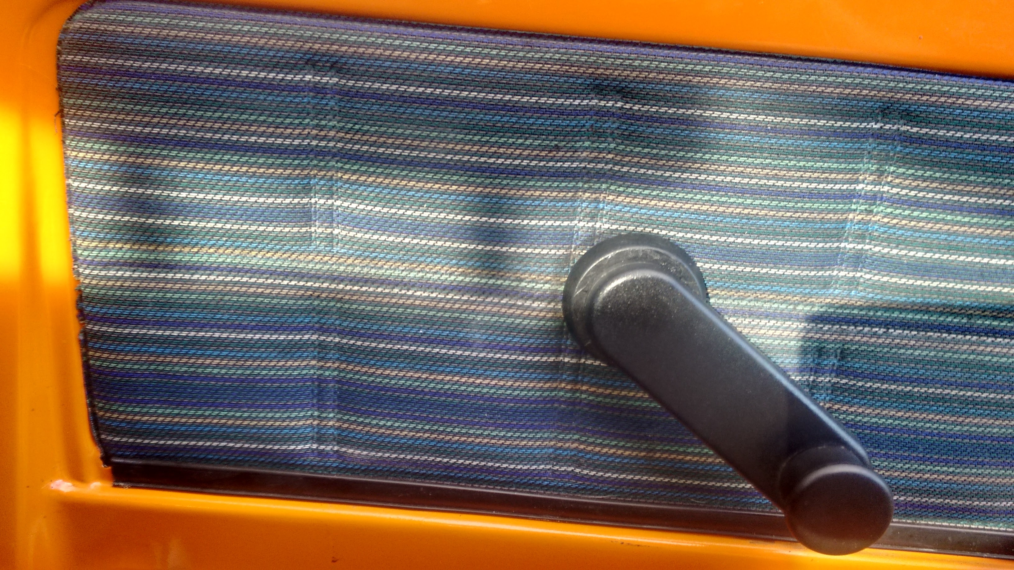

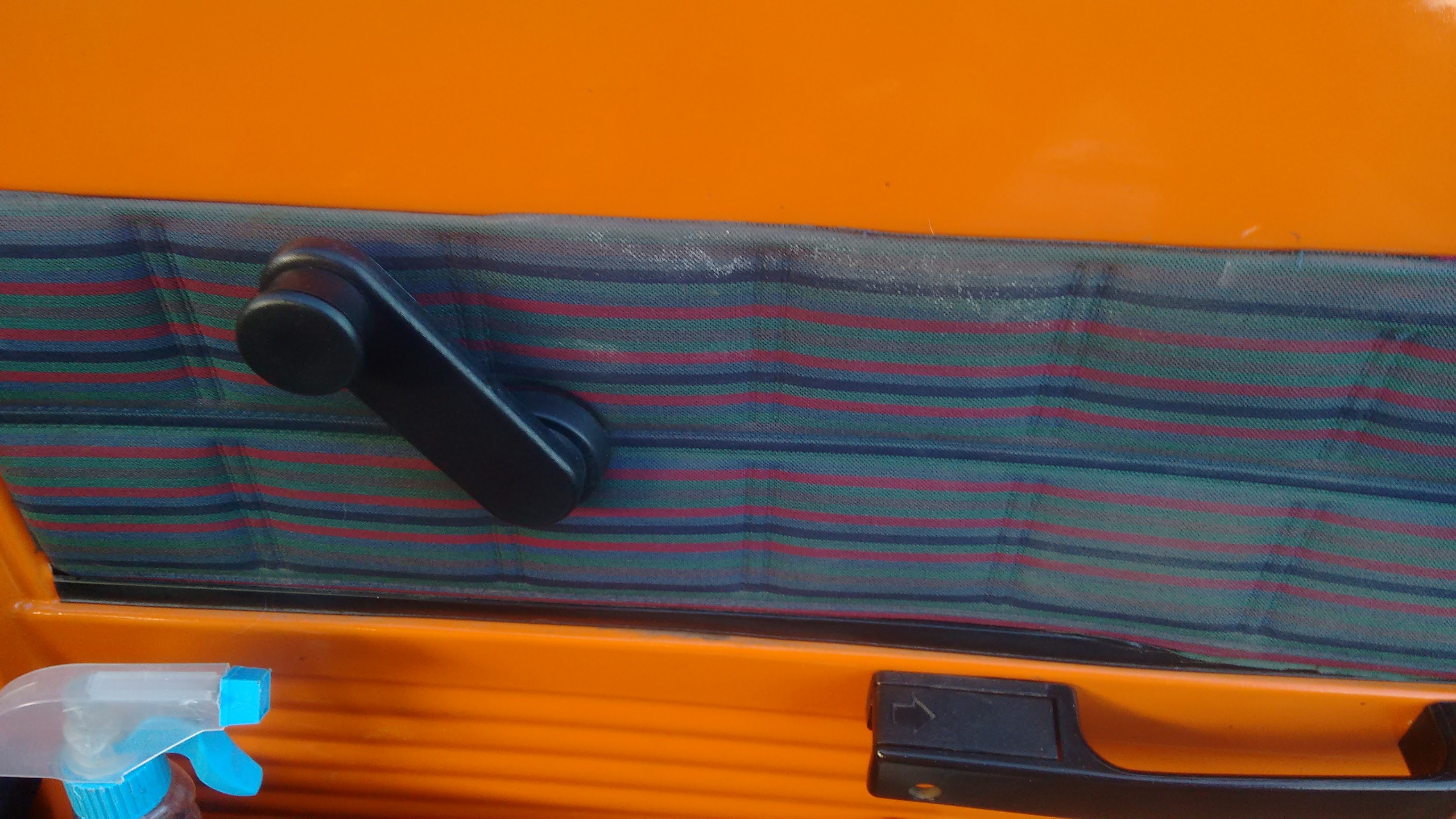

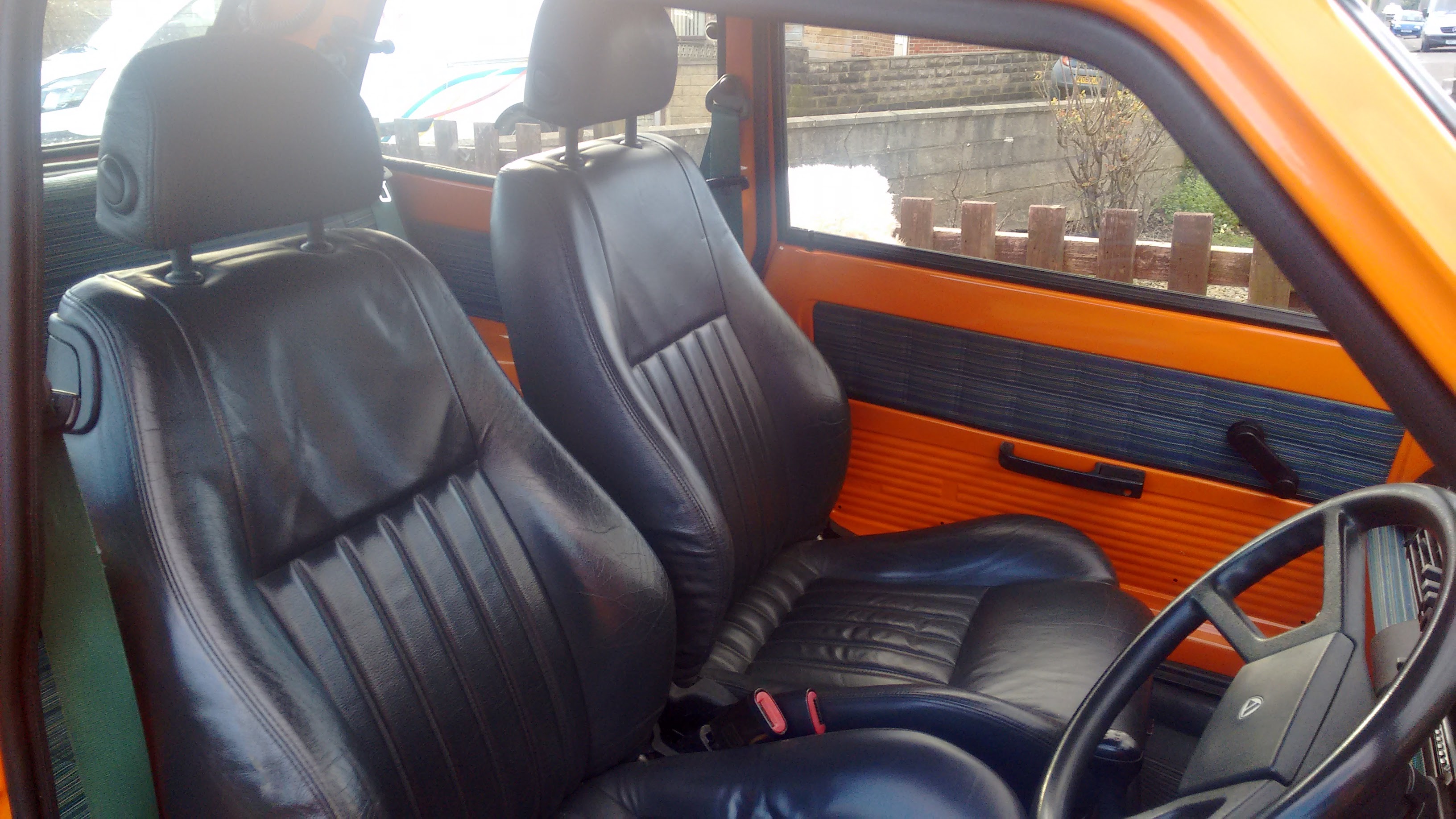

Henry's old interior - seats came from the colour in exchange for the Alfa ones!
I don't think the dash roll was ever taken out hence the remaining white bits.
You can see the quality of the repairs Sean did to the shell.

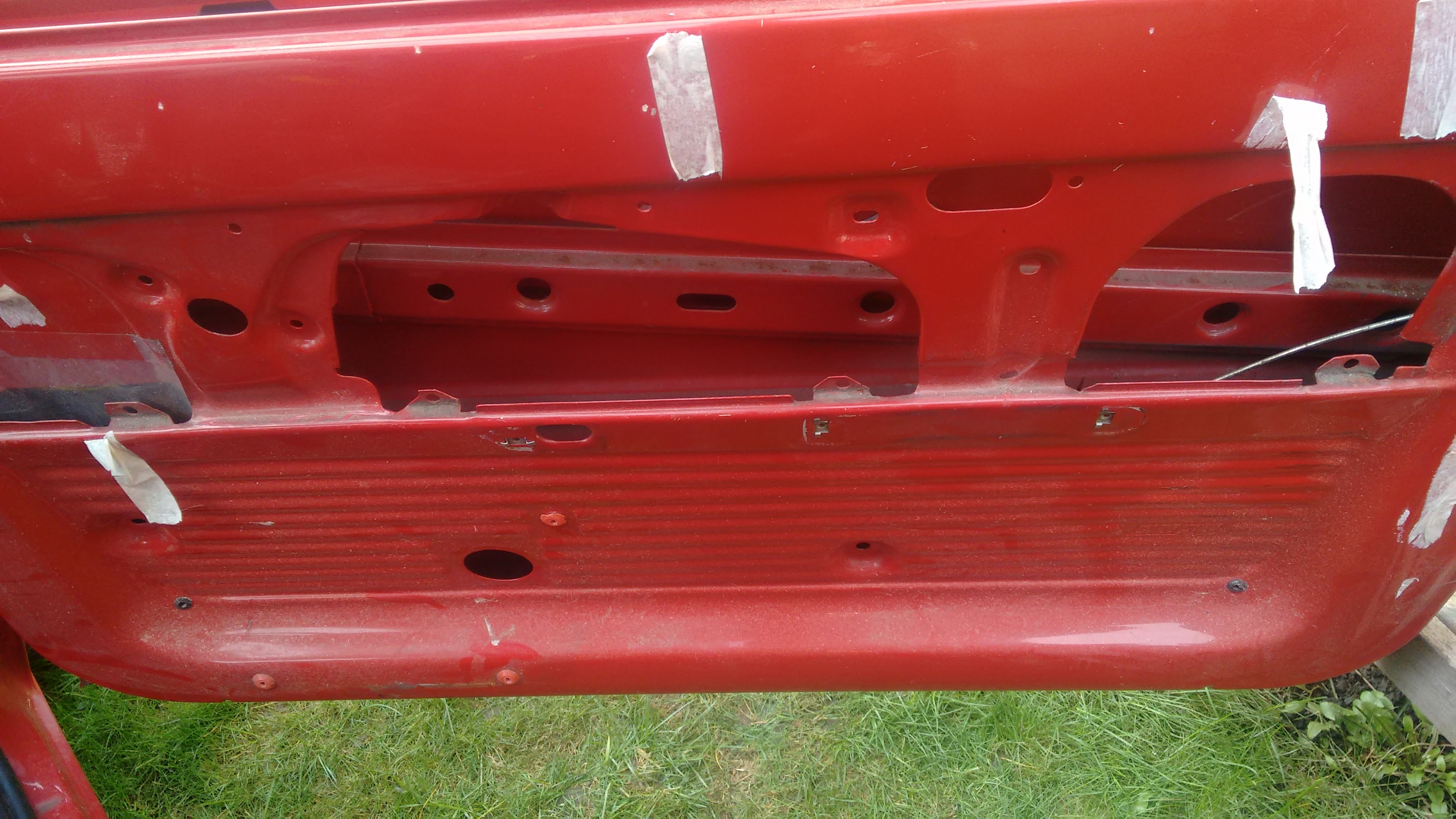

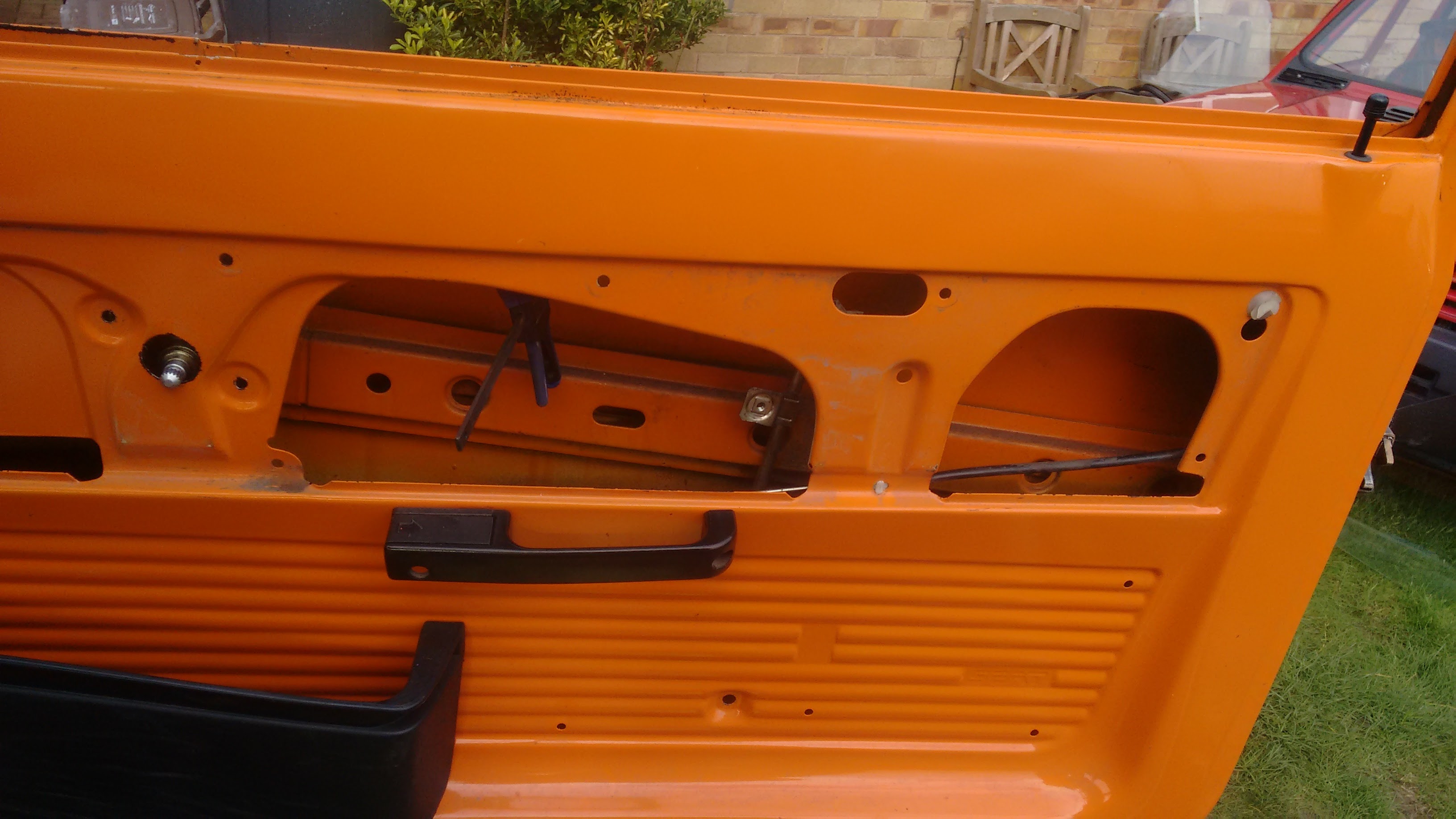

Worst bit to do was changing the door winder mechanism from Fizzle to Henry as his was missing the locking tab making the glass stick in the frame.
Luckily got away with just adjusting the passengers side.
The observant will have noticed that Henry wears Marbella doors and the drivers is different to the passenger side, unable to fit a door pocket to the offside!

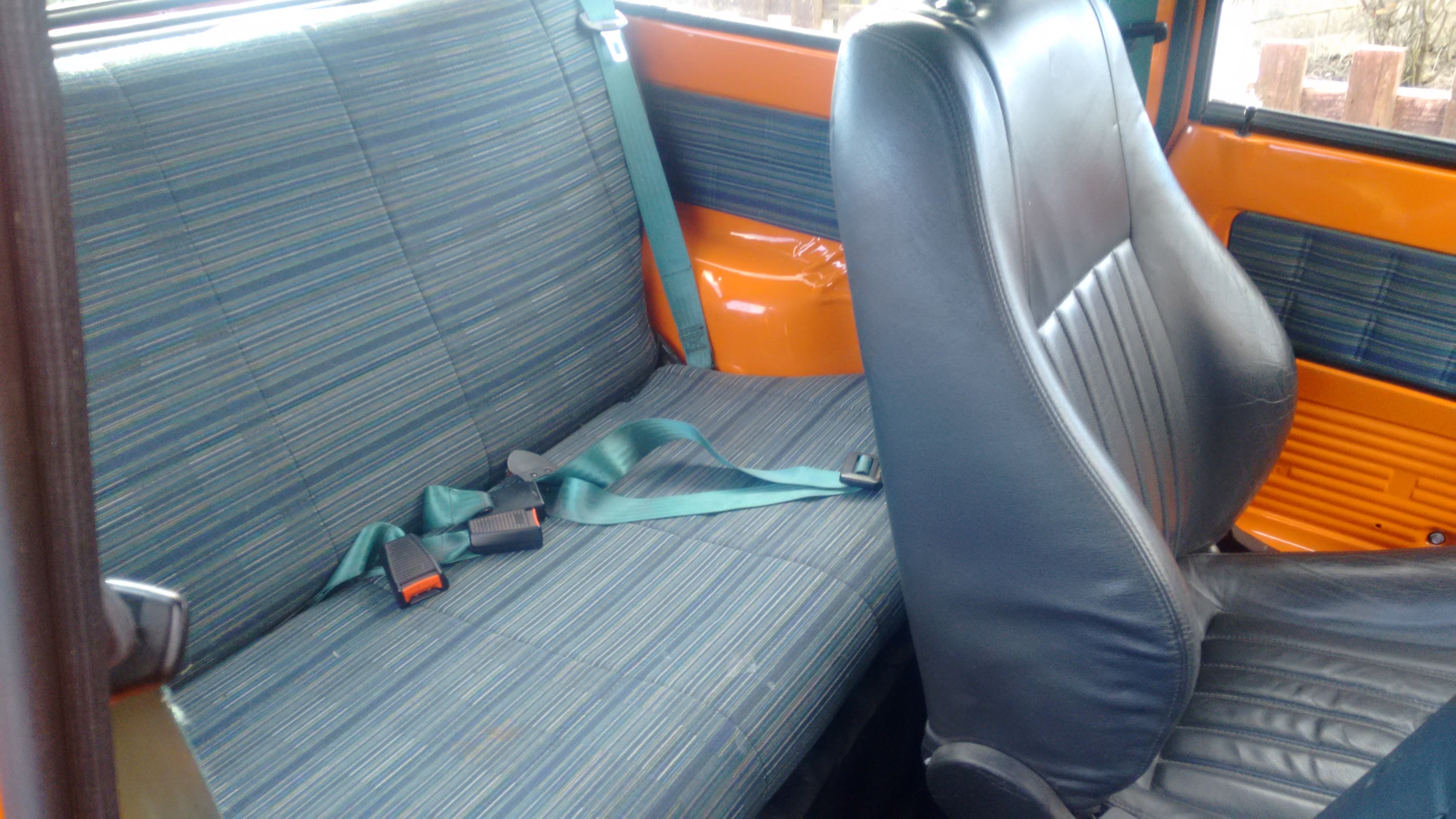

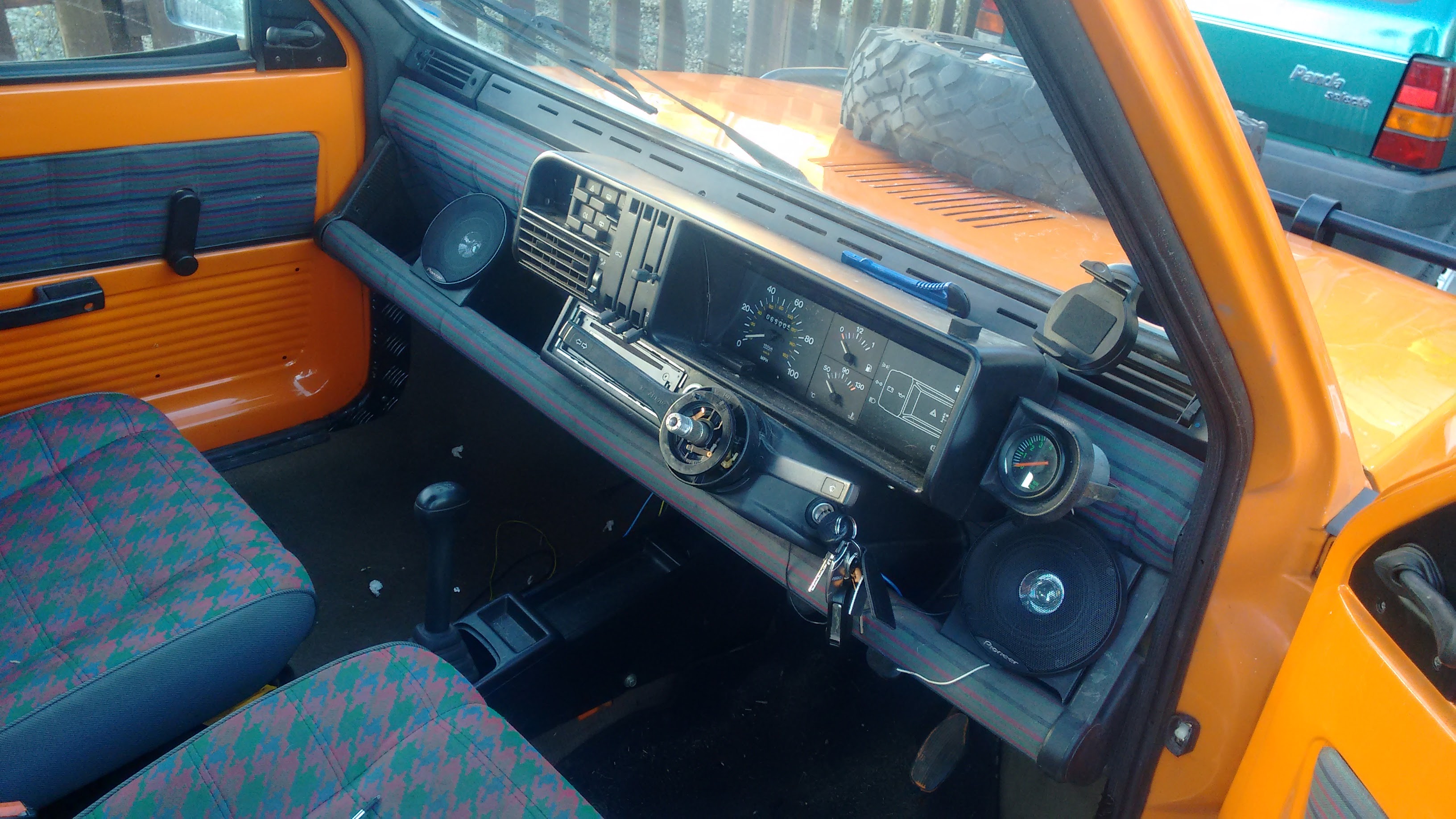

Rubber floor went in from Fizzle too who also donated the rear of the dash pod.
Rear seat and door cards came from Palio's stock and the leather Alfa seats came from mine!
The Green seat belts came from colour (who wears Fizzles grey ones).

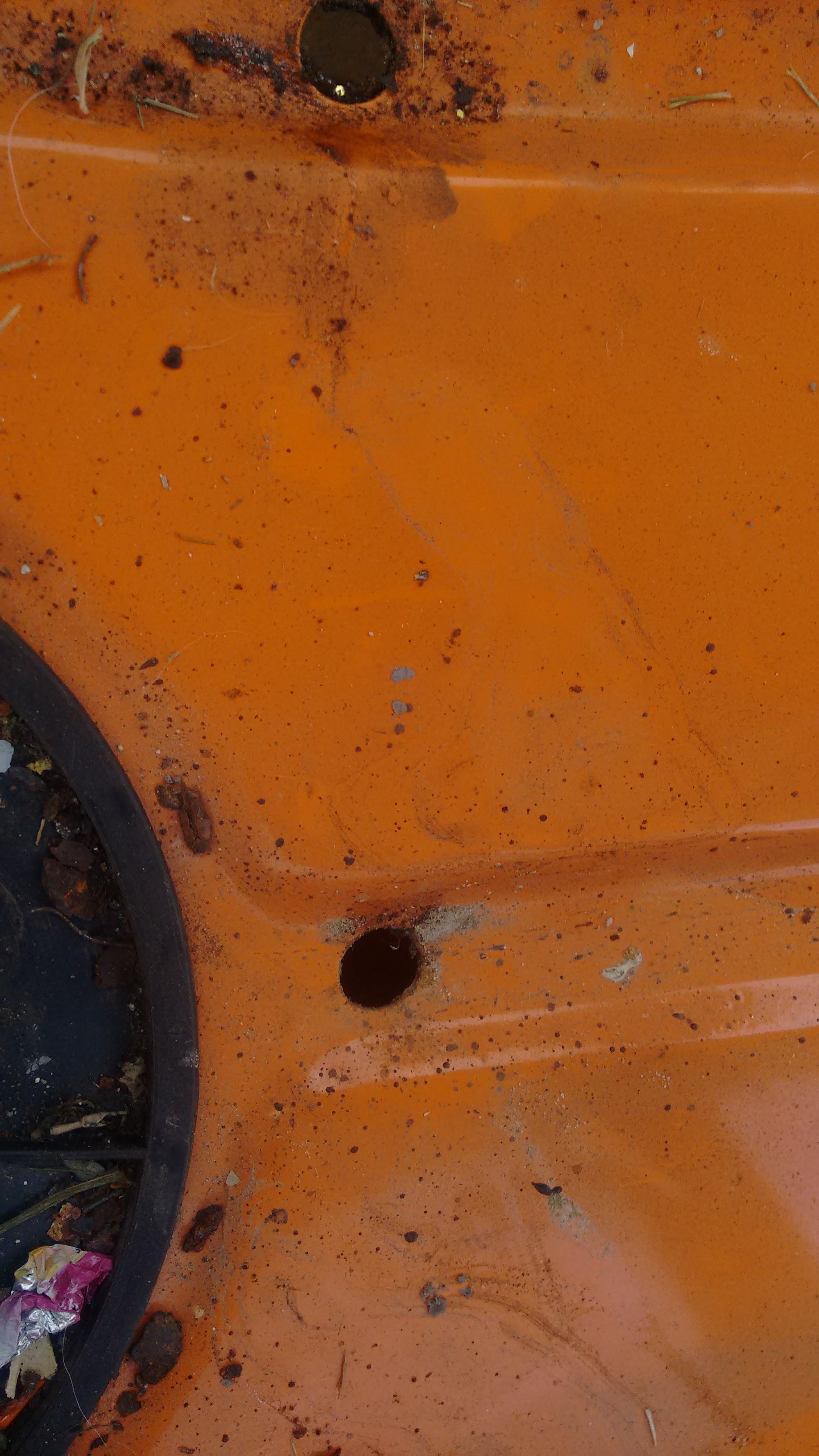

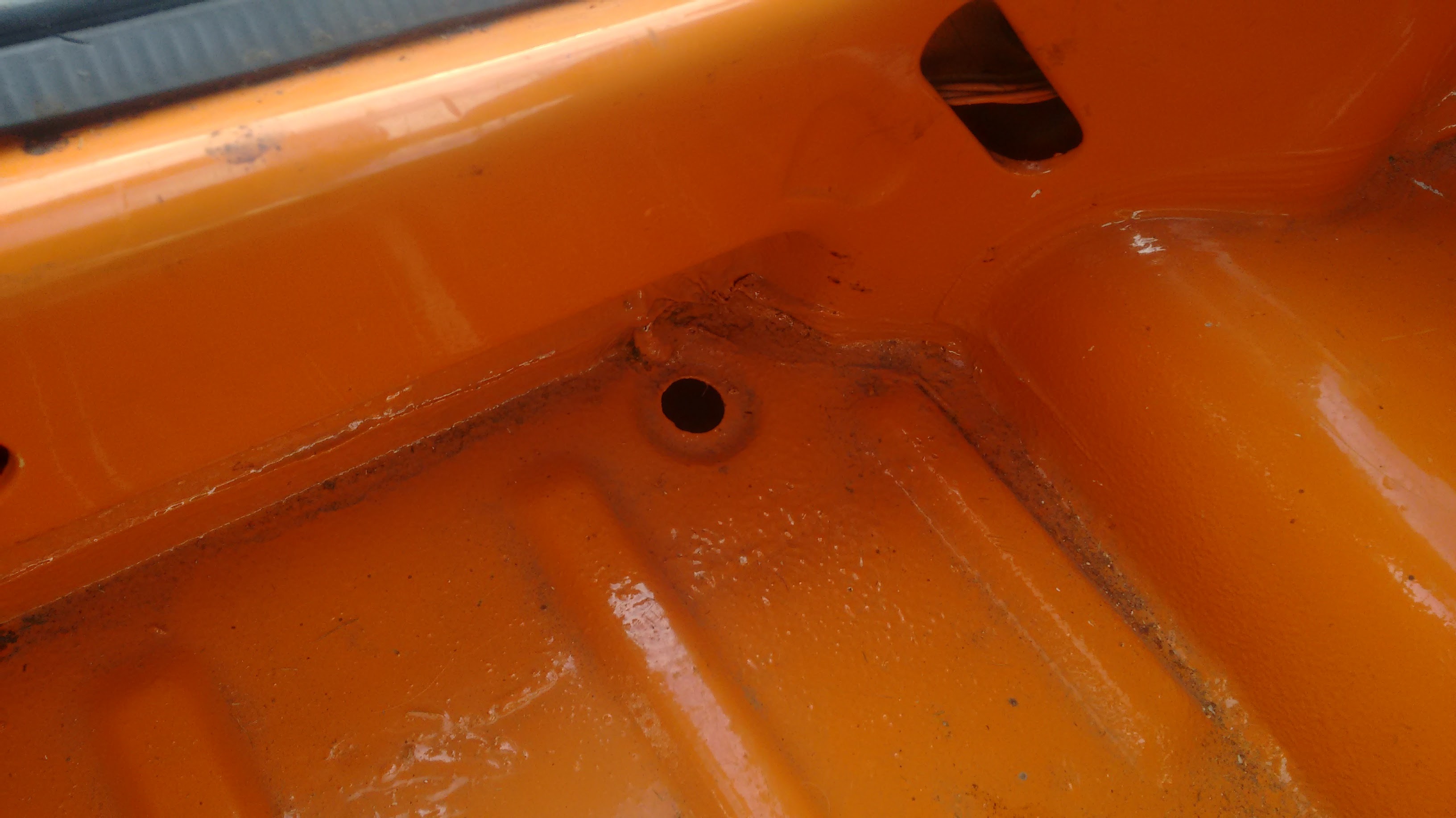

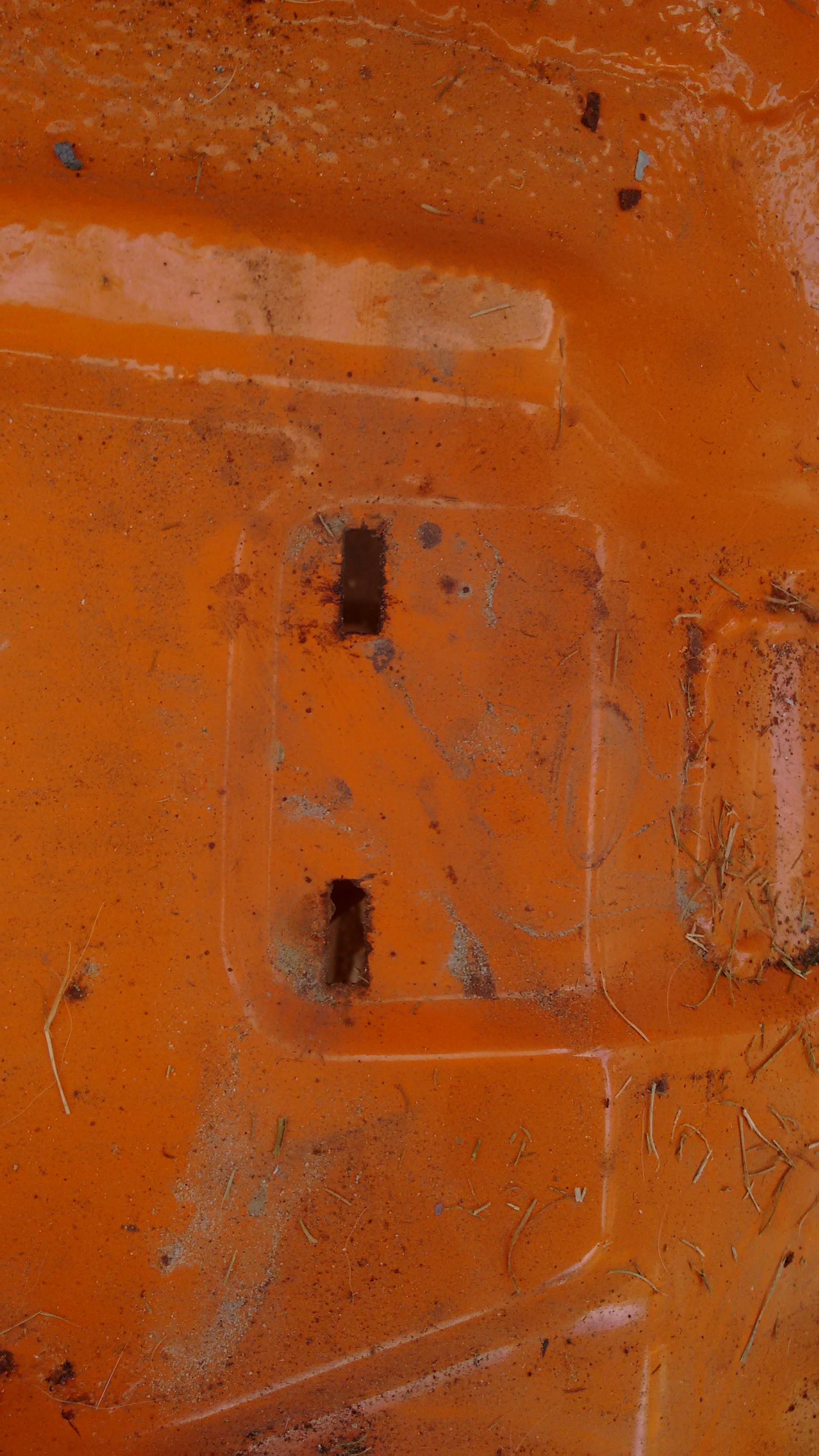

The drainage tabs throughout the car haven't been sealed since repainting, to be honest I'm going to keep them open as they are natural drainage points if the car ever does get flooded. The downside to this is a little water enters the car and sits under the driver and passengers foot mat position but so far nothing more than discolouration to the paint, I'll get it sorted out when the weather gets warmer though.
The cloth Alfa seats wouldn't fit due to the bases being slightly bigger thus the gears couldn't be engaged.
I swapped the frames and subframes onto the leather seats which fit perfectly, the drivers seat will also adjust up if I want to rub my head on the roof!

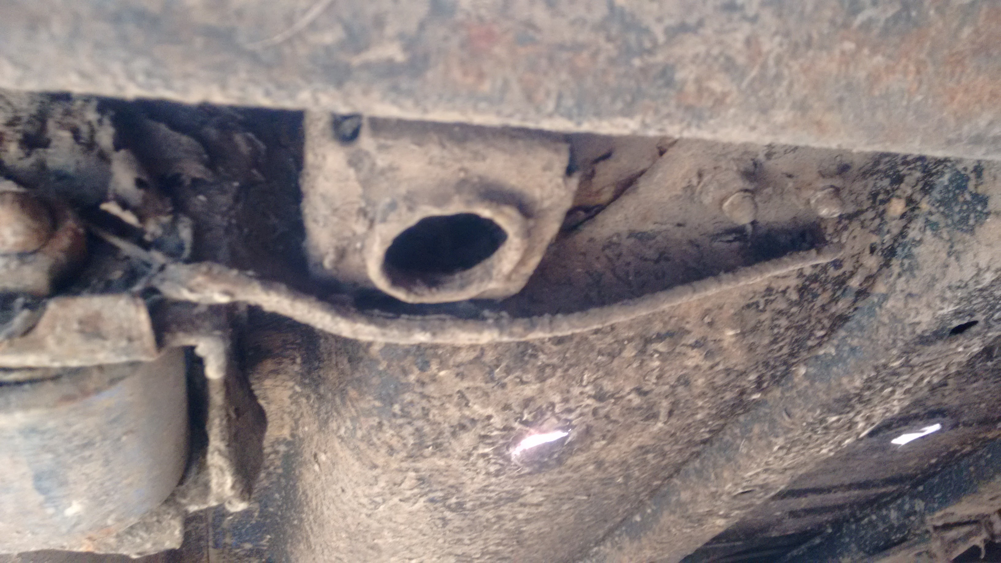

It took four long afternoons to do the interior swap and annoyingly one of the exhaust mountings was attached to the rear seat belt mounting via a long bolt which came off during the changes, as it's a two man job I had to cable tie the exhaust for now.

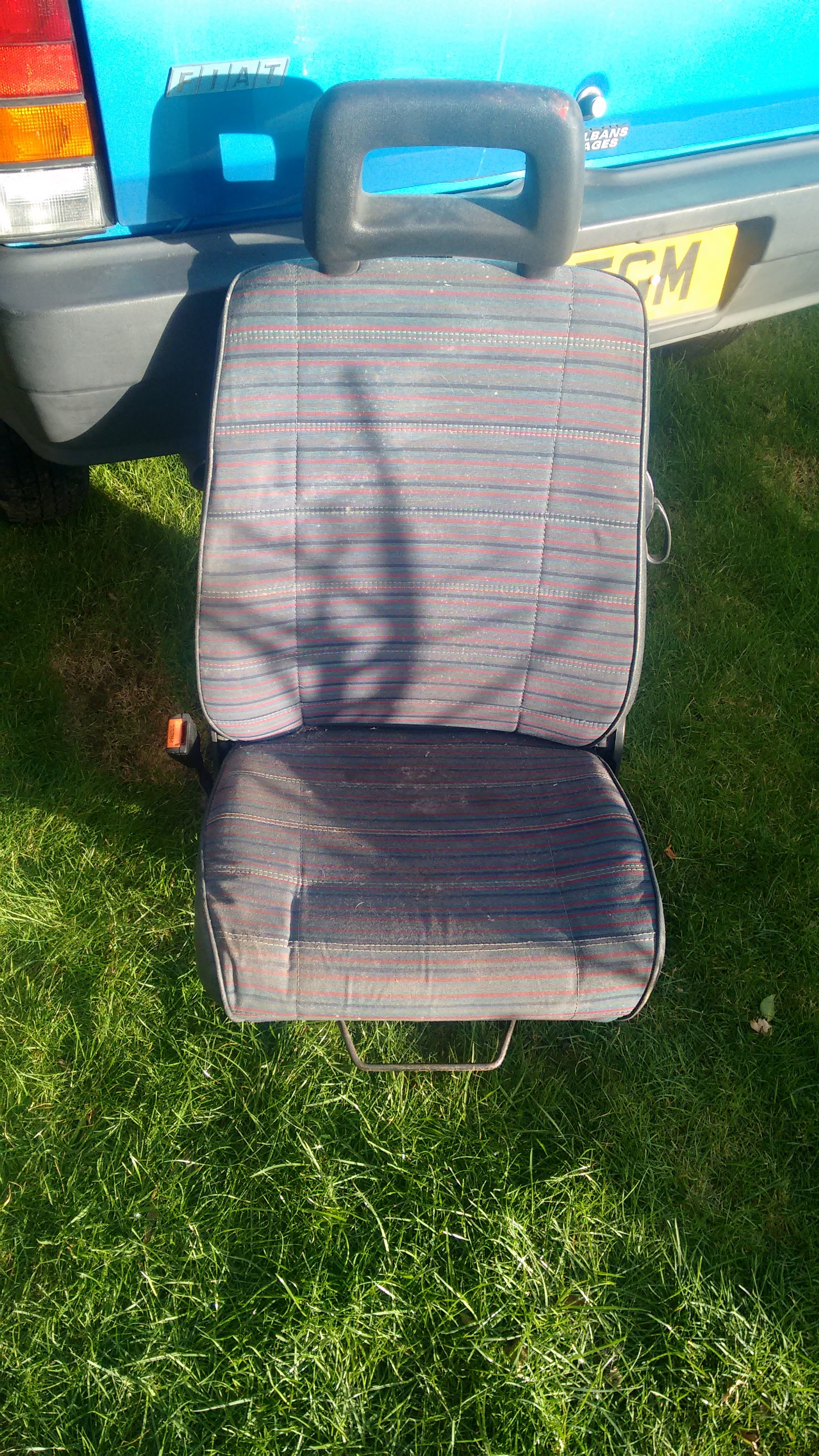

I now have a complete interior including seats of the black stripe type if anyone wants it, scruffy but should clean up well if anyone wants it.
Also if anyone wants two front seats from the colour they are going begging too.
