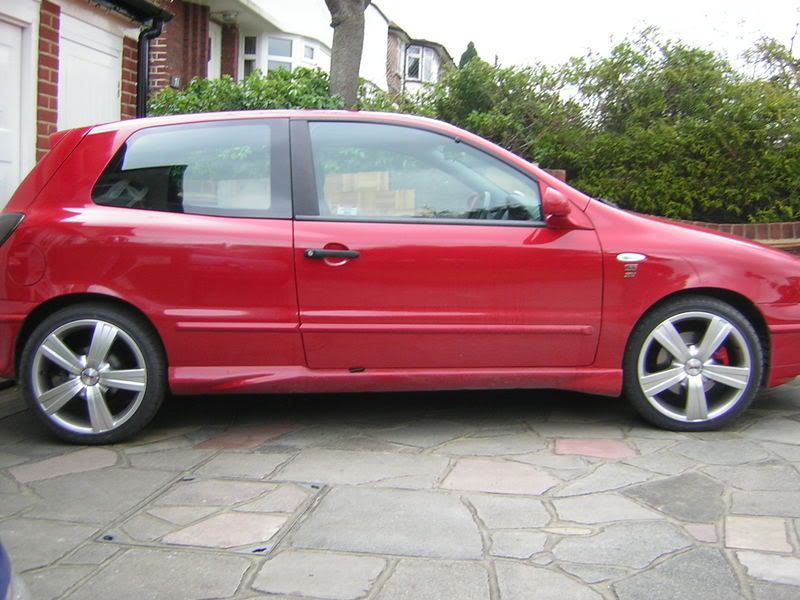

hi, ive bought some 17s for my bravo but its sitting quite high(see pics), can anyone tell me how much i should get it lowered so that theres an equal clearance between the wheel and arch all the way round ish? as you can tell i know nothing about it, i live in London se9 does anyone know anywhere roung here who can do it, if so how much?
thanks in advance
On mine I found 35mm made the wheels fit the arches perfectly. However as your is an HGT, it may be slightly lower already, but as 35mm is the smallest lowering I've seen, it should have the same results.

PI lowering springs go 35mm. All four springs for £99 on Ebay.
Joske
could anyone tell me if i was to buy a set of lowering springs, would this be all i would need or would i need to buy other stuff aswell- shocks etc...
You don't need new shocks if your lowering to 40mm. Anything greater than people advise you too by new shocks.
I have PI lowering springs and its lowered 35mm. The shockers are original Fiat Ones.
Joske
is yours a hgt? are the springs the same on all models? would 35mm be ok on this one do you thing??
cheers
I own a 1.9 JTD HLX. I would say its fine on the HGT 35mm.
Joske
Dosn't look that bad. My hgt sat a lot higer than that, you could almost walk under it ;)
