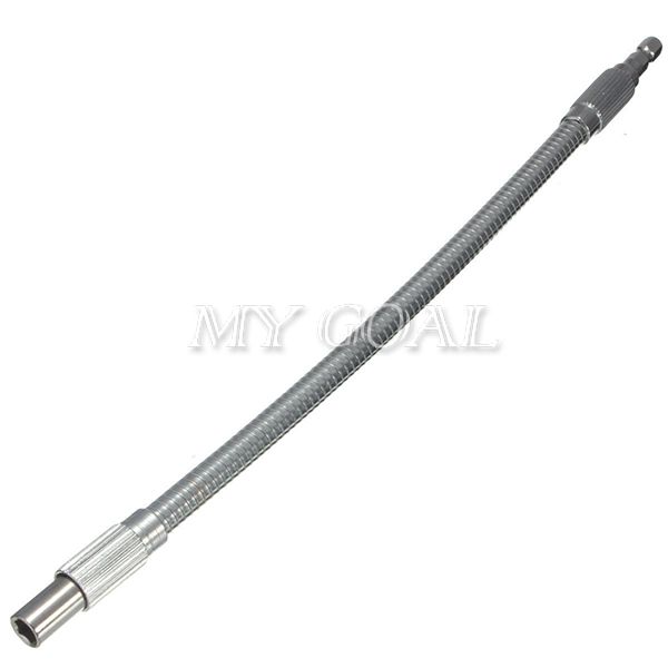

You can get the screw with a right angle screwdriver or a flex adapter.
