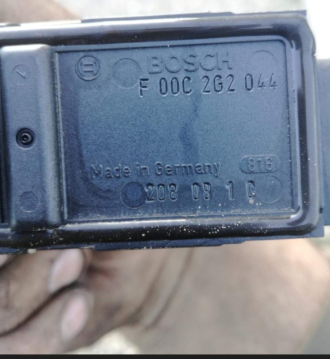

Hey. I have a one question from you guys. I have to change my maf sensor (fiat doblo 1.9jtd 74kw 2002) but I'm not sure that maf sensor of my car is with original number.
I'm try several used maf sensor but none of them are not working. So I am thinking , maybe is previous owner change maf sensor from another car.
Maf on my cars Is currently is this (on picture)
How and where I can Check original sensor for my car?
Easiest way is to put your registration number into Halfords or euros and see what comes up for that engine. Each manufacturer will have a variation on parts but it should give you a reference point.

Use eper to find the fiat part number then Google the fiat number-look at images-I think you will find part number may be correct

Thank you, I will try with Eper.i didn't use a Eper, when I type Vin number, It should show me the sensor with the original number?

I tried new Pierburg maf (722701080) and bosch (0281002309)and nothing... With pierburg max value is 400 mg on full thortle, and with bosch is always 6000mg... So I am not sure what is problem...
