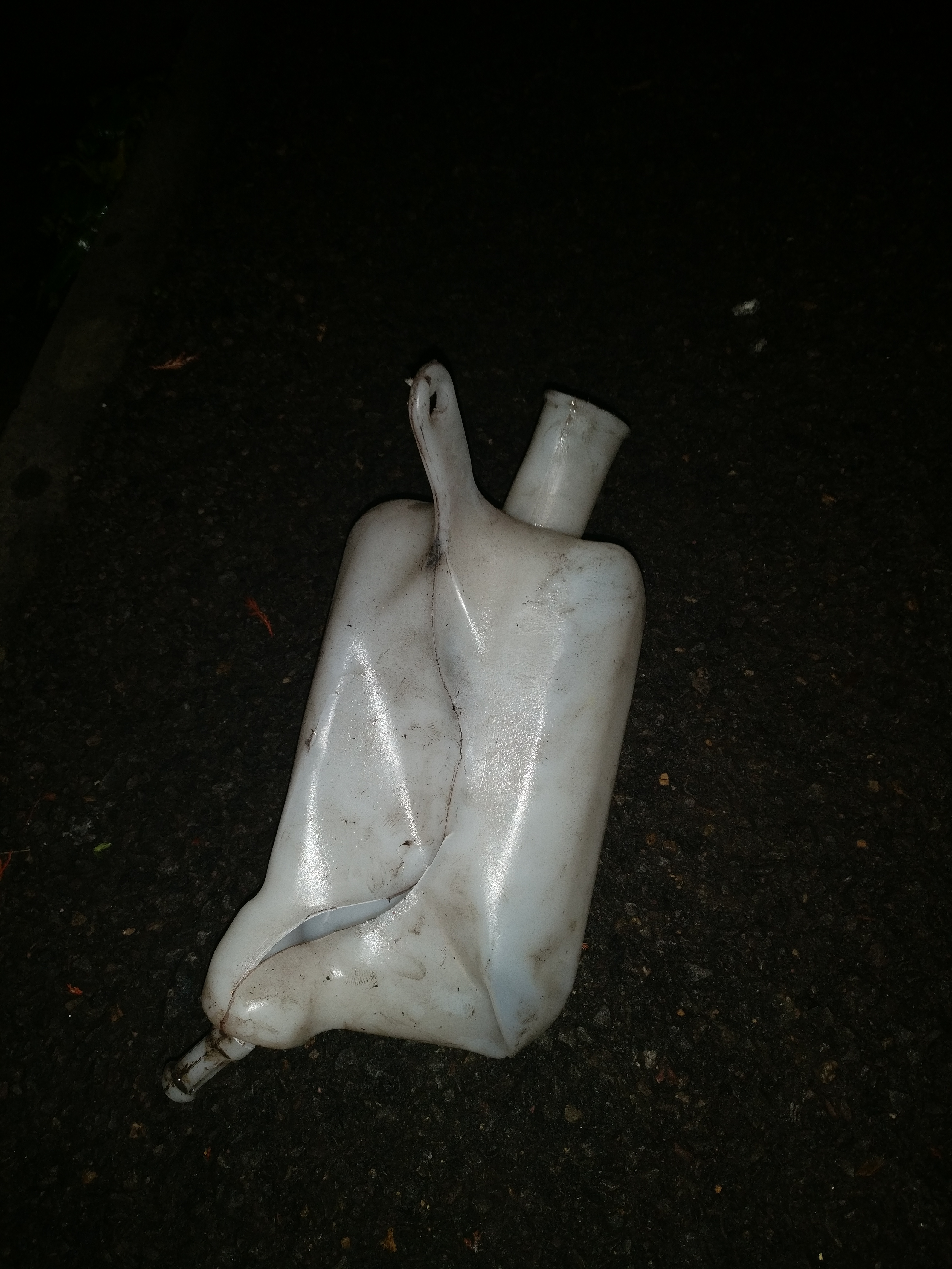

Hello Guys,
Just had a little accident nothing orrible just trying to
repair my punto mk2 now.
I got all the parts i need except one, there is a tank under
the front headlight in the right side of the car that i can't find anywere.
Tbh i don't even now how it's called, i reckon it's for recover cooling liquid when exceeds or something.
I've attached a photo of the tank so maybe it's more clear and easy to understand what i need.
Anyone knows more about that ?
thanks in advance

Sorry guys i might have not been clear in my explanation. I'm sure it is not the screen washer tank,because it is located in the opposite side of the car. This one is located underneath the front headlight on the driver side, on the left side of the radiator if you are facing the engine compartment.
The tank looks quite clean inside. Was there any residue of its contents, if so, what sort of liquid was it and what colour?
There is a large connection at one end, a smaller one at the other. Are there any others? Where does the other end of each connected hose go?

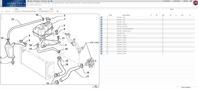

Item 3 in the below picture, p/n 46751354:
http://www.ebay.com/itm/46751354-FLUID-COOLER-FIAT-PUNTO-VAN-1999-/360667581952?hash=item53f9768e00
Unless the tank has an internal tube to the bottom, to bring any overflow back in as the system cools, it is just a waste catch tank. Any suitable plastic bottle will do. Stick a tube into an old drinks bottle and cable-tie it in place. Or just run a tube down and let it drip under the car.
