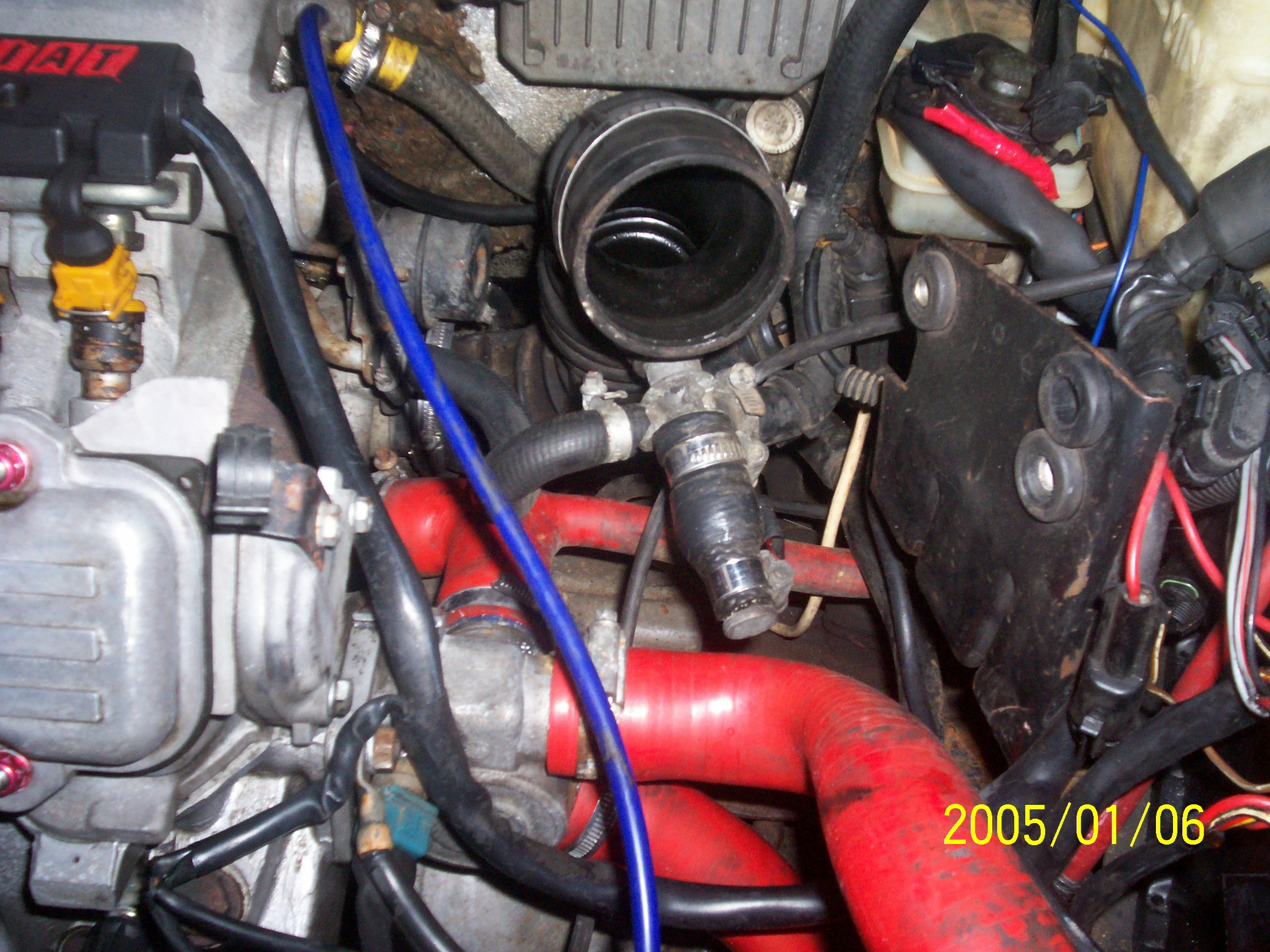

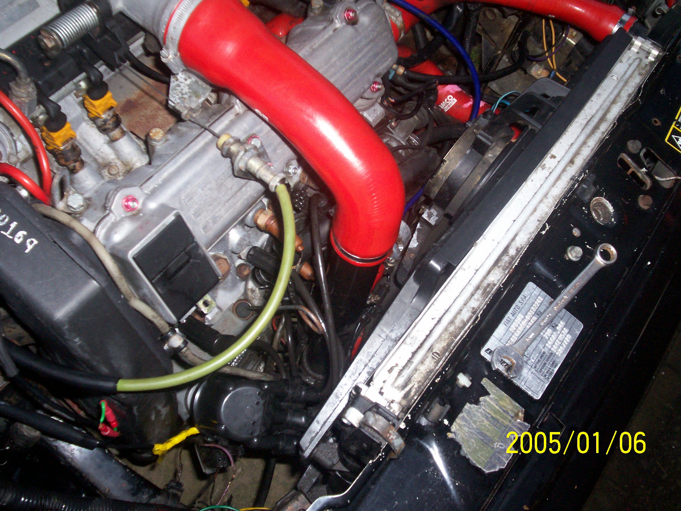

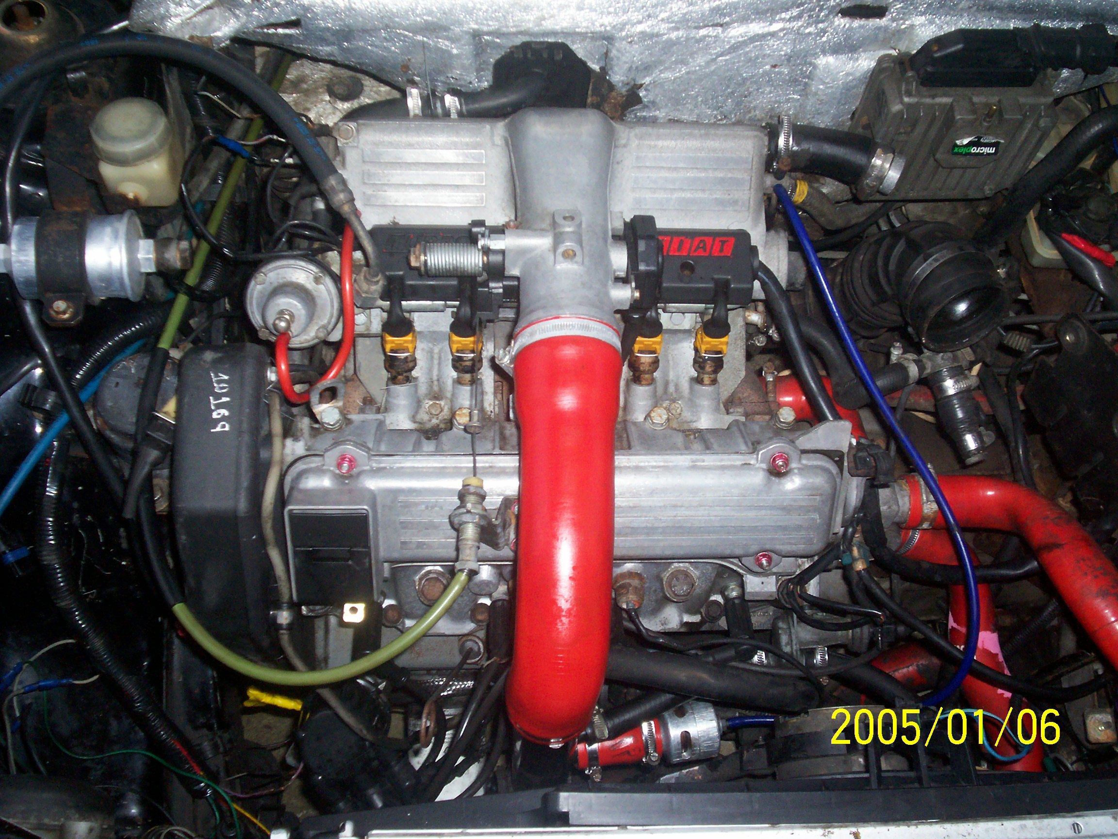

hear is some pics taken the plugs out today and thay are black think it means its rich ?any ider do any one now what the blue pipe went to ? in pic6

mate i will get you some pics of mine tomorrow and you can see where your pipes go:D
