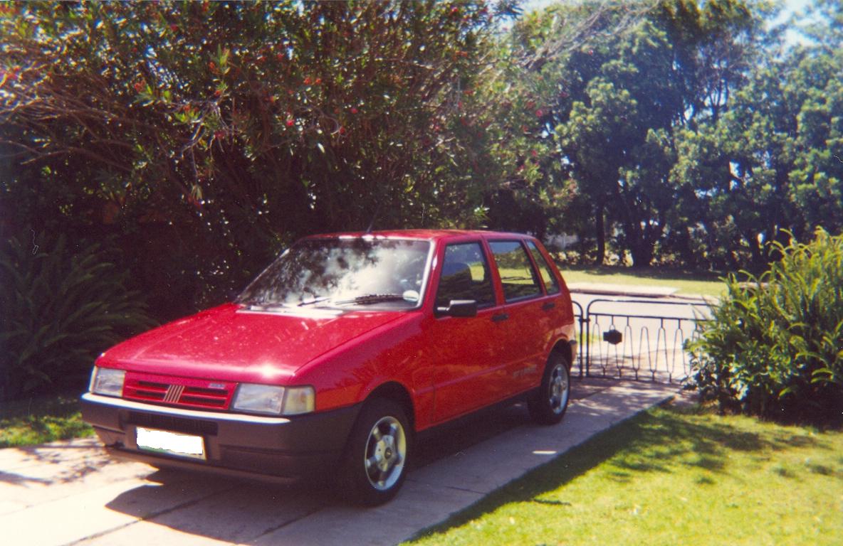

Thank you :D My dad got some stuff to make it all nice again. Got it from someone that works at a car paint shop. I have seen the results of this before, we had a Ford Cortina also same red as the uno, was very faded like orange. After all the buffing and stuff that Cortina came to a nice finish, cherry red. I will keep you posted on the progress, and will attach some photos. Here are some of how she looked when we got her. Nice hey! (sorry about the quality) ;)
