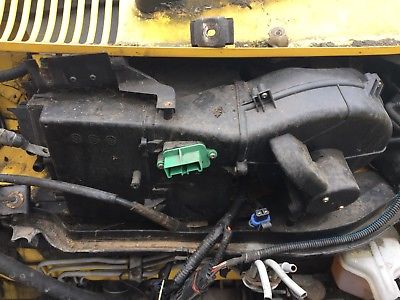

I've found a pic of a Seicento heater.
It is easier than the Cinquecento, no need to remove the heater unit to get to the resistor, it is the green bit on the front of the heater in the attached pic.
You'll see it as soon as you remove the trim panel in the engine bay.

Mate i want to send you a Christmas card!!!! How the heck did you find that pic??? I wouldn't have found out where to look in a million years!!!
My first thought was to clean up the pins on the resistor, but i think i'll just order a brand new one and replace it...
I'll let you know how it all panned out... And maybe make a small guide for those who also need help figuring this out.
