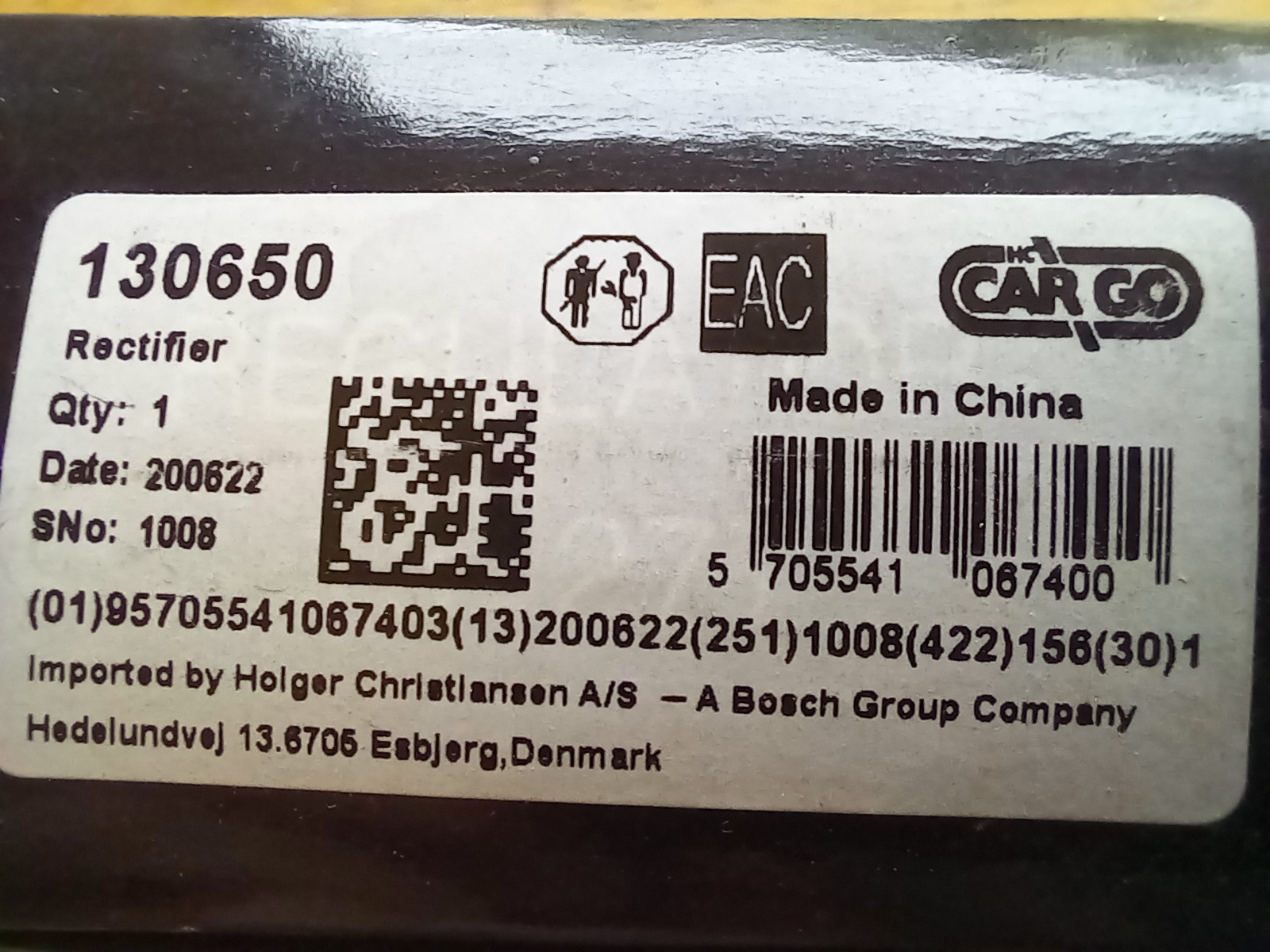

You have me wondering about the diode pack. Is this a replaceable part? Thanks!

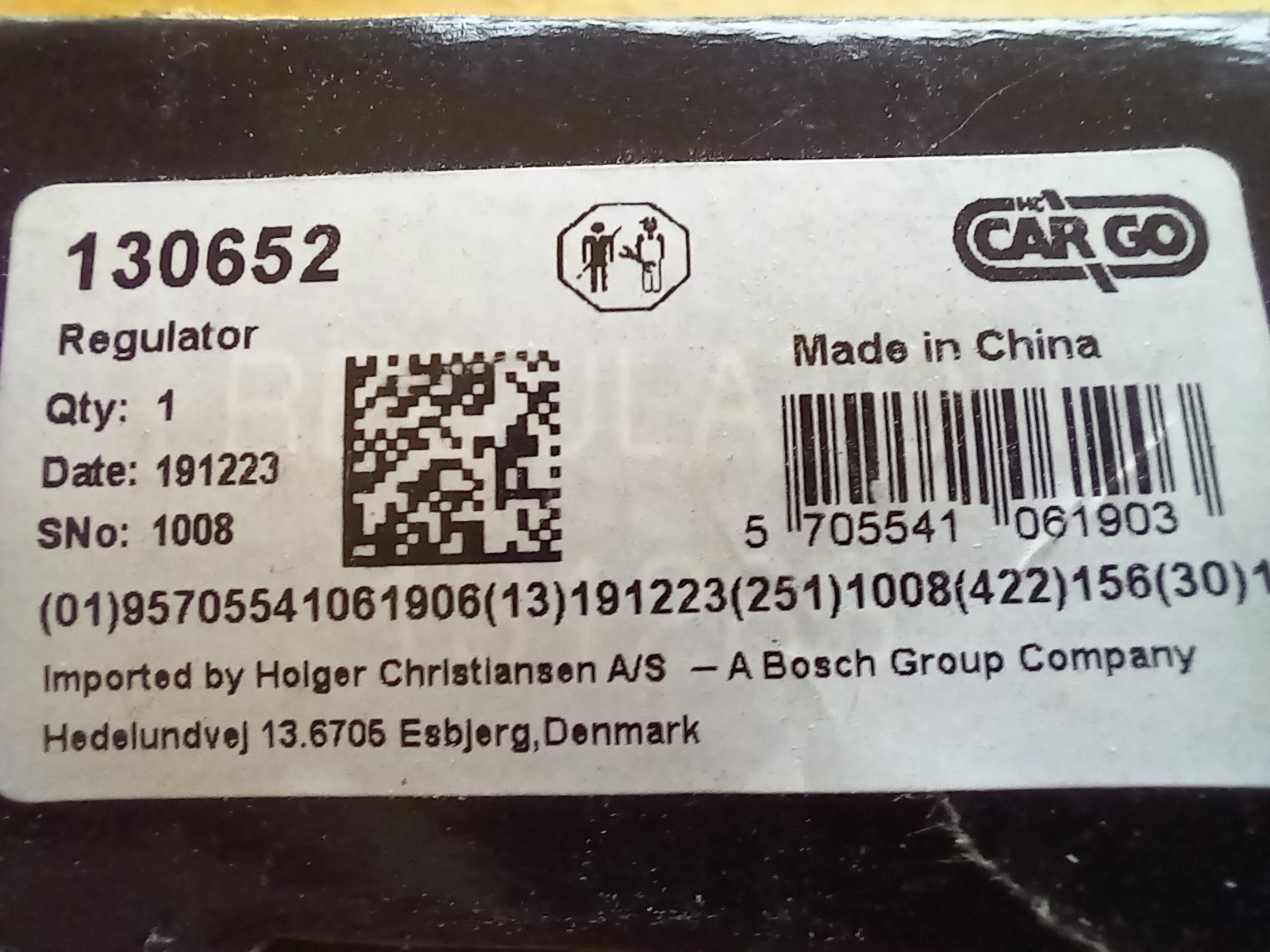

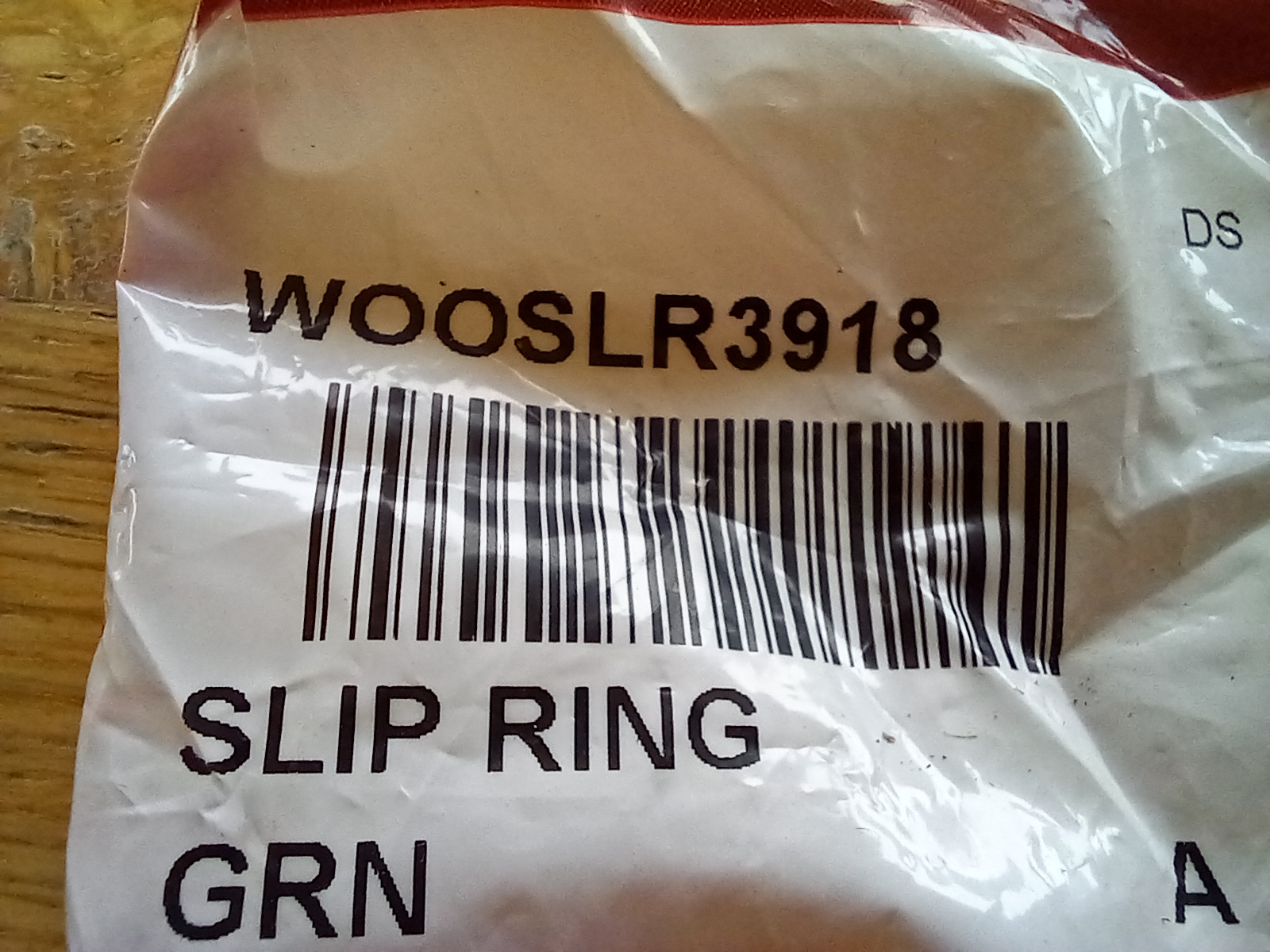

I've mis-named it; the whole assembly is called "the rectifier". I was able to track one down when I bought a selection of parts for the alternator. The images of the labelled boxes are self-explanatory. I think the company I got them from was Wood Automotive. They were very helpful, but I guess not really set up for small orders like ours.
I've mis-named it; the whole assembly is caled "the rectifier". I was able to track one down when I bought a selection of parts for the alternator. The images of the labelled boxes are self-explanatory. I think the company I got them from was Wood Automotive. They were very helpful, but I guess not really set up for small orders like ours.
View attachment 449825View attachment 449822
Bless you my friend! I'll be researching these ASAP. Thank you so much for the info!!
