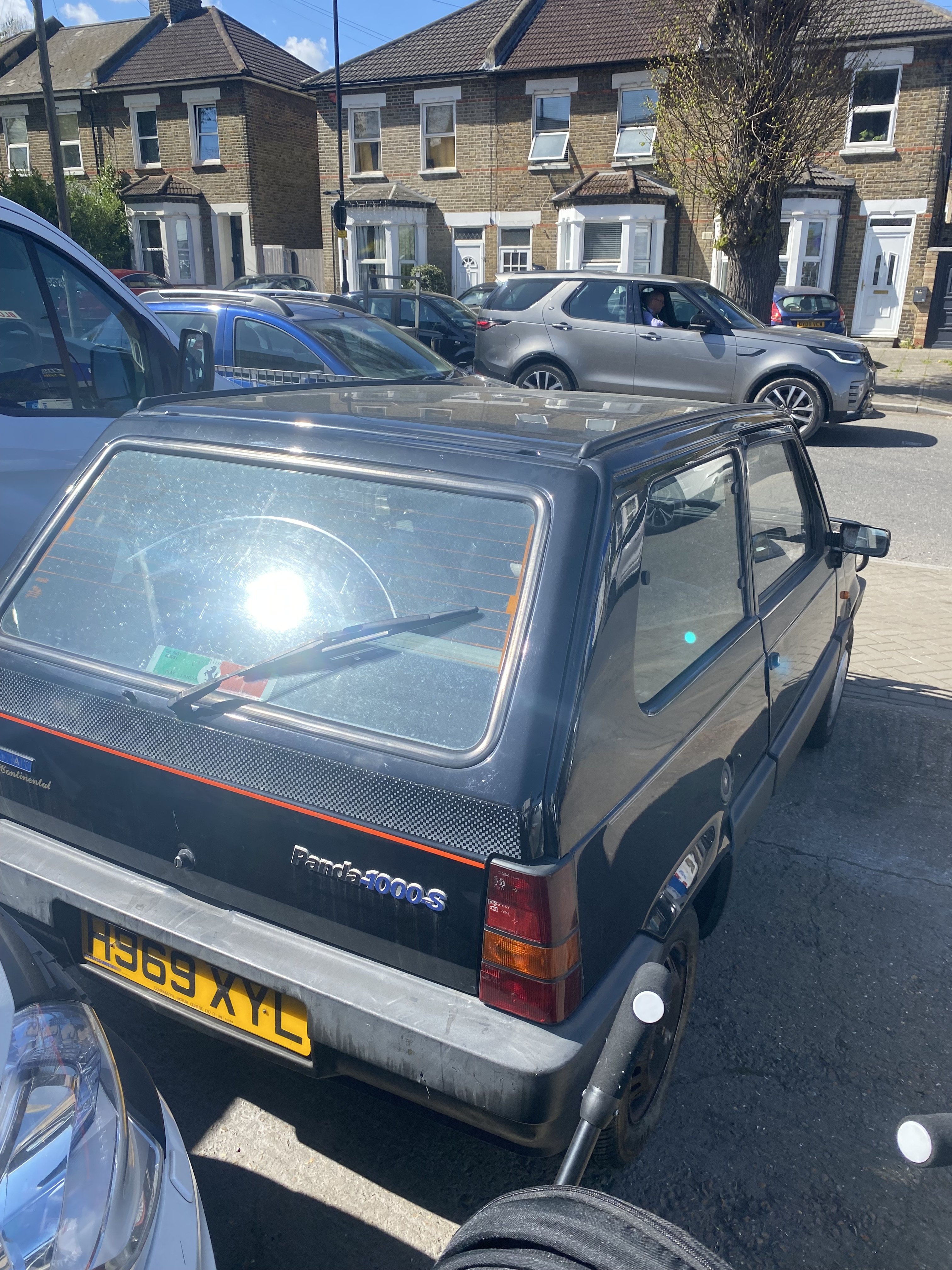

Hi, I came across this Fiat Panda 1000 S at my local dealership. Had to stop and take a look having just come back from Italy and lusting over their motors. Is it a sign? Price is 3k and they're willing to take my 2006 panda as part exchange. As an absolute novice but lover of old Pandas, does this sound like a lot? Mileage is 112,861 miles...
Best to avoid or opportunity to invest in a classic? Any help appreciated. Thanks
