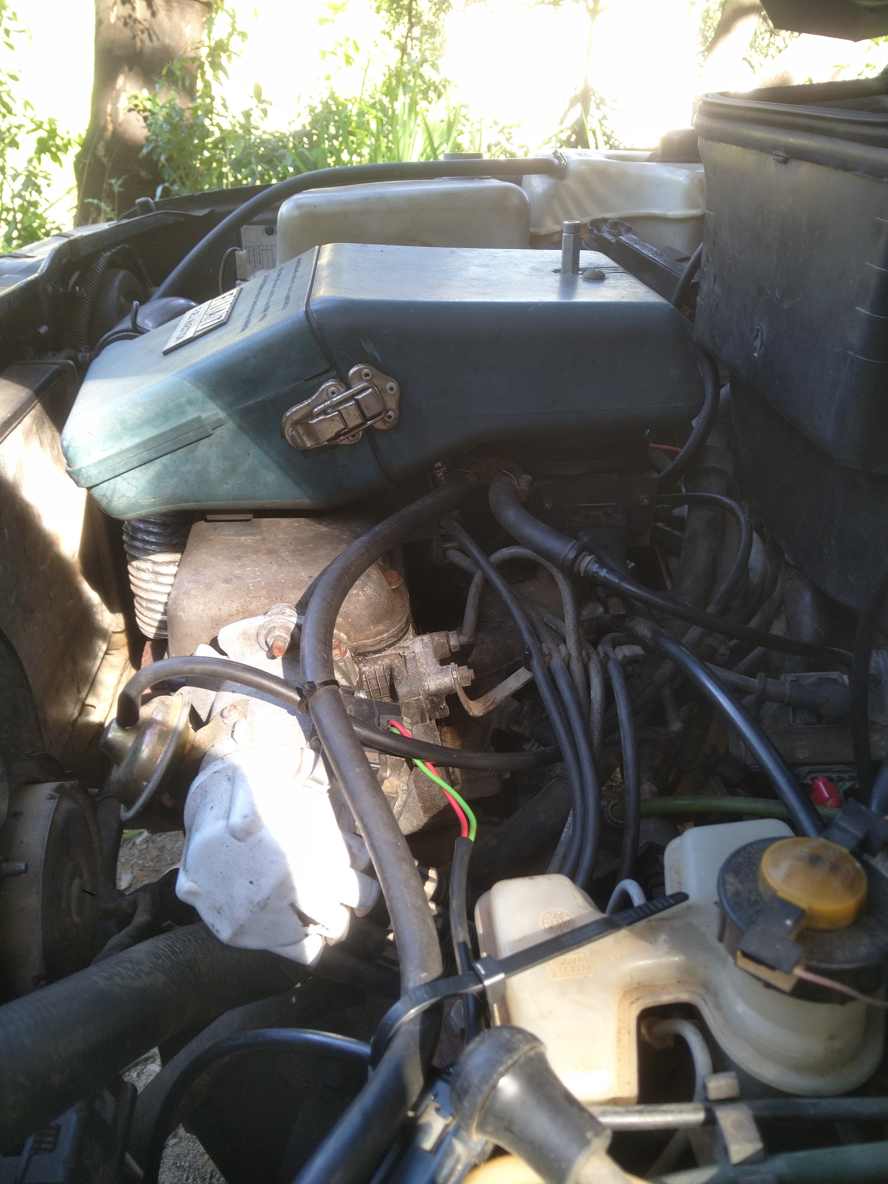

Okee dokee here are some pics, and some questions if anyone could spare an eye. I have deduced the white circled part is the vapour control valve, the hose is not currently connected to anything. The back of the Bosch SPI body has 3x ports (also ringed white in t'other photo) top of pic is connected to air intake (engine hose) middle of pic is connected to to vacuum advance, and bottom of pick is currently plugged off. I am assuming the vapour hose should have been connected here? And also assuming all 3x connections are vacuum connections, not working independantly in any way?

Unfortunately my manuals have all been put into storage and I’m a long way from them…however, although the 4x4 1100spi is not included in them, as it was never sold here, the evap system is the same as the panda selector. So, in the absence of me being able to post pics or comment, hopefully one of the guys with one can take some pics or upload the manual?!?

i have this full system in my shed. they put it on the Fiat Uno here in the UK. i ran it on Talon a while back however the idle control stepper motor failed so i converted it back to carb.
its a strange system, not using a crank position sensor instead going of the points/ignition modules output to the coil. heh i still have the lambda sensor in the exhaust on Talon not connected to anything, just plugging the hole. i may look into getting a new idle control motor thing again at some point and sticking it all back on. it worked good in the few months i had it installed.
