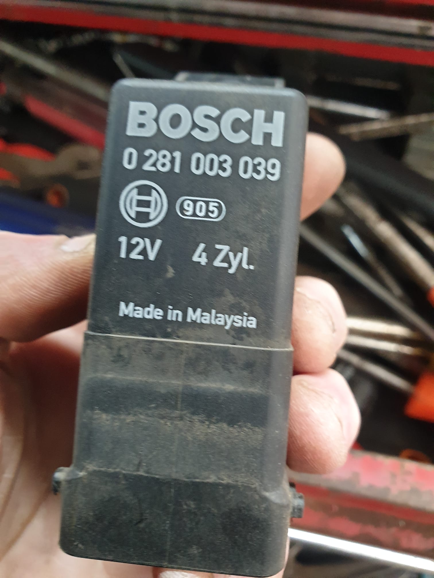

Relay is clicking on and off straight away and no reading at glow plug.
Please post picture of relay showing any part numbers on the relay
Thanks for that picture.
I don't know for sure but I have a strong feeling that part is a stand alone glow plug controller not just a simple relay.
Search using the Bosch part number and you can find a genuine Bosch part for around £40 with free delivery.
I expect you have already Checked glow plug fuse/fuses and that none of the glow plugs has gone short circuit. If those checks all ok replace the Bosch 0281003039.
The Bosch 0281003039 is readily available so I expect there is a demand for replacements indicating they do fail.
Please let us know how you get on.

Took the cover off the relay and pushed the points together for 10 seconds and let go off them then started the van
New or used relay/controler?
Is there a small pcb inside the cover?
Run a good good temporary extra ground to the correct pin on the relay/controler and test.
