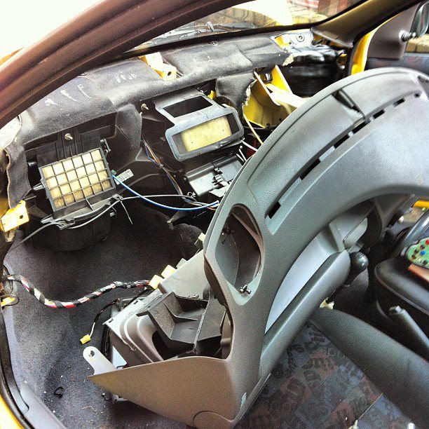

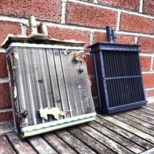

Thought I would jump this thread with my experiences of changing the heater matrix.
Took me around 6 hours of work over 2 days. The majority of that time was actually getting to the heater matrix. Once swapped, it all went back together in about an hour.
I decided to follow the Haynes manual procedure along with my gut instinct. Haynes was both useful and totally confusing at the same time. I often had to hunt for hidden bolts which Haynes made no mention of. Haynes also said you need to remove the steering wheel. You don't. No need to at all.
I also decided to remove the dash totally out of the car rather than just bringing it forward a bit. Without removing the dash, the job would have been a nightmare. I found the the leaking coolant had acted as a glue with the sound deadening, fusing the heater assembly into the car. It required a lot of leverage to prise it off of the bulkhead.
Once out, swapping the matrix is simple. The assembly then drops back into place and getting the dash back in is straight forward enough. The wiring looks daunting but each connector will only fit it's specific hole so can't go wrong really.
I've attached a few piccies. I didn't document it or anything but it's not every day you see a car with its dash ripped out!

Great job there Chris! Looks like it took you about the same amount of time to do this. I can say it's nice once it's finished.
