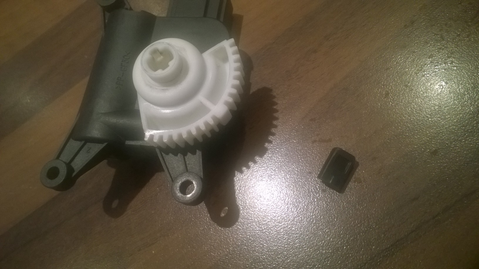

Hi - relative newbie - Fiat 500 1.2 Lounge 08
Heater cold! Thanks to forum I have tracked it down the actuator and the blend door?? After two days I managed to get the actuator off, I found it down by the clutch. Inside the white gear was a broken bit of black plastic which I assume would have been attached to the hot air blend door inside the heater assembly?
What now? There is absolutely no space to work so I cannot see how to mend the door.
Is this a complete dash out job - is that even possible are there any guides? Looks like I need to move plastic and metal. I have watched the video of the guy who pops his heater controls out- but I think I have got to go much further than that.
If I did get to the heater unit, can I effect a repair - or do I need to buys a new one?
I'd appreciate a hand here - I'm well out of my depth!

Thanks for the offer. The manual arriver todzy. It speaks about aircon discharge, steering column out, doors off, gear selection out. So annoying for 1cm of broken plastic.
You can also download eLearn, the official Fiat workshop documentation, from the downloads section - it describes the process in some detail. It's a full day's work, and definitely not for the faint-hearted! And even when you've got it out, sourcing a replacement part might not be easy as IIRC Fiat only sell the heater box complete and it's stupidly expensive.
Many folks faced with this all too common issue get around it by repairing the old part - a search should pick up a couple of threads in this and the Panda section. Think small drills, a bit of strengthening wire, some good quality ABS adhesive and you'll be thinking along the right lines. The idea is to repair it in-situ and save all that dismantling.

You need to be completely comfortable working with cars to take this on, and you also need to be able to work with a degree of finesse - a heavy handed approach will practically guarantee you'll break something. In comparison, changing a set of discs & pads would be like comparing a walk in the park to climbing Everest.

If you look back at my threads, you will find my diary if a cat C repair. There are lots of photos. Steering wheel has to come off, but no doors or column or gearstick do. It's actually not that difficult.

According to eLearn, you need to do this in order to remove the fascia support beam.
I'd recommend anyone contemplating this job to download a copy of eLearn (it's in the downloads section) and read the relevant procedure descriptions. The amount of work involved is almost unbelieveable; a home mechanic doing this for the first time could easily find it's a week's work, and you'll need specialst help with stuff like discharging and recharging the A/C system.

Oh I see, yes. When you open the door, there is a bolt on the A pillar that connects to the cross beam, that can only be undone if you take the door off.
Ok just to clarify I have done a number of these for this problem, worked in a dealer for nearly 20 years and I'm now out on my own as a specialist. The doors have to come off so that you are able to remove the the mounting bracket that the heater box bolts to. No other way believe me I would have done it. Yes the air con needs to be drained. It is a big job but I get these done in 1 day no problem. If your anywhere near hampshire I could price the job for you? May save you a lot of hassle
