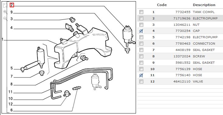

Well I have managed to buy a set of Punto GT bumpers and fitted them to my 75. However they have headlight washers and there doesn't seem anywhere to plug them in, do I need another washer tank? The piping is all there just no adapters or anywhere to plug it in.
Cheers.
I thought that, but the bore of the tube for the screen is ALOT smaller than the one for the headlights, which would make it only trickle out?
Puntos with headlamp washers have a different washer resevoir with two pumps. Headlamp pump will be much higher pressure than windscreen washer pump.

Thanks mate :) thought they might have, off to scrappy then!
