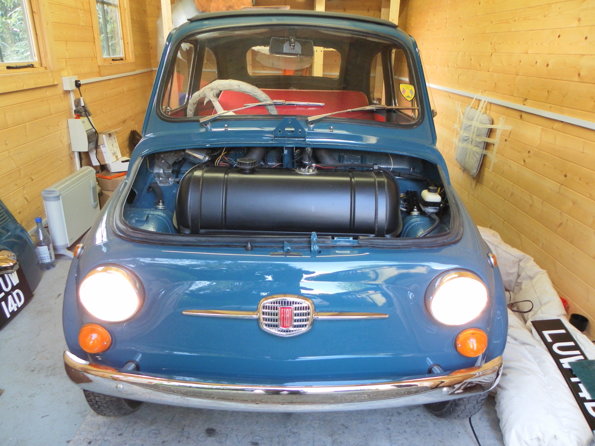

Hi Marcus they pretty much illuminate the whole reflector. Have a look at the pictures, these were me experimenting with halogen bulbs. I can’t remember if these are dipped or full beam? In the last one you can see the difference between the standard and halogen. The pattern is pretty garbage but that’s probably because I am so close to the garage doors.
I think you may struggle with those LED bulbs as they are always going to give a bias to one side over the other. You might have been better off leaving the little dish/bowl in place if it was possible?
