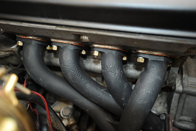

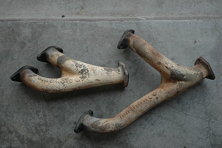

I went through this with one of my other cars a couple of years ago. I was eventually talked out of wrapping the headers and ended up getting them coated with a 'heat proof' material. The coating was done by a local Australian company called Jet-Hot (www.jet-hot.com.au) and I am very pleased with the result. I would think that similar products are available internationally.

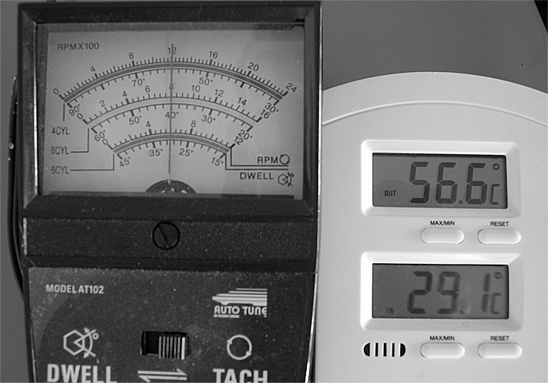

The under bonnet and on bonnet temperatures are significantly cooler. The two temperature photos were taken before and after treatment and after I'd been driving around the neighbourhood. One probe was about 10cm away from the headers and the other on the outside of the bonnet above the exhaust side of the engine. I did this out of interest only and have no affiliation with the company who did the coating.
The other two photos are just the before and after of my headers.

The headers are coated inside and out with a hard wearing and efficient ceramic insulation. It cost me $AUD210.00 in early 2008 - about 150 euros - so yeah, it is a bit expensive.
I'm sure you could do a 500 manifold, though you may have to separate the muffler from the headers first.
