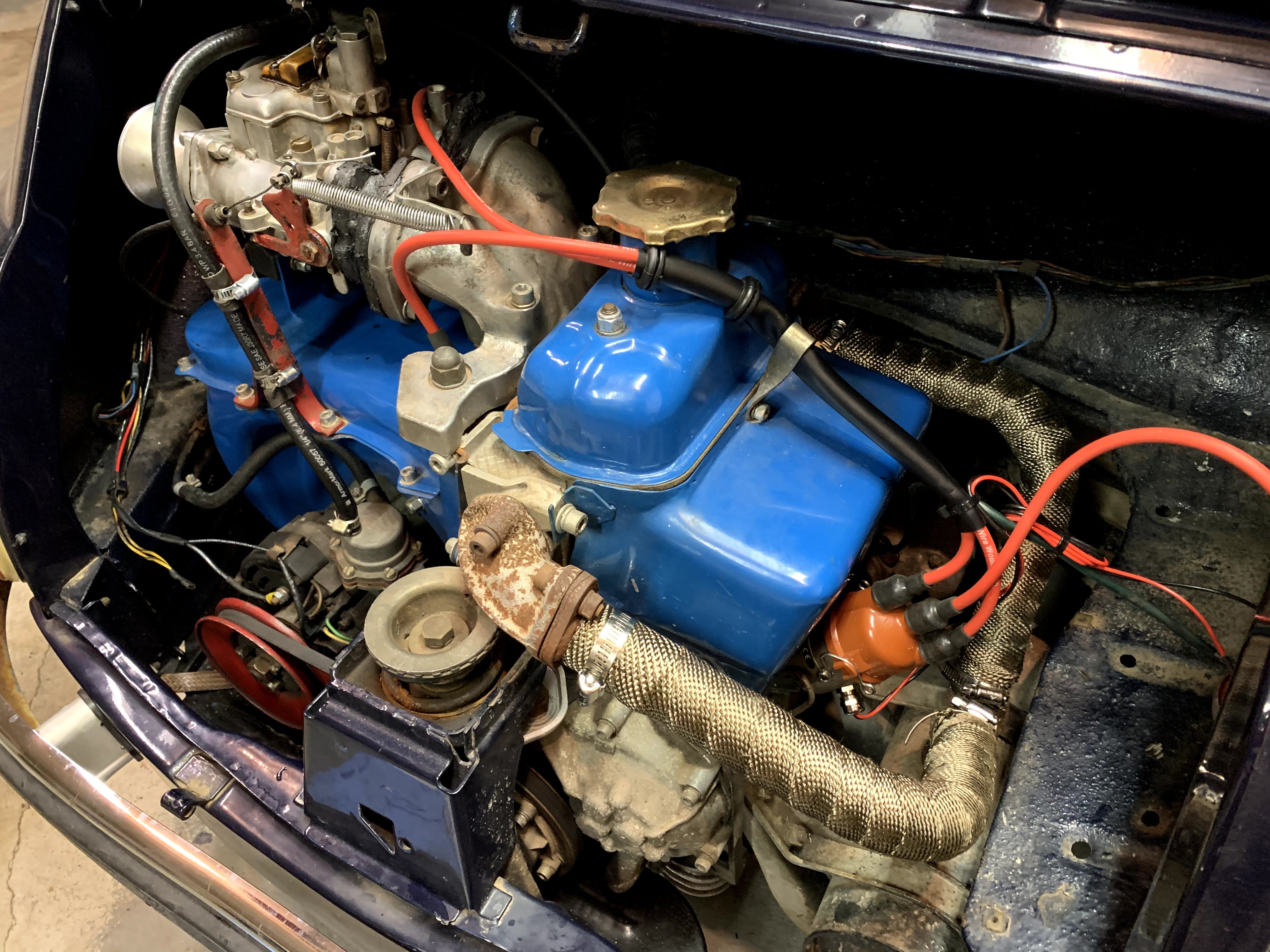

Hi ClassicFiat500,
Just recently I used a product called DEI Titanium Exhaust wrap on my exhaust pipes in effort to lower engine bay temps as I suspected they were having an impact on my engine performance (see the saga here)
As you can see in the attached photos, I didn't wrap the muffler so I can't specifically speak to that, but there was a noticeable drop is engine bay temps just wrapping the pipes. For reference I have a 650 Engine with a 123 Ignition Setup and a Dellorto DHLA40 carb.
I also mocked up a temporary heatshield that I mounted next to the coil to protect it somewhat from the head coming off the exhaust, which also led to a noticeable improvement in performance.
The biggest difference in engine bay temps for me came a few hours ago when I adjusted my valve clearances, the temperature difference was night and day!

Interesting your setup seems the same as mine the only thing is I have 123 ignition but no coil! The other one is I have an Abarth 4 litre sump with an alloy heat shield over my silencer, however I am going to raise the heat shield by 10 or 15 mm & fit a heat shield in between the silencer & the Abarth alloy one with a 5 mm gap between the two for air to pass between. Also I think it is worth fabricating an air scoop under the car blowing cold air onto the silencer.

Been considering doing the same myself. But wondered whether it was going to be effective. Comments here seem to suggest it is worth doing so I think I may go this route.
Secondary point - what engine mount is shown here? It is different to ours.
Hi SPA,
I wish I could tell you more about the engine mount as it came with the car. As far as I can tell it's the same style that was used with the Fiat 126, and was put into the help clear exhaust and mount the 650 motor that's there.
Hi SPA,
Hi Ilgrilleto - I suspect that must be the case. I was once told that you should fit a different engine mount if running a 650. They must have been referring to what you have. I haven't seen many though.
I actually hadn't seen it before I got my car, even on cars with 650s. But what you're saying makes more sense now too. Not sure if the spring in there is nearing end of life, or if by design, but the engine seems a bit bouncier than I'd like. Ah well, another thing on the list.
