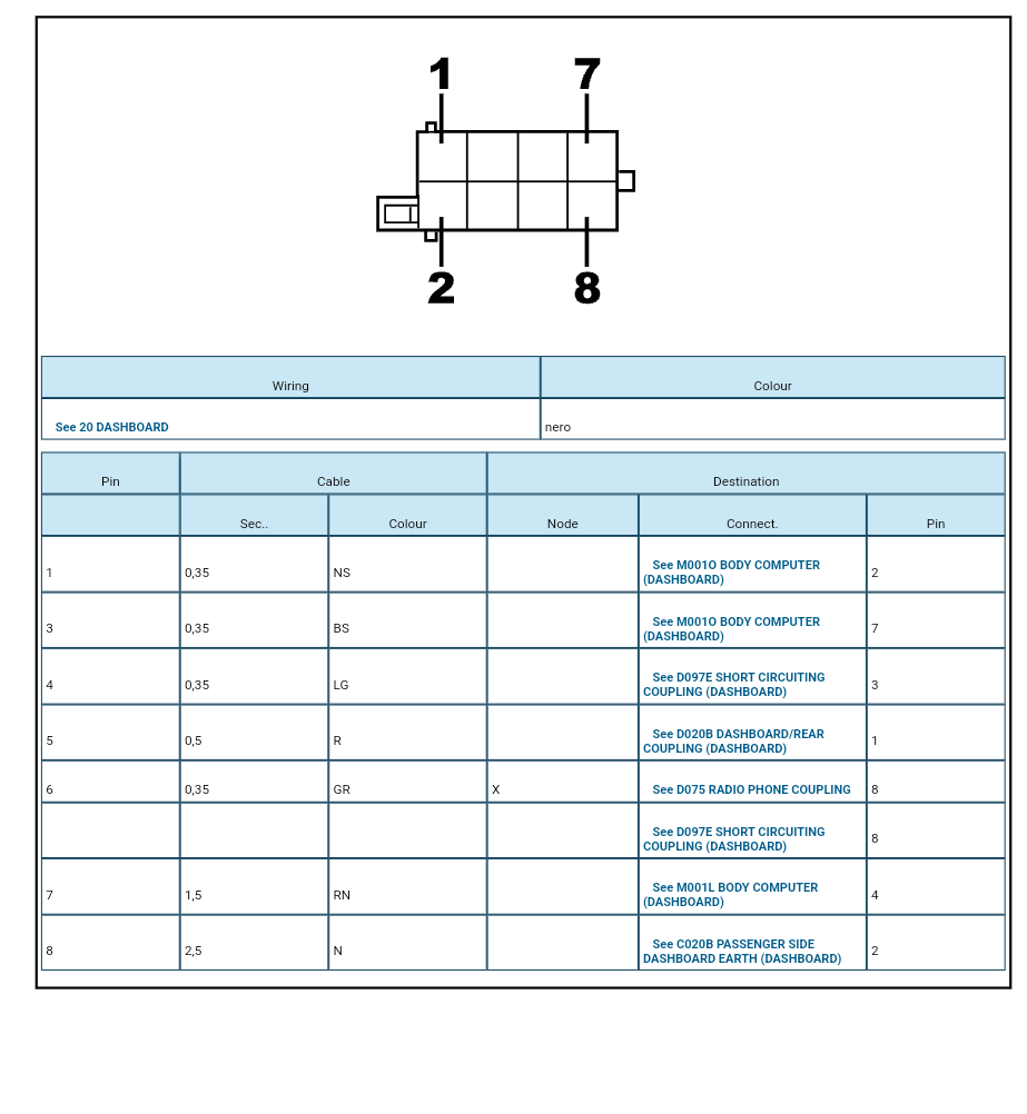

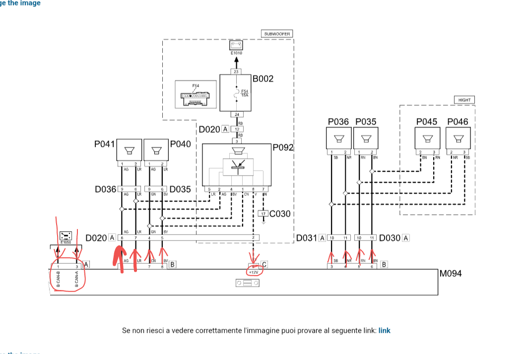

The basic model cars only have 3 input wires 1 supplying the permanent power, and two network wires, that control the on, off, screen, speed dependent volume and so on,

It was a harness that came with the Device, it was labelled 'ISO Connector B'
The cables are the same as this poster:
Most cars with the standard radio are wired like this
Just pin 1,3 to control everything
As everything is controlled by signals from the body computer it would be hard to change anything
Higher end radios (rare) used pin 6 for the light detection
I thought this only applied to cars with subwoofer and/or steering controls, is yours a later euro 5 car
Probably yellow and red
From here I can not tell how yours was original wired
