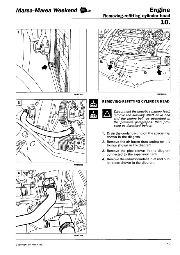

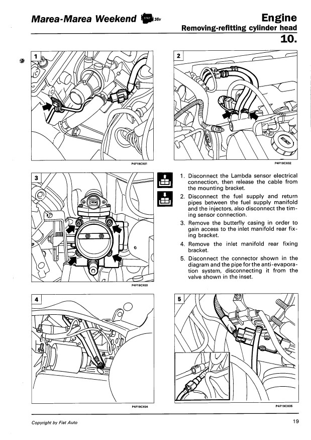

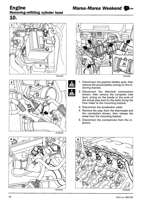

Here's the pages from the Fiat Marea workshop manual dealing with head gasket replacement on the 1.8 16v engine.
Dave.
