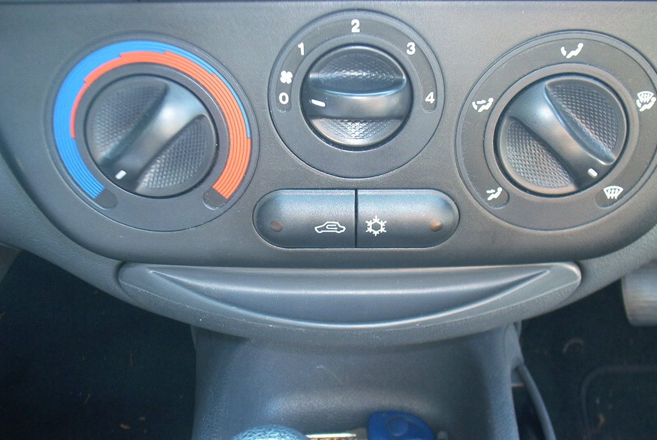

Im not sure weather my car has got aircon. i need to get a new alternator and i think they differ to weather you have air con or not. In side the car i have these controls ;

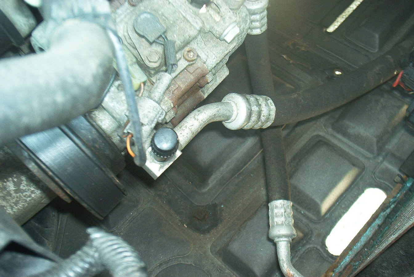

under the bonnet there is this which i think might have something todo with it;

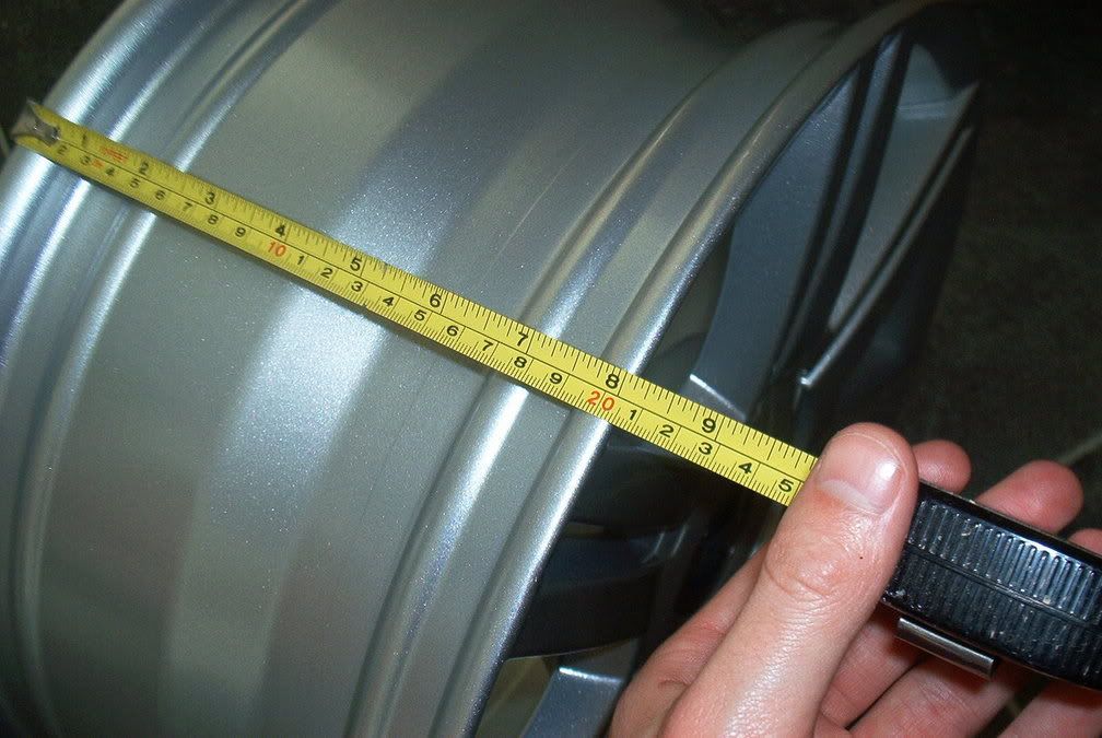

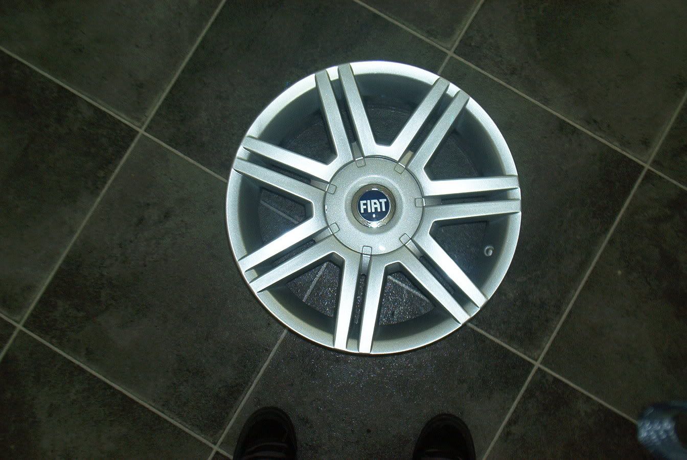

Ive recently got some stilo alloys of ebay. they are 16" but apart from that i dont know what size tyres will fit them. i seem to remember people syaing that you cant get tyres wider than 7" that will fit the arches correctly. as you can see from the pic the actuall alloy is 8" wide! ..
And heres a nice pic just to show them off :p

You have aircon, but dont have climate control...
The picture is of your aicon compressor.
As for the alloys, firstly you need to measure from the inside of the lip.
Most likely they will be 7" wide, at worst 7.5", either way they will fit quite easily... ;)
Have a look on the inside of the wheel, you should have a stamp thats something like 7J16.
Oh btw, nice choice of wheel, they will look good :)

Dan has them wheels on his 1.2 they fit fine all you need now are some tyres 205/40/17 and some alloy wheel bolts you will already have them if your car is a hlx or hgt if not you can order them from fiat
if you want a pic of what an aloy wheel bolt looks like so you can check just say and i will post one.

ive got a hlx so bolts are no problem.
and in all honesty i didnt know i had aircon. no documentation i got with the car said i had it and the button on the dash with the snowflake on does nothing (im guessing aircon needs recharging) and i also thought bravo's that had aircon didnt have a sunroof.
