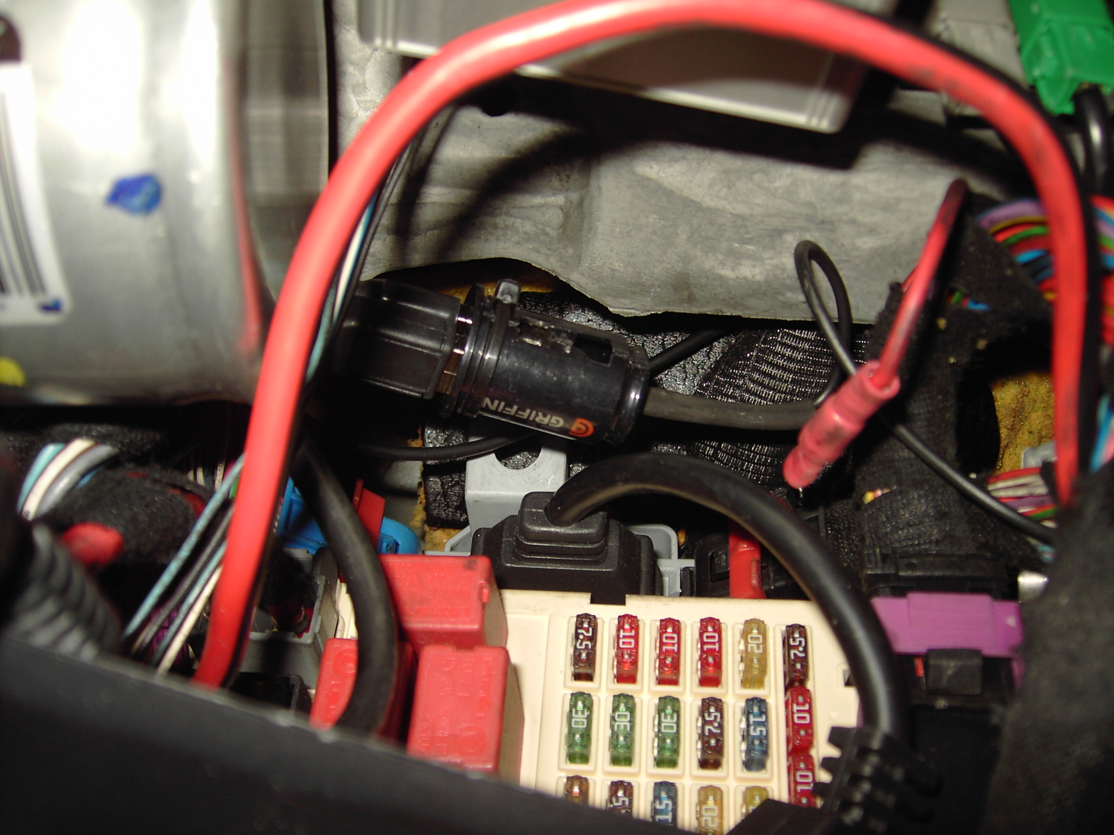

I used fuse F51 in the dashboard fuse box for mine. It's an ignition switched supply for the tyre pressure monitoring system. Never seen or heard of any Stilos with that option fitted.
I connected a double USB socket to the fuse so it can power a dash camera and sat-nav without having to cut the USB plugs off.

cheers mate that's brilliant.
i'm thinking of using a piggy back fuse holder would that be ok?

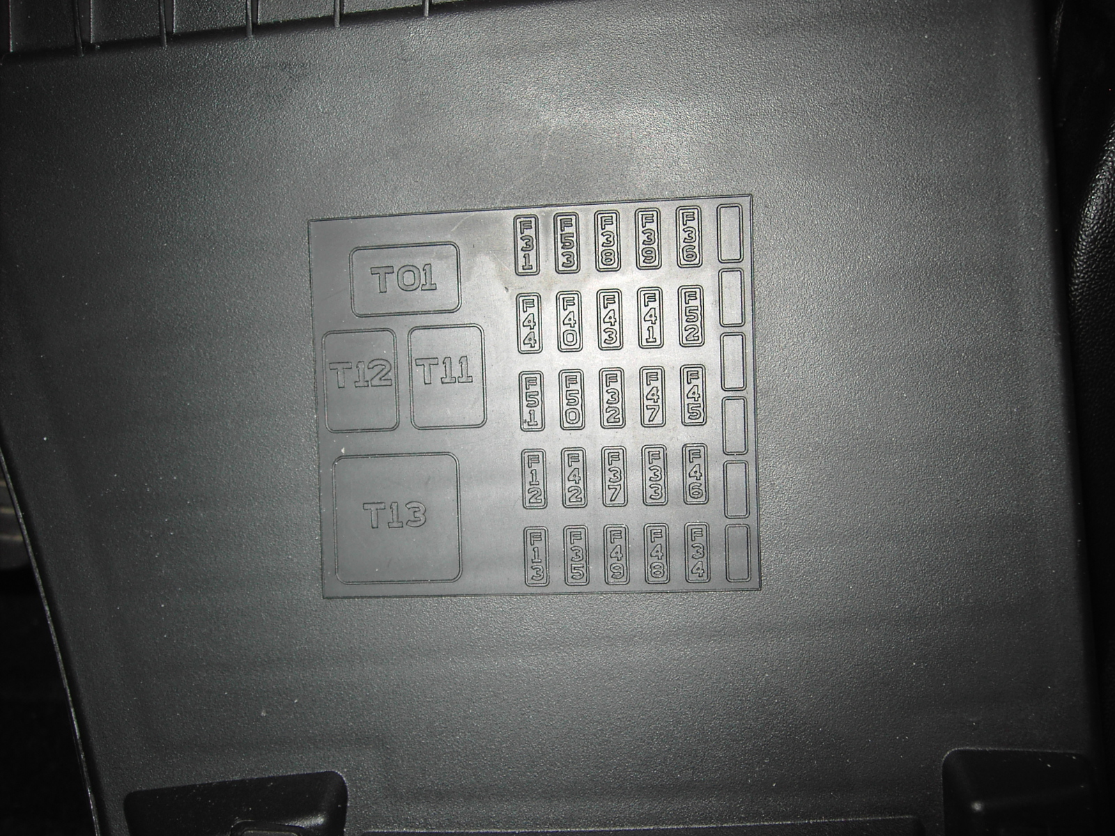

My book says F51 is for the "Powered door mirrors control (movement, ideograph lighting)".
Seems as though fuse positions changed throughout the life of the Stilo. The 2002 handbook that came with my 2003 car says F51 is for the TPMS. Just looked at a 2006 handbook which says it's for door mirrors, as you say.
I only have 1 fuse slot that actually has the metal connector/fuse holder behind it. All the other empty slots are empty/unwired, so the fuse can't clip in to anything.
My fuse box is fully populated, including the 6 spare fuses in the right column. Those 6 positions are the only ones that don't have any contacts in them.
