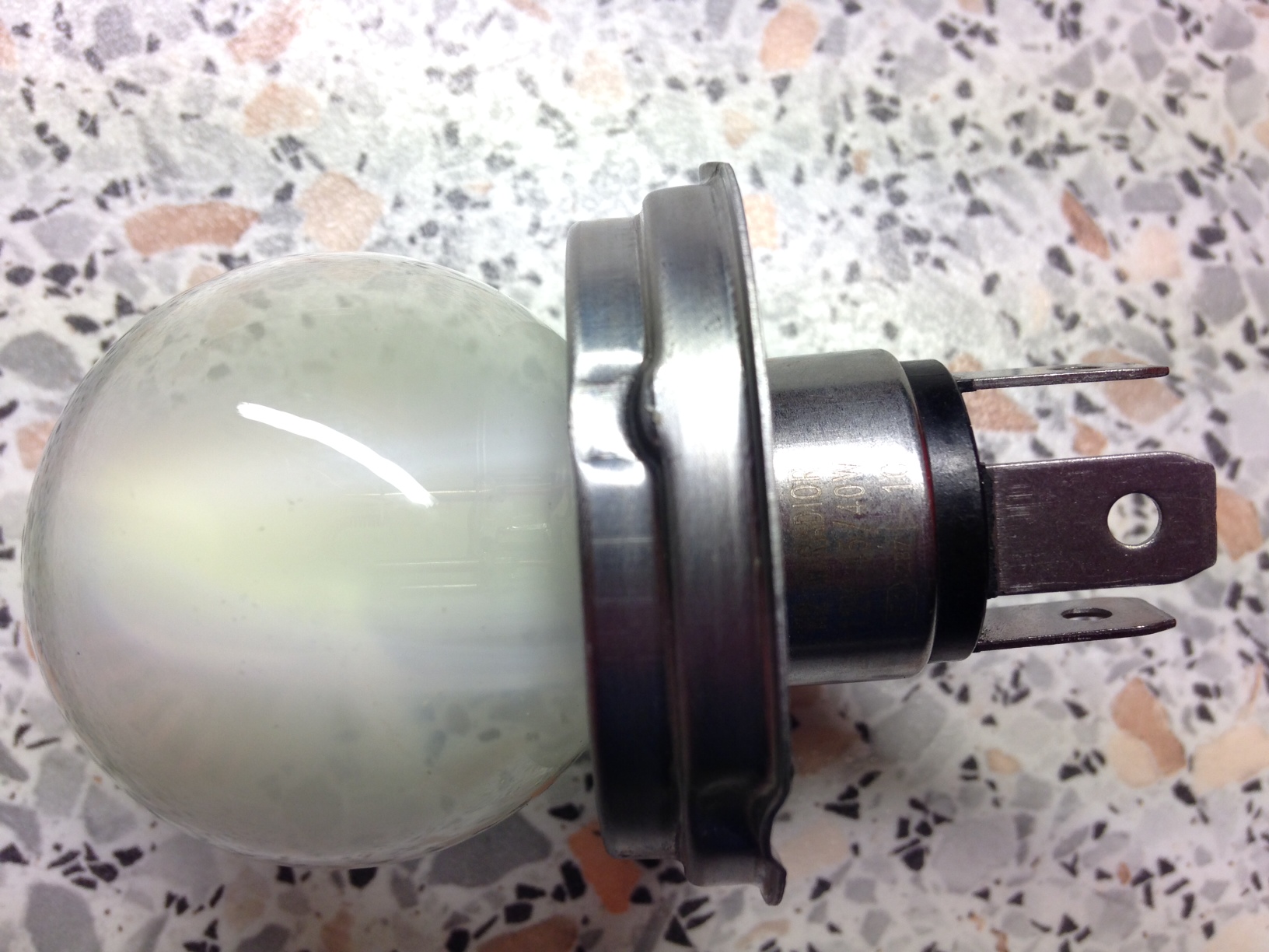

This is the bulb I am replacing, standard I am sure.

Such bulbs are readily available from Halfords and other car accessory outlets. The standard bulb is a 410, the replacement halogen one is a 2983. (Cars with standard halogen H4 bulbs use 472)
Whilst the halogen "conversion" bulb will give more light, there will be some stray light, as the filament is not in exactly the same place as in the 410 bulb. The light on the garage door is not a clean pattern, so you may get a lot of people flashing at you. Because of this, I don't think they are ever "E" marked, making them illegal to use. (Subject to getting caught, and the bulb being easily removed to check by the policeman) Consider carefully.

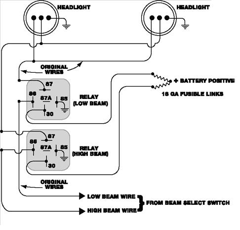

Here's a link with visuals of what Andrew and fiat500 are talking about. It's centered on installing horns versus headlights but the concept of what a relay does and how to wire them is very well written.
http://www.rattlebars.com/avalanche/relay_basics.html
With that knowledge, it'll be easier to make sense out of this more cryptic diagram below.
Also as they both say, install fuses on the new wire(s) you'll install between the battery and the relay. I've included a photo of how the wires running to my relays are attached to the battery terminal.

I guess why some people use four relays is because you have two redundant cables, from the column switch which still carry current when activated and therefore need safely terminating or removing.
I assume another benefit is that if a relay fails , you only lose one headlight not two.
