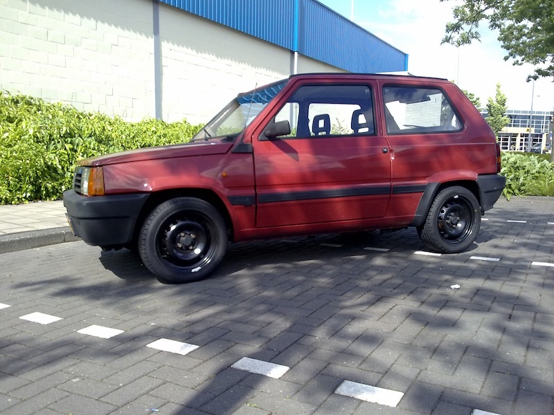

Yes, i had them on my 1100 Young, and the car drove great. ;)

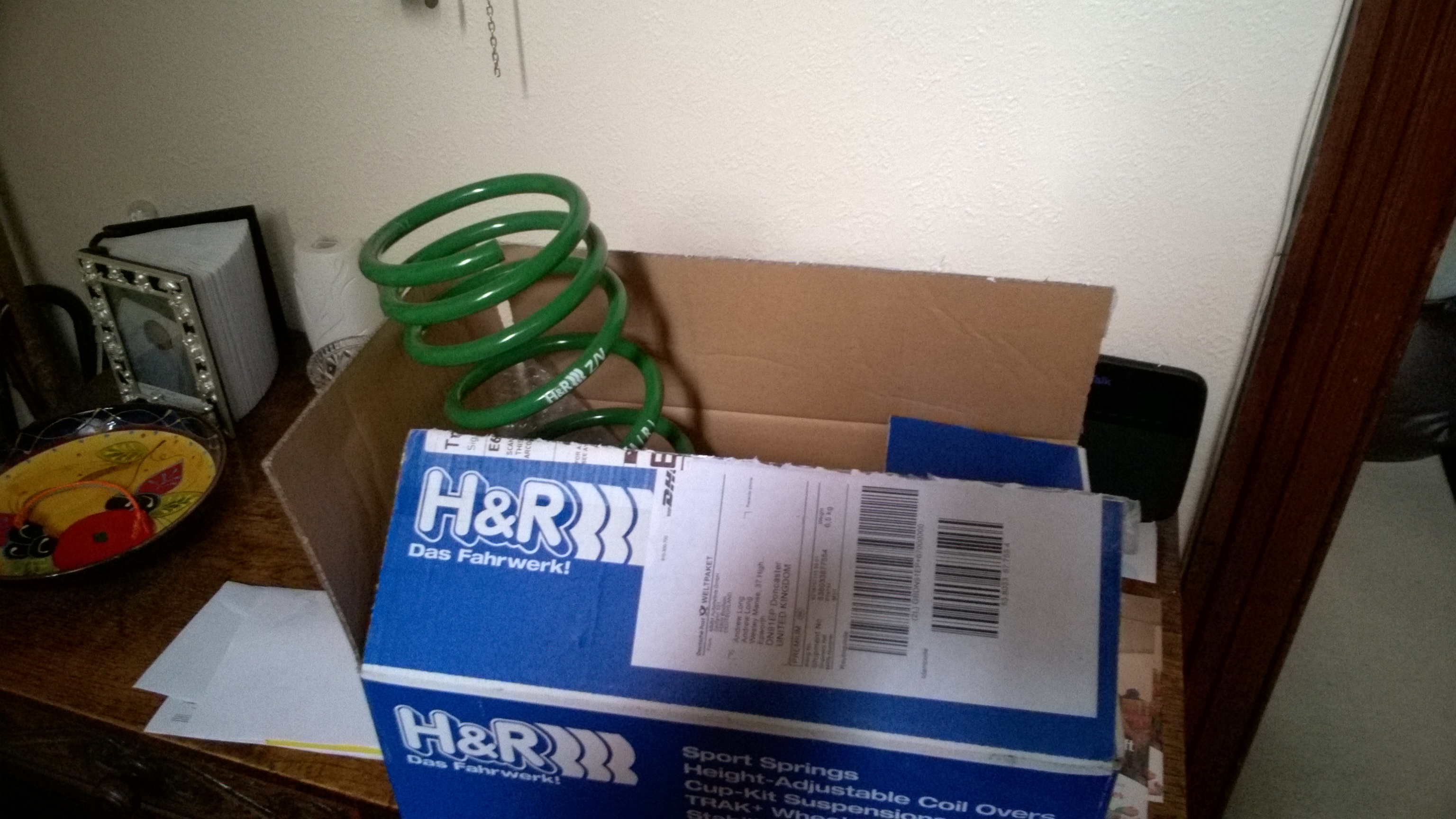

My other issue is I bought them for Rofus but they have turned up in a lovely Tacchini green rather than the blue on the pictures which would look great on Grumbleweed but which will totally clash with a turquoise Colour. (Yup, really that sad):eek:
just get them fitted to something! :p paint them if you have to! (y)
