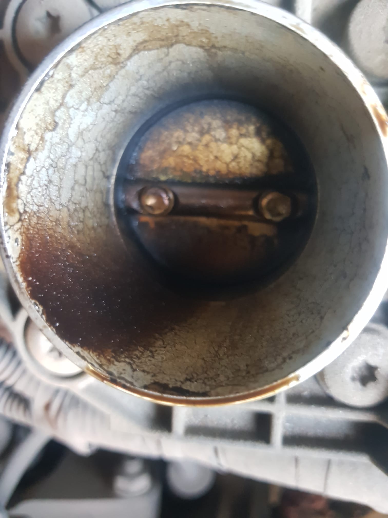

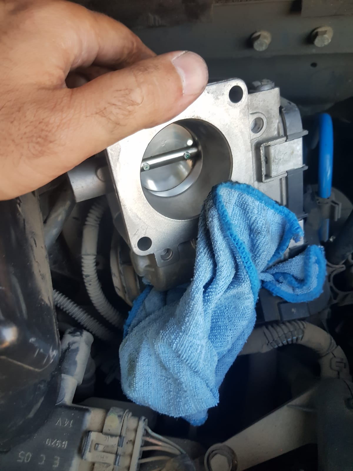

So I would like to update this thread.
Total new to this BTW.
I did a Throttle Body clean yesterday (in a very armature way) and the shaking TOTALLY GONE!!!
I was blown away this morning when driving the car.
PS - I was quite worried because I did a rookie mistake and when cleaning the dust I did manage to get some of it into the hole post-throttle body (which I assume next is the engine itself - it's the head, right? it goes to the valves area)? So i was worried and did my best to try and absorb most of it but I am assuming I didn't get all. So I thought the engine might explode when I fire it up :)
BEFORE
