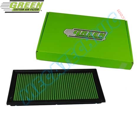

So I got this fitted today, and it's loads better than normal one. The engine pulls better and revs freely. Definitely worth the £37 off eBay.

Cool - I hope you enjoy it!
Just a word of caution with aftermarket / high flow air filters - be careful as a lot of them come quite heavily oiled (K&N, BMC and alike) and that oil can very quickly and easily contaminate the MAF meter and kill it good and proper.
I dont know whether this particular brand come oiled or not though.
